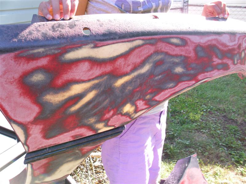

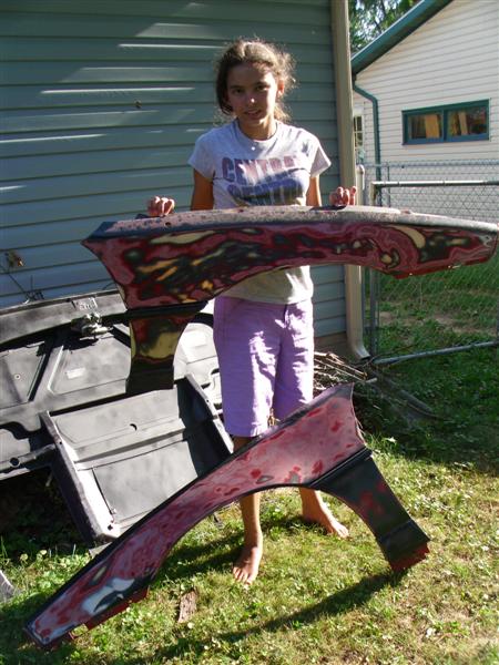

So here is some of the sanding work
.JPG)
and a close up of where i have gotten so far

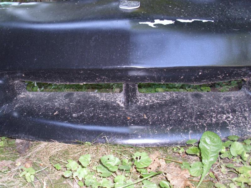

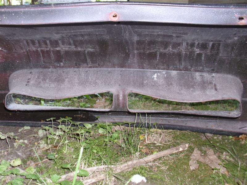

And here is my nose which needs sanded next....but the openings look a bit droopy, any ideas on how to fix them?

The only idea that comes to mind would be to reinforce the inside area around the "droopy" with some 1/8" SS flat stock; either bond or rivit it to prevent it from sagging...

You might try to heat those areas with a hair dryer then put a block of wood or other material in the hole then let it cool down. You may have to do this several times to get some results. I did that to a used nose clip and it fixed it, you will just have to see. Like the job you are doing with the car, good luck with your paint! ------------------ 1984 Indy Pace Car\1988 Formula Custom President of Maryland Fiero Owners Club MFOC NYFOC Member
JUL 30, 07:15 AM
My 85 had the droop so I put some round spacers. Just drilled two holes and used the right size tube on the inside and snugged up the bolt. Painted black they didn't look bad at all.
Or you could just cut the drooping part out and make it a wide mouth
