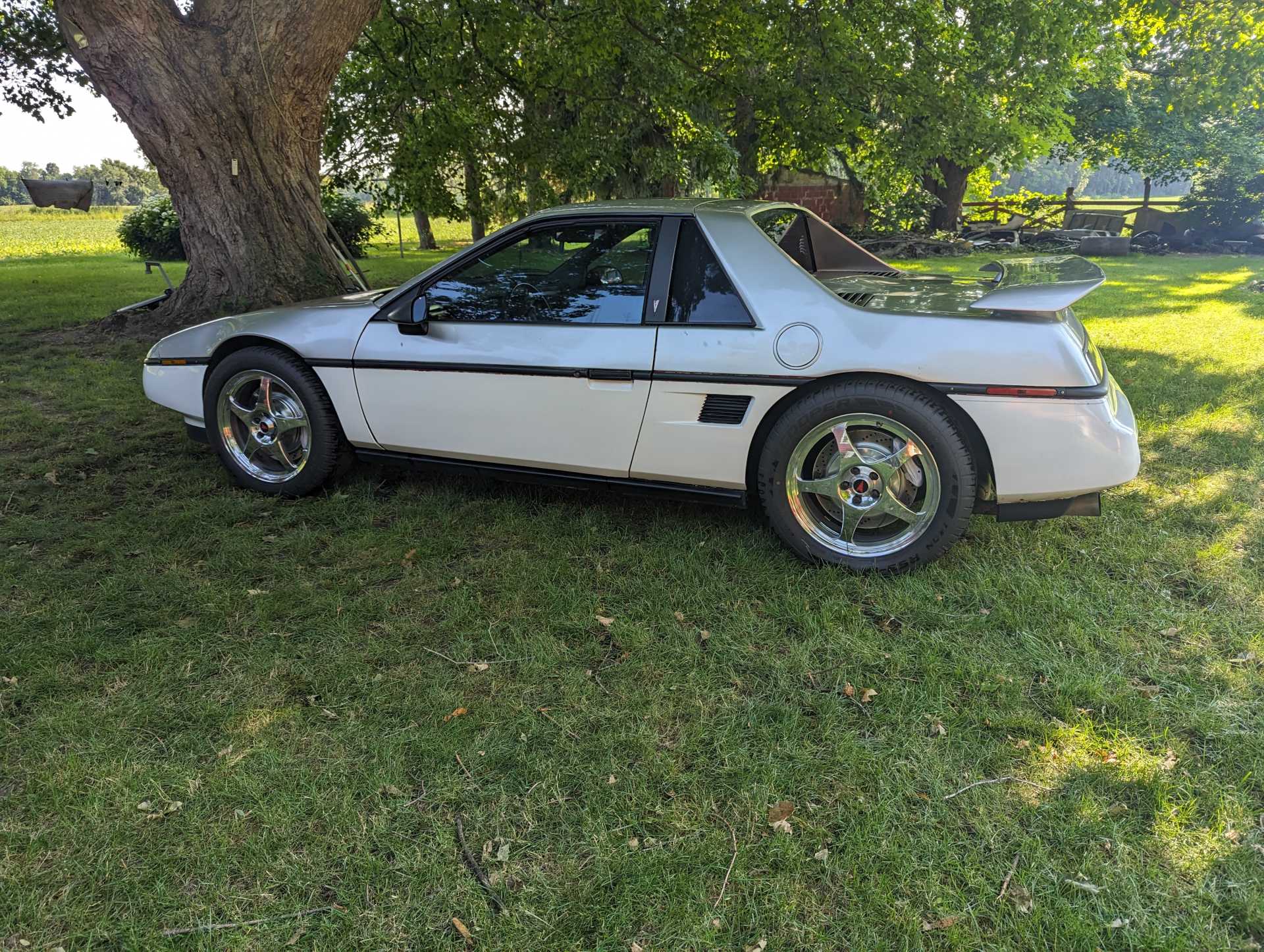

I'm running 17x7 on all four corners, 215-50-17 front and 235-50-17 rear.
And I have to ask is your car lowered ?

This is my setup: 235/40/17 (24.4") in front and 285/30/18 (24.7") in the rear. It is lowered about 1 to 1.5 inches with 3x the power of a 2.8 (when it was naturally aspirated, it is even more now with the turbo)
