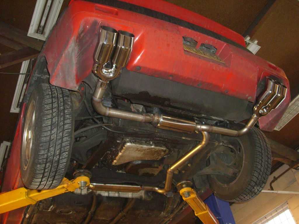

The OEM Fiero exhaust is made of stainless steel.

I have checked a few exhaust shops, one even made one for a Fiero once. Total cost was well over $1,000...

Hi Cliff, I do understand the frustration of having an American car in Europe! Living in France, the parts cost an arm and a leg to have imported. In general I budget X2 the parts cost to cover shipping, taxes and import dues. If you like we could see together for the next RockAuto order? It may reduce our import costs a bit and we could redistribute the parts to each other with Mondial Relay. For the exhaust system, if you could get the component parts (bends, silencers etc...), I would happily TIG weld them all up for you free of charge. However, it would mean driving to the North West of France. Like you, I don't have a huge amount of space, but I do have a small 1 car garage and enough space in front to store 1 extra car on my land. (Not on the road - same problem here with having a non functional uncertified car on public roads.)

I would think for the exhaust the most expensive parts would be the tips and the mounting brackets. The tubing, cat, and muffler should be pretty universal

That's a very nice offer! I don't think we will save on shipping if it's first shipped to either one of us, then shipped to the other. As you know, shipping within Europe is rediculously expensive too... 😕 But I dunno, will have to check that. Maybe it turns out to be a lot cheaper!

I already have the tips (since I want to keep the stock ones) and I think I also have the mounting brackets...

As Pk said, (Hi PK!), exhaust parts are cheap, it’s the welding that’s the tricky bit. Takes a bit of skill to weld stainless properly. A lot of it can be done off the car though. A new system for my BMW Z3 is going to cost me £250 but £90 of that is the front pipe I bought, the rest is the Cat and two boxes. I’d do it for you too, but Scotland is a fair old trip, and we’re £1.88 a Litre. I’m currently sorting through all the stuff I’ve accumulated over the years, I know there’s Fiero stuff that I’ll never use, like a pair of rear calipers that need seals, which I have. Somewhere. Welcome to them.

Now to Cliff's issues, is the exhaust too far gone to patch up before you find a better/cheaper solution? For APK it only needs to be leakfree. Although SS exhaust parts are not very expensive they can easily add up to a few hundred euros. Cheapest is to collect them yourself. Then my best bet would be to find an enthousiast/hobbiest who has his own project car, can weld and is willing to help out. Even then I guess you might go over the 500eu mark.

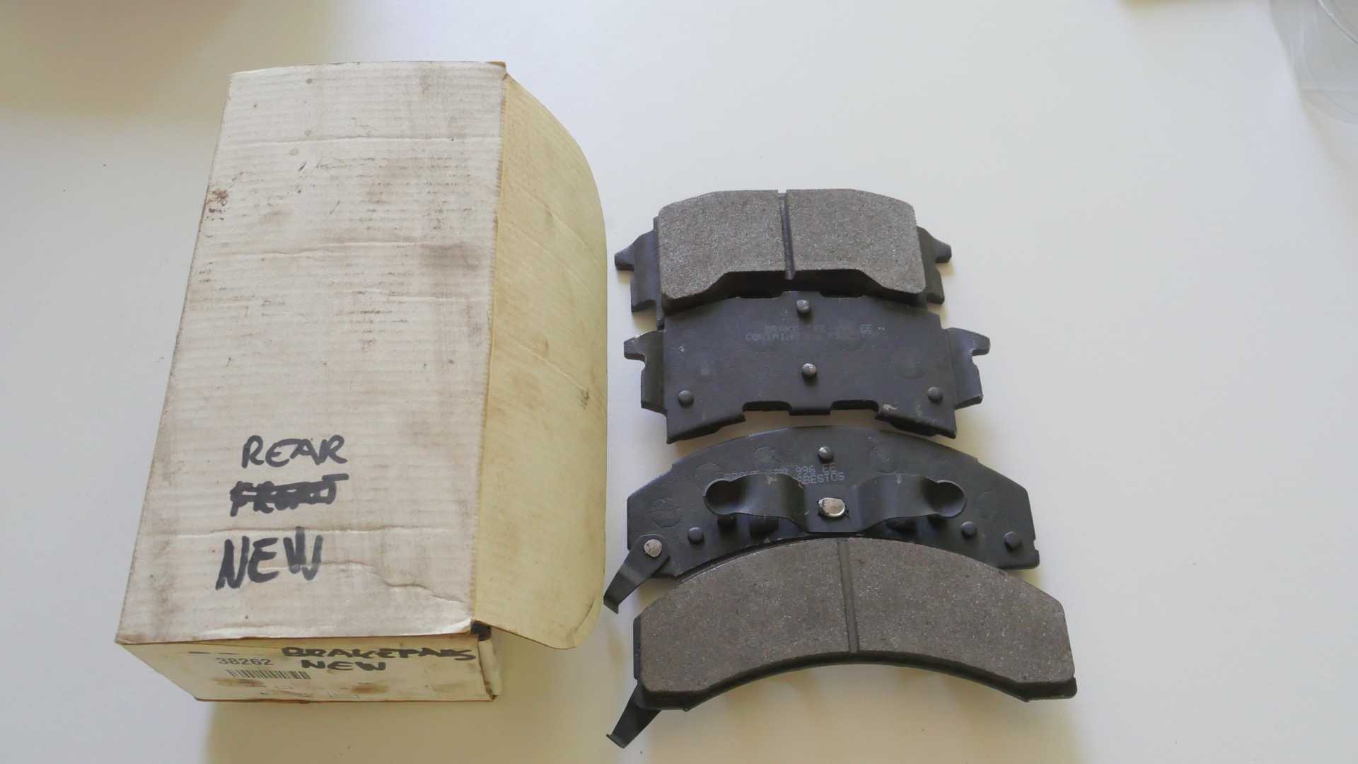

As for brakepads, I still have a new set for the rears !
 I compared them to some used ones to be sure and they are the same, even some of the used ones have little wear and still usuable if needed. You can have them.
