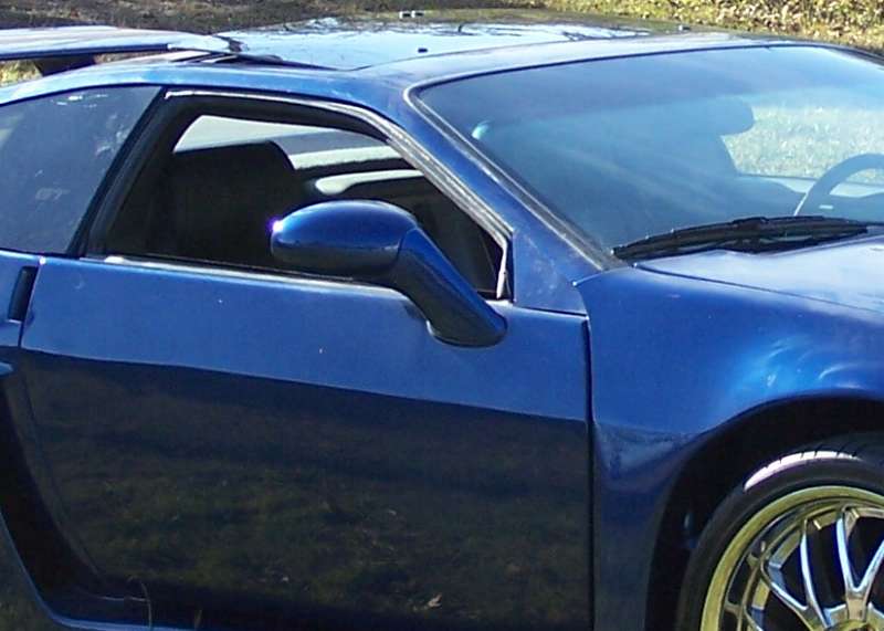

AWautoworks DEC 06, 04:27 PM
Originally posted by qwikgta:
mine are off a 90-00 Chevrolet Lumina. Had to create a mount on the door to cover the triangle corner of the "A" pillar
Why cant we get ahead? GRRRR we were exploring alternative options on the wide body I am building. We were looking at options to mount our mirrors on the Door pillar like that but now we are in a dilemma. I promise we aren't trying to copy you on anything but I guess we have the same tastes.

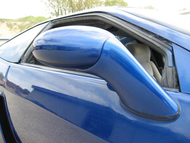

hnthomps DEC 06, 07:48 PM
I will be using powered F430 mirrors on one of my Meras. Is a F430 sexy enough to qualify? BTW, I do have a spare set of Vitaloni power mirrors and they may be sexier than the stock mirrors.

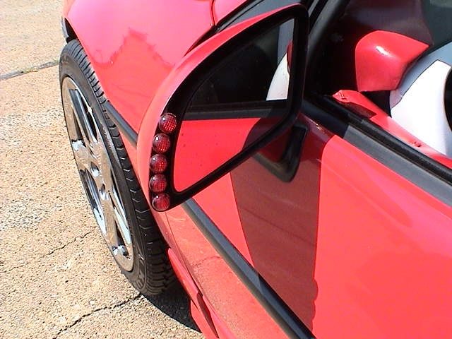

jscott1 DEC 10, 11:23 PM
The 3rd Gen Corvette will almost bolt up but they will hang at the wrong angle. They are not much better anyway except that they are painted and have heat.
People will argue endlessly on this point, but they will not bolt up at the correct angle. I know I tried it.
I added lights to mine as well.
I also on another car used the 96 Oldsmobile Aurora, which do not bolt up at the right angle either but the attachment point can be easily modified.
