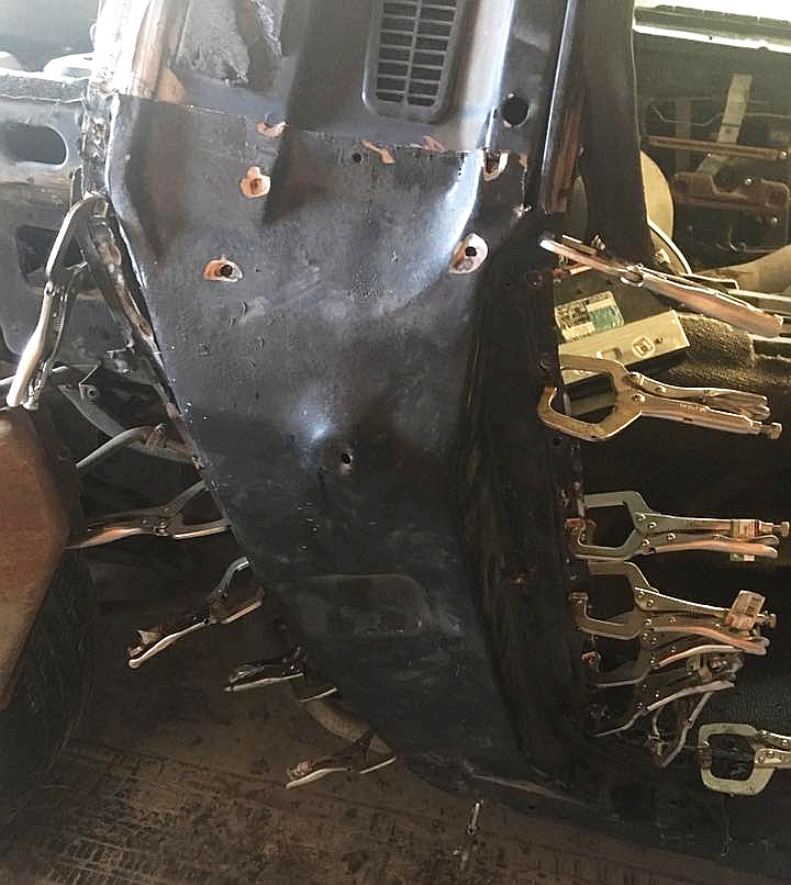

Originally posted by AWautoworks:
Being a body guy I have a stash of visegrips as you can see...
I tweaked it a bit, but I thought that was such a unique photo of all those vicegrips.
I've been doing mechanical work on my own cars for 45 years, but never body work. It's a voodoo science I never learned.. but I love seeing what other people are able to accomplish. You do fine work!
