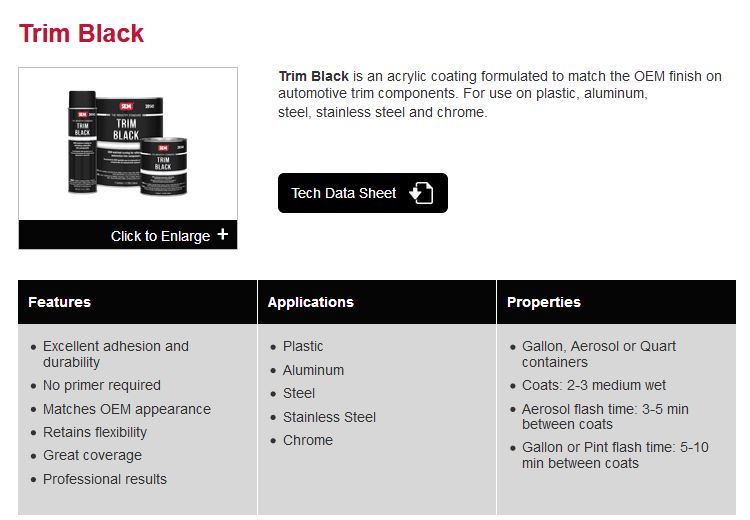

fierosound MAY 06, 09:44 AM
Website: https://www.semproducts.com...im-paints/trim-black
