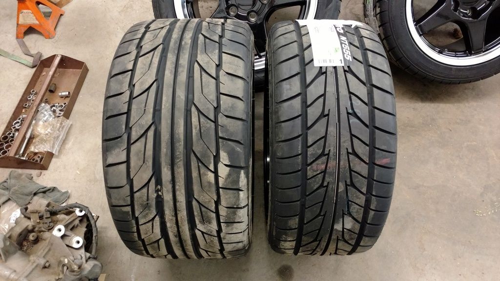

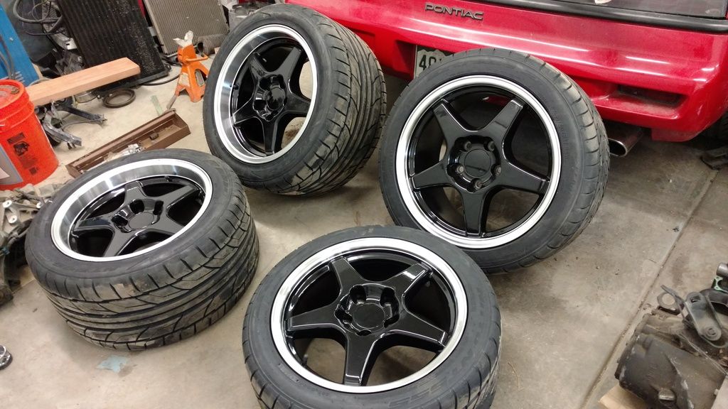

Tires and wheels are mounted.
While I would have liked more positive offset, I would have had to spend several times what I did for these wheels, I can live with having to make some spacers to get the track width I need.
Joe
