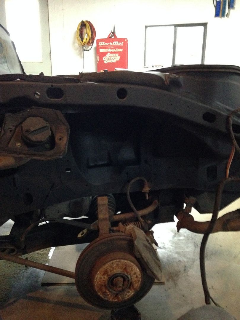

Getting the suspension back together further
Any words of advice here?
3 washers on the inside on both sides of the control arm, still have 2 more left if needed but they won't fit.
Both of the large washers have the cupped side facing in, like the originals.
Obviously I will have an alignment done once the motor swap is done.

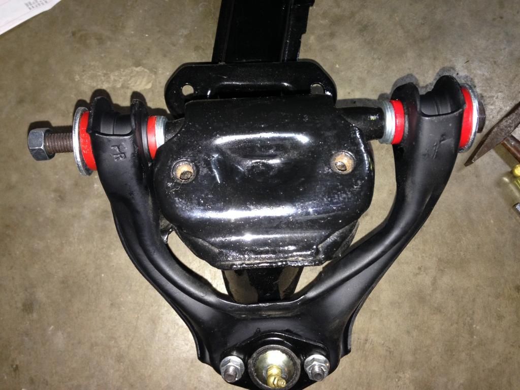

DKcustoms FEB 16, 04:28 PM
Been a while since I posted, with work and weather getting in the way.
But to keep this thread from getting archived, I have been gathering parts and made some progress on the rest of the front suspension.
It has been below 0* here for a few days now, really can't wait for spring at this point.
Once everything starts melting, the Fiero will be moved out of the shed into the garage so I can disassemble the rest of the front suspension and finish what I have here.
need to grab the spindle/caliper/caliper bracket off the car so I can get the driver's side assembled here. Then take out the old frame crossmember, clean up and paint the area a bit, and then install this one.

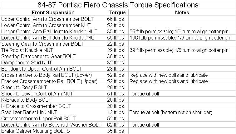

DKcustoms FEB 16, 04:39 PM
This post is more of a placesaver and a triple reminder to myself to make sure the front suspension gets torqued down when/after it gets installed.
These charts are great, and I found them somewhere on the forum, figured I'd share them with everyone who may not have seen them before.
