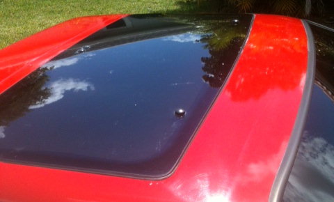

Replaced the hardware on the sunroof glass, was missing the in & outside gaskets. Now it doesn't leak during the frequent afternoon thunder showers.

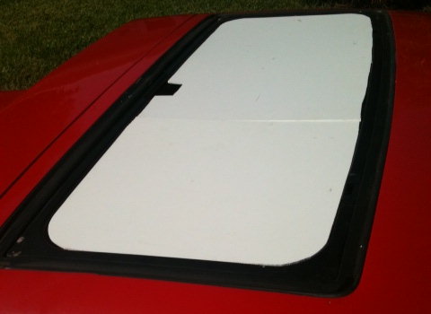

Due to the intence sun here in Florida, I made a sunshield out of some 1/4" plastic sheets I had laying around. Had to made it in two sections, as the stock was only so wide. I put some thin weather stripping down on the body of the sunroof to take care of any noise the plastic made w/out it.
It does the trick, with the glass in place , You can not see the white.

Does this cut down on some of the wind noise as well? I have a sheet of coroplast (corrugated plastic) that is about 5X8 FEET, plenty to make a sunshade from. Amazing what you can find during an election year.

Can't say it does help with wind noise, as my sunroof was fairly quite to start with. It does help with the inside temp, I could feel a big differance in the cooling ability of the A/C. Next sunny day, feel how hot the inside glass is with your hand. I do have the factory sunroof pad, but it's not in the best shape, this was a short term fix until I get another one.
