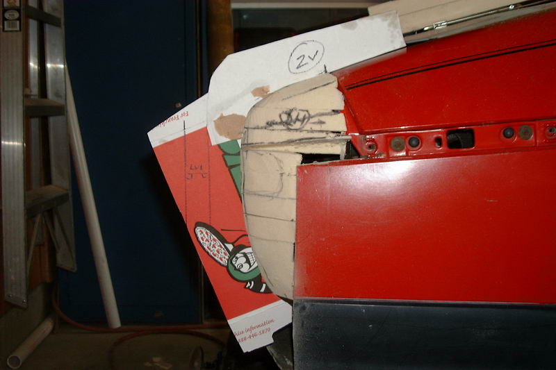

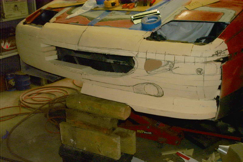

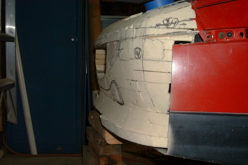

Small update on the fascia.
Continued shaping. Made some profile gauges so I can match the sides. Un fortuneately I don't have a lot of room to manuveur, so it's kind of a PITA to work on.
Here are some pics:

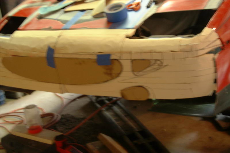

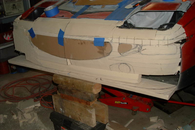

A little blurry, but taking shape. You can see how I'm thinking the aux vents will be placed.
Filling in the extra space with the air dam and splitters - just temporary to get an idea how it will look.

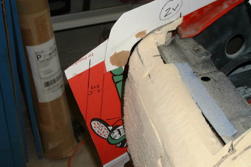

Profile gauge on one side:
Versus the other side. This side still needed about a 1/2" taken off the bottom

Jake_Dragon JUN 18, 06:59 PM
Very nice, what do you have in mind for the rest of the car? I have never liked the flat sides of the Fiero. I like curves.

RCR JUN 18, 10:20 PM

Tony, Now you know the secret of great ideas...Jet's 10 (minus olives-yuck) and BBQ chicken pizzas. What can't be seen is that the cardboard mock-ups for the lights is made from Little Cesars boxes, too.

Looks a lot more like something now, but the pics are still on the camera. Tomorrow morning, I'm headed to the local salvage yard to see if I can pick up the turn signals and driving lights. Then I should be able to finalize the shape. -yeah!!

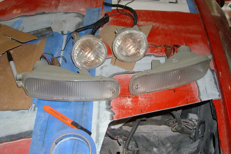

Couple quick pics for today...
The lights. Turn signals of a Nissan Altima and fog lamps off a Sunfire.
And some WIP pics.
Bob
