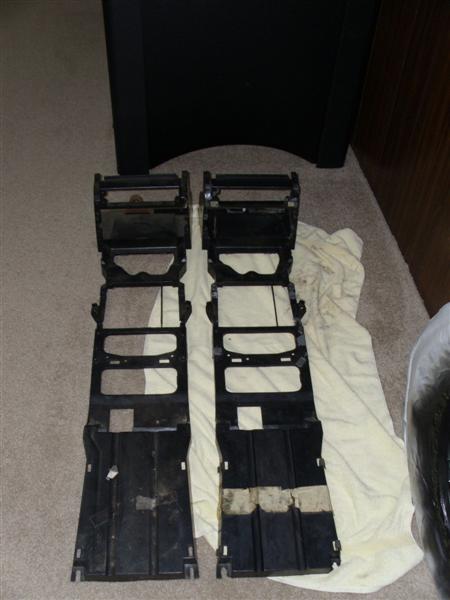

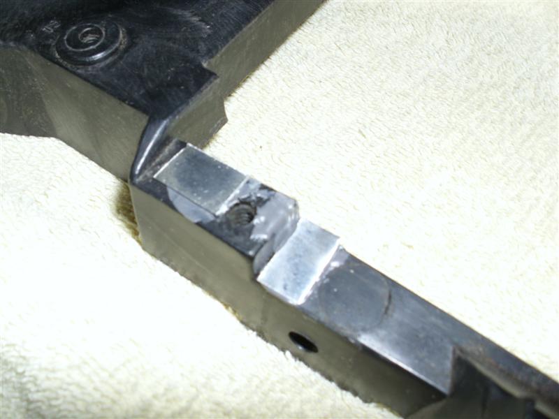

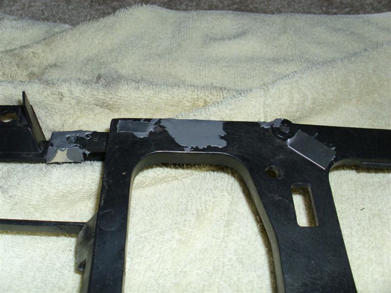

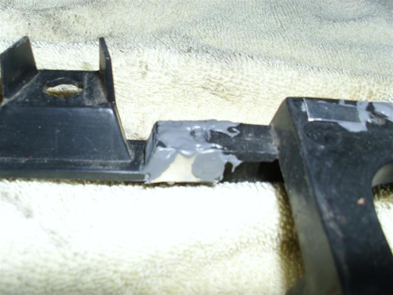

We have had no success finding a perfect console skeleton. We have found a couple that are better than others, but nothing that is mint. So it appears that the only viable way of fixing this is to try to mend the one(s) that we have. So here is an attempt. We used some epoxy and aluminum to mend the places wear there were cracks etc. We will still need to do some more work to fill in where a few of the screw holes are just absolutely messed up and then redrill those sections. Here is where we are so far.
.JPG)
.JPG)
_1.JPG)
.JPG)

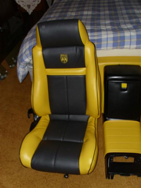

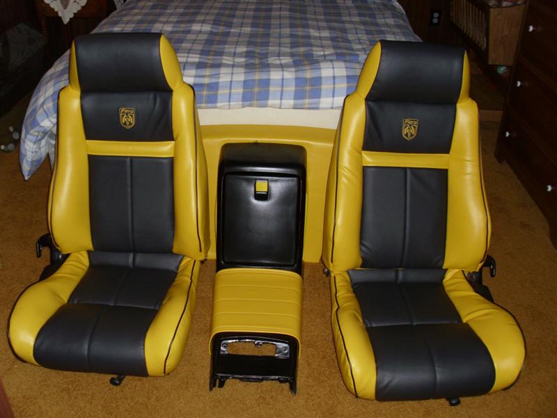

Kathryn also finished her seats and reinstalled the seat tracks beneath them so they are now ready to be reinstalled in the car. We just have a while to go before that happens, soooo for now they will get wrapped up in plastic and stored in the house so that they don't get ruined. Here you can see them with her firewall and the center console between them. She wanted to see what they would look like in the car. You might remember the earlier picture when we had it mocked up before the new Mr Mikes covers were installed on the actual seats.
.JPG)
.JPG)

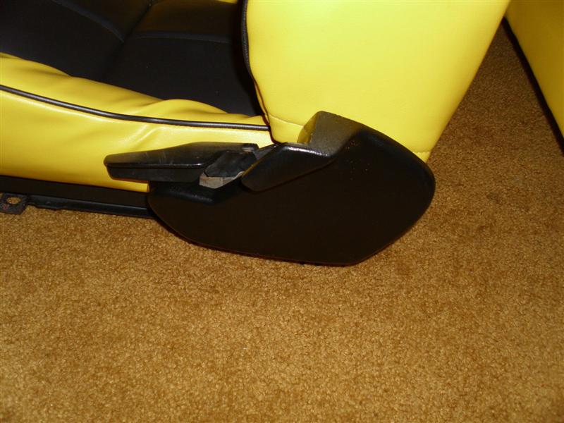

One of the things that we needed to fix was the plastic covers that go over the seat mechanisms. The tabs were broken and a couple of the screw mounts were also busted up. We used epoxy to rebuild those areas, sanded them down and cleaned them up, and then painted them black to match the rest of the interior. Finally, they too went back on the new seats.
.JPG)

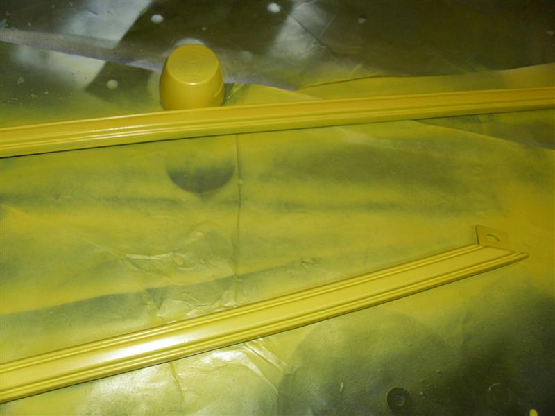

You may also remember photos of Kathryn carefully cleaning up the ribbed side rub strip trim. The previous owner had rattle canned this and never really prepped the surface so it was peeling off in flakes in some places and stuck tight in others. Kathryn attacked this with a putty knife, screwdrivers, and various grits of sandpaper. I think she hated me for making her get into all the small crevasses, nooks, and crannies, but she did and then it was cleaned up, wiped down, primed and painted. Here are the results.
.JPG)
.JPG)

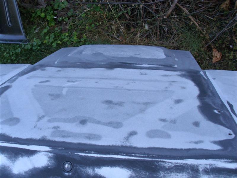

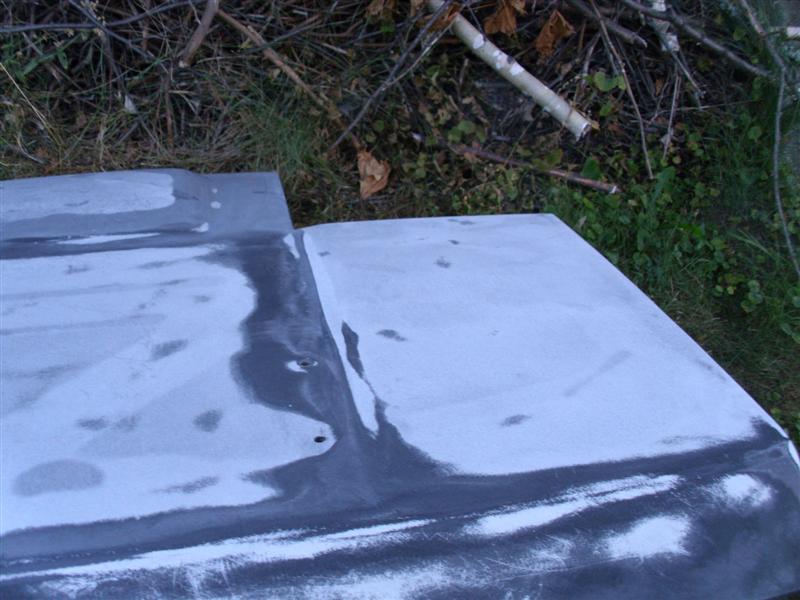

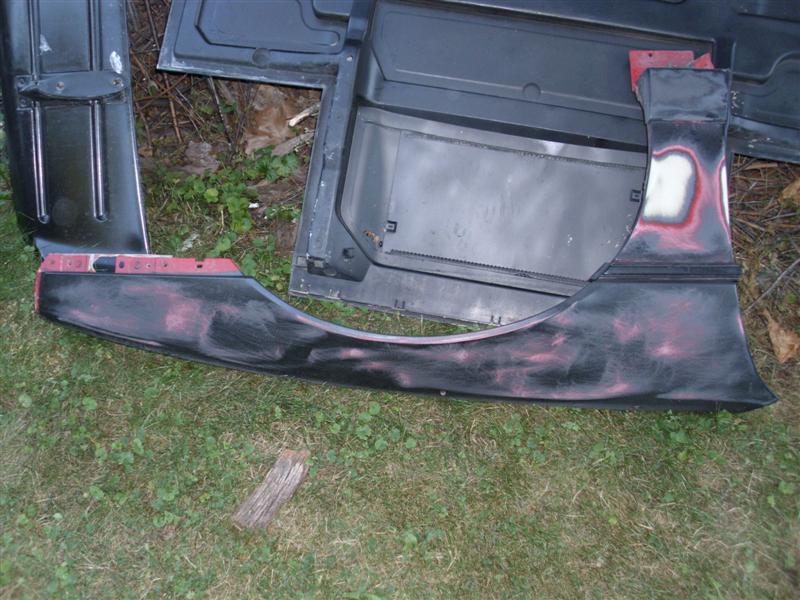

Finally, this post wouldn't be complete without some of the work on her favorite project.....SANDING! Here is what she finished up so far today.
.JPG)
.JPG)
.JPG)

A word of caution on the sanding - all you need to do is remove the non-adherant paint, etc. off of the surface. You don't need to (or want to) take it all the way to the 'yellow' body panel surface. Down to the flat black should be far enough, as that is the factory primer/paint system under the clear.
Whenever the base material is exposed, you run the risk of sanding a flat spot into the panel - and there are very few flat spots on a Fiero - it's all curves. Flat spots are durn near impossible to fill in with sandable primer, and if you get one, it WILL show up, especially on a black car.
Be sure to use a semi rigid sanding block to hold your sandpaper to avoid pressure grooves from your fingers, and do all sanding in an 'X' pattern running at 45 degrees to the axis of the car or the panel. For instance sand the hood from the left front to the right rear, and then fron the right front to the left rear. It will keep the sanding uniform and give better results.
You're doing a great job - keep up the good work.
