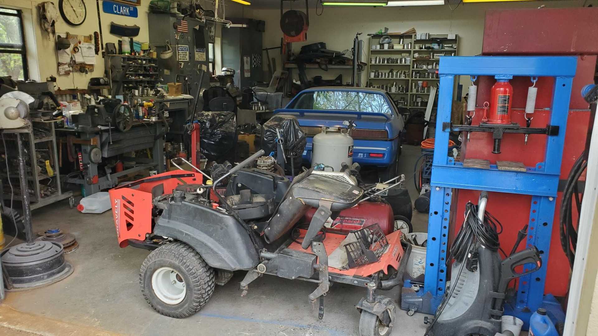

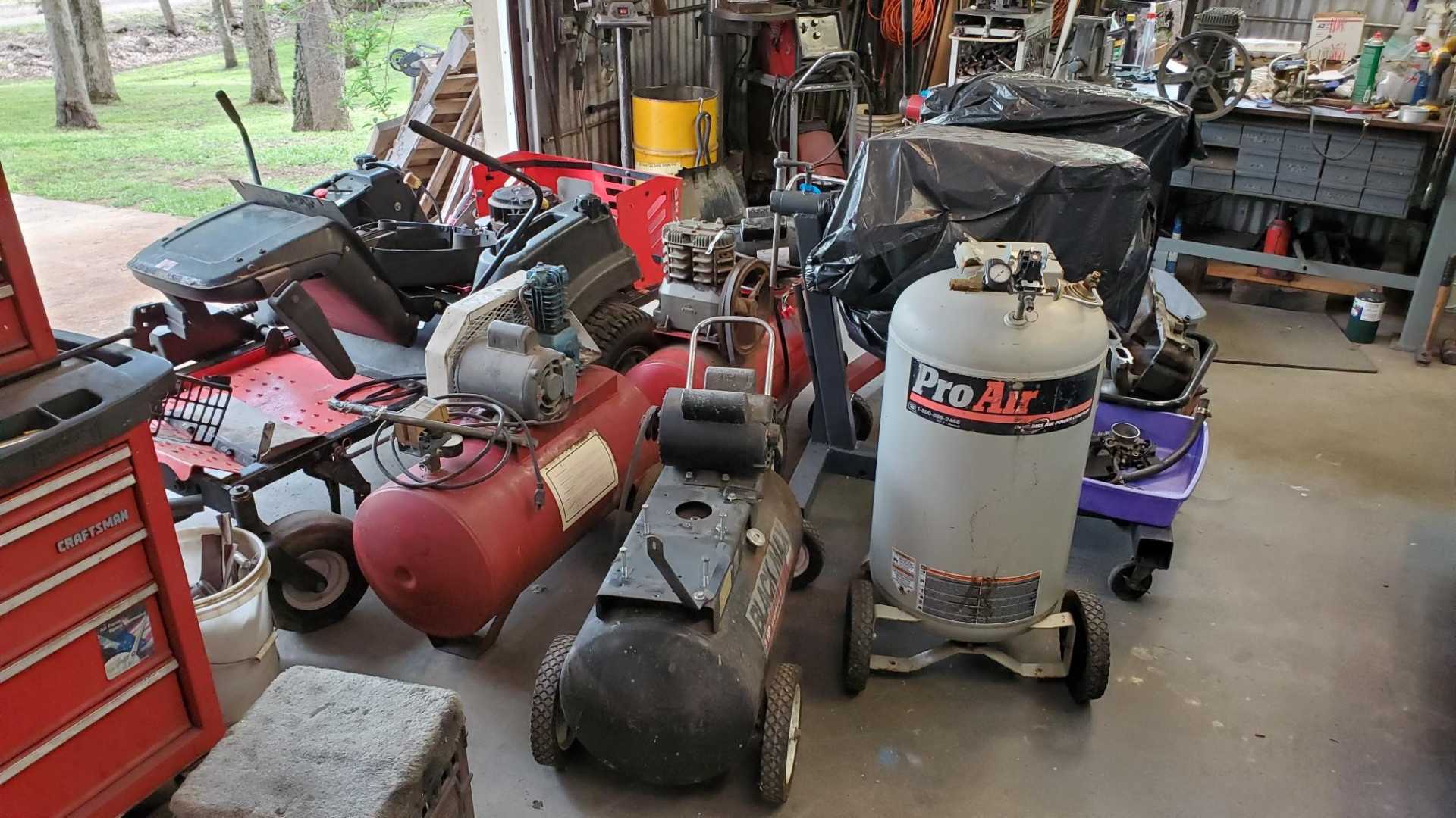

Haven't done any work on the car because I've been distracted by other projects. Trying to rehab my old Gravely mower instead of just storing it in my garage. Also working to replace another old air compressor. It's the compressor I keep at my house.
I had another old compressor I bought at an estate sale years ago and over the weekend bought two more "used" ones, hoping to be able to make one good compressor.
Hope to get back to rebuilding the Quad 4 in a week or two.

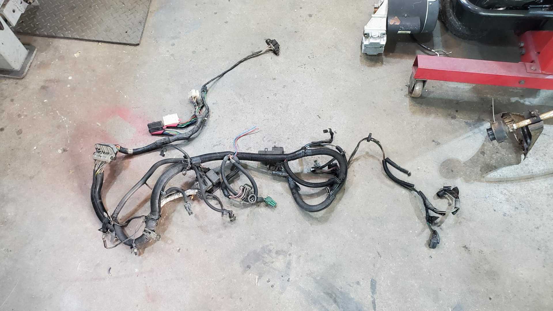

Quadfather SEP 13, 10:24 PM
Been working on other projects in the shop as well as a big one at work, so haven’t made much progress over the summer. It’s harder and harder to focus on the Fiero during the heat of the summer.

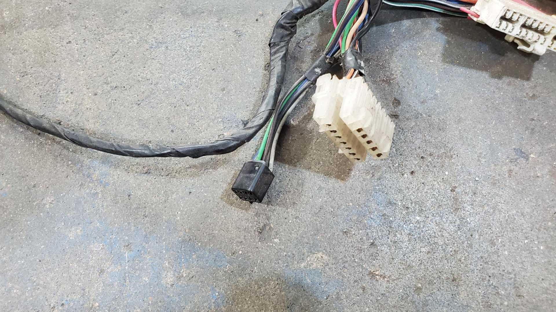

I did spend a couple of days looking for the Iron Duke engine harness. Finally found it on one of my spare parts bins right next to the car. Somehow the label had crinkled and wasn’t legible.
Finally realized that I need to mate the wires coming out of the Fiero plug to the Beretta engine harness, instead of mating the Beretta plug to the Fiero wires.
Still trying to face the music that I need to buy a new head. Maybe when the weather cools down.

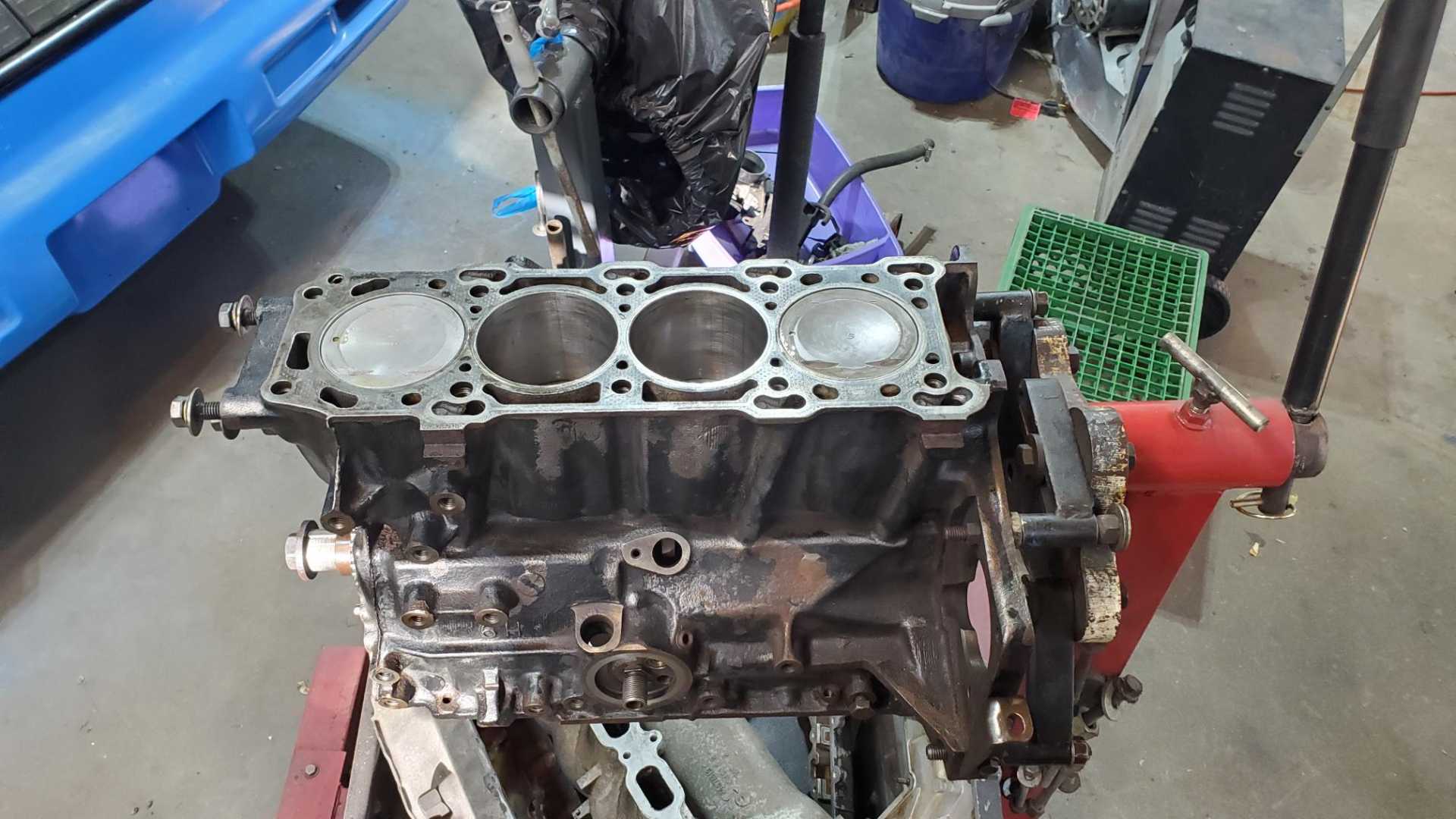

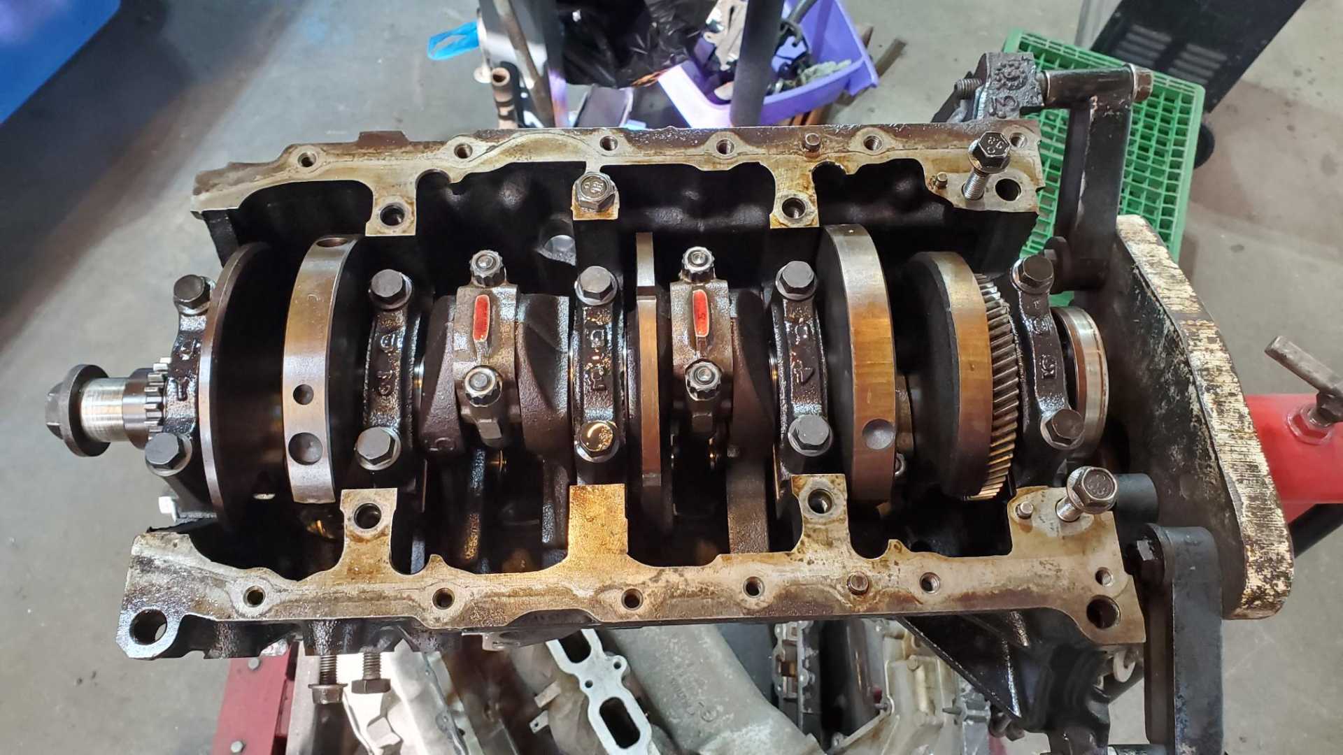

Today I began the process of replacing the head. Cylinder Head International said they don’t have any Quad 4/2.3 liter heads in stock, so I had to ship mine first. It’s interesting to me that the same head came from the same company in 2008 when I was first working on my GTZ. Naturally I couldn’t find the crack again.
While I wait I’m trying to resist the temptation to disassemble the pistons and rods to make sure I did them right.

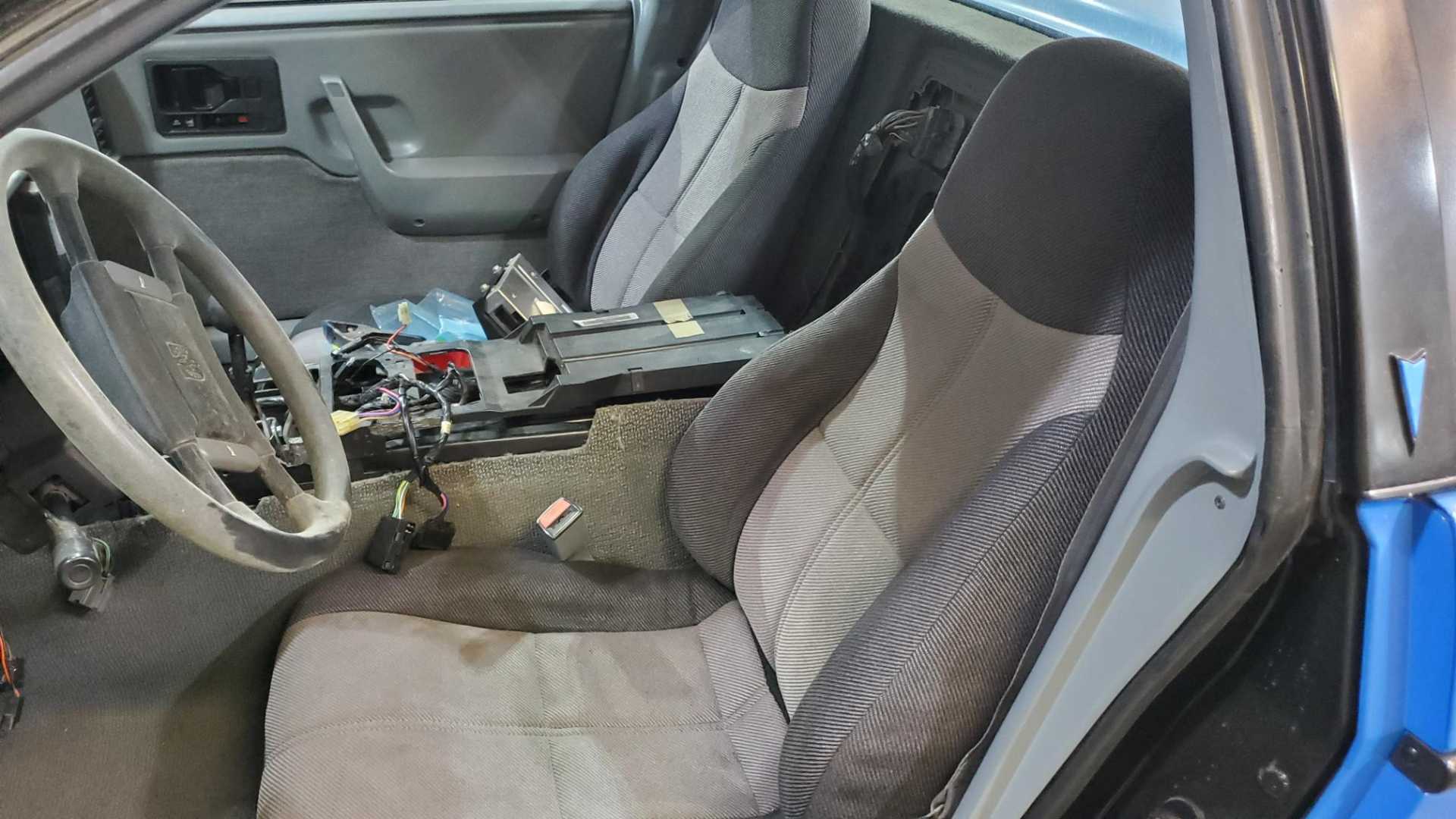

Over the last few months I’ve become convinced that I need to change my interior. I like the Camaro seats and the upholstery, but the texture and colors are wrong. I want this car to be full 80s shtick, so my seats need to be blue and black vinyl or leather.
That change will have to wait until the car is on the road.

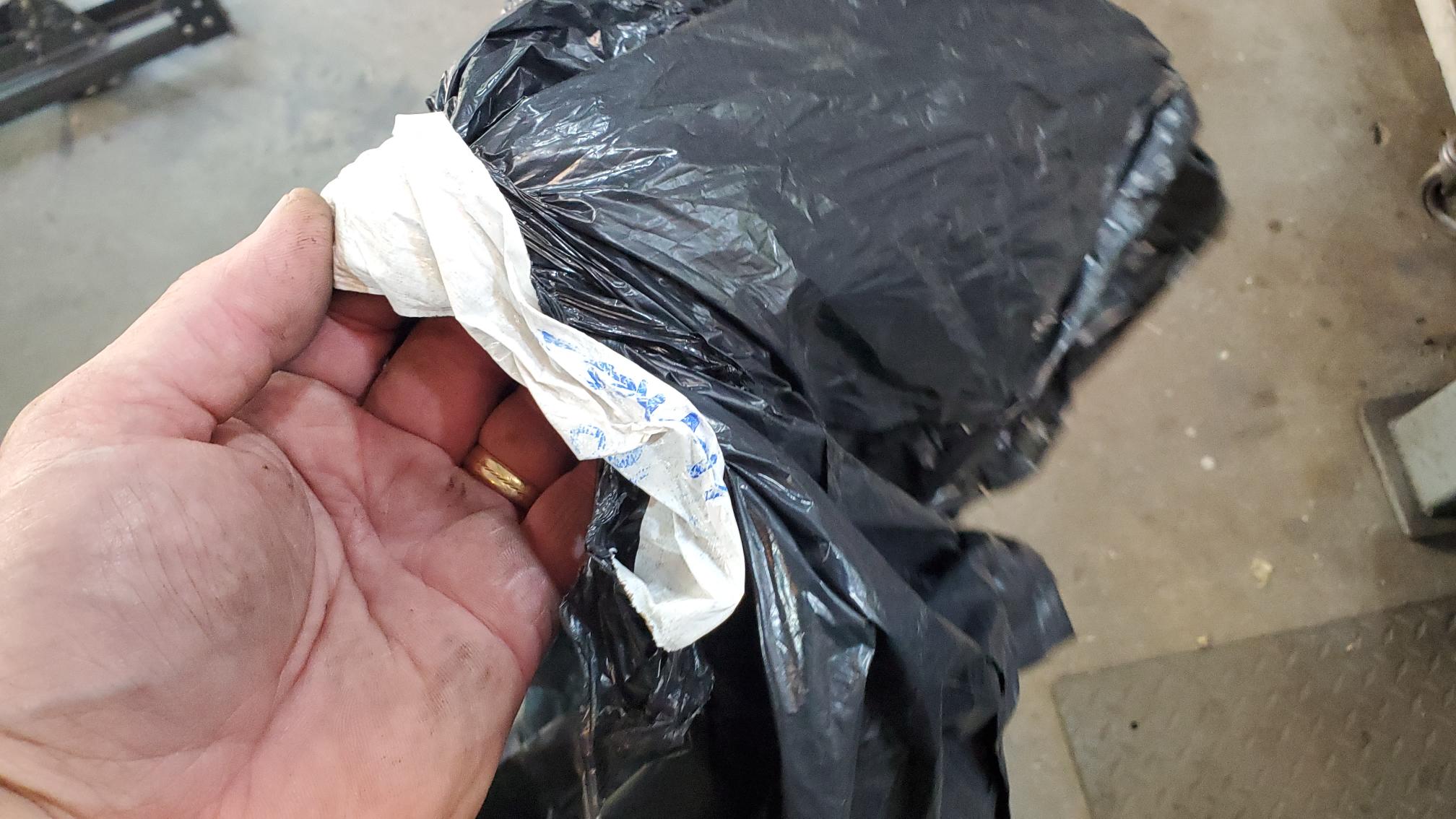

It’s like Christmas in October. The head came back from Texas.
I don’t think they packed it like this the first time they sent this head to me in 2008. The expanding foam works great.
I noticed the professional spread out the different shaped valves in different combustion chambers.

Quadfather NOV 08, 07:51 PM
Ran into some trouble while installing the head. I made the mistake of comparing my factory service manual instructions with the instructions in my Haynes manual and they disagree. GM changed the head torque sequence several times over the years, so the FSM is not reliable. Not only are the torque values different, but so are the numbers of the bolts.
When I started working on this engine in 2008, I thought I used my Haynes manual when installing the new head. But this time around the torque settings didn’t seem right. Searching the internet just caused more confusion. Then I remembered that I saved all the information I printed off from the old Quad4Forurms 13 years ago, including instructions for torquing the head. These are the instructions I used back then.
