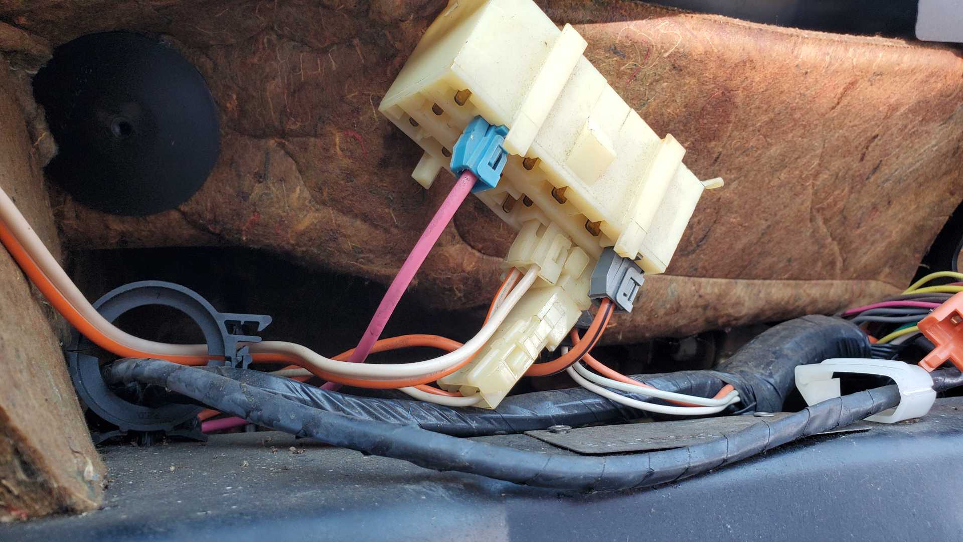

Been busy with work and other aspects of life, so I haven't spent as much time as I'd like studying the wiring for the Quad ECM. What has to be done is mating the two Beretta plugs to the Fiero's C203 connector:
Beretta/Quad 4 connectors on the left, Fiero C203 on the right.
The pinout for the Fiero C203 is pretty common on the internet.
So far I haven't been able to confirm the names of the two Beretta/Quad 4 connectors, but I will eventually.

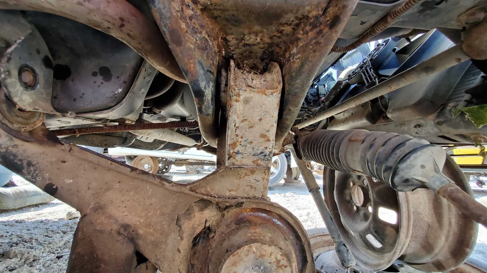

pmbrunelle
AUG 09, 11:25 PM
When the bolt is stuck to the sleeve, I normally grind each end of the bolt flush with the mounting ears, or below the surface if possible.
Then, I spread apart the mounting ears (or crossmember), and slip out the bushing that way.
Not sure if your junkyard will allow cutting/grinding tools...[This message has been edited by pmbrunelle (edited 08-09-2020).]
