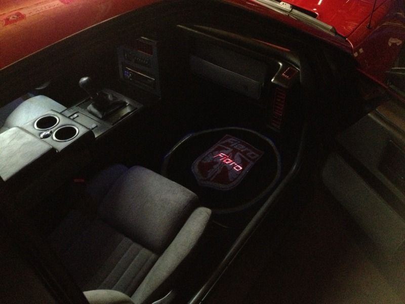

Finally got around to installing these logo projectors today. Figured they would work good for floor dome lights. They come on when the dome light is on.
