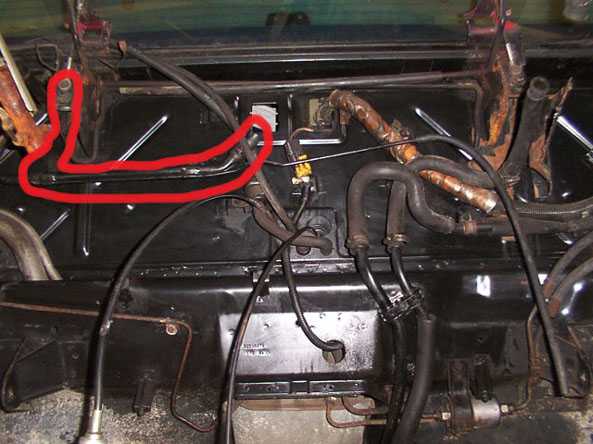

Everything you need to know about pulling the fuel tank is in the link above. The connectors for the fuel tank wiring are on the engine bay side of the firewall. Once the connectors are released, the wiring will come out with the tank. Maybe this pic will help a little (ignore the red lines):
 Sorry, I don't remember who posted this pic originally.

By the way, the fuel pump cable was rounted a different way, very very hard to remove, and probably the same to get back, so I rerouted it the same way as in the picture instead. [This message has been edited by Repulsiv (edited 08-01-2019).]

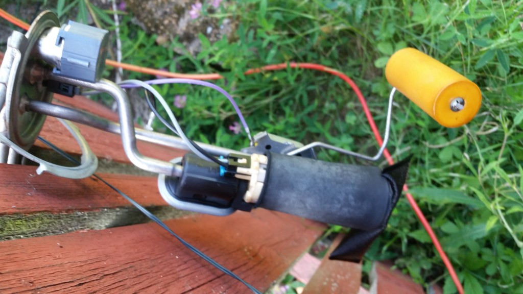

Look at this tank!
.jpg)
I seen tanks on 5yo cars that have look worse.. it desnt even look bad under, I suspect that someone changed this to a new one at one time , and then never used the car in wintertime.. I say that because its too good to be 32 years old, also all hoseclamps where of a swedish brand.
Here is the tank stuff (tankarmatur in swedish)
.jpg)

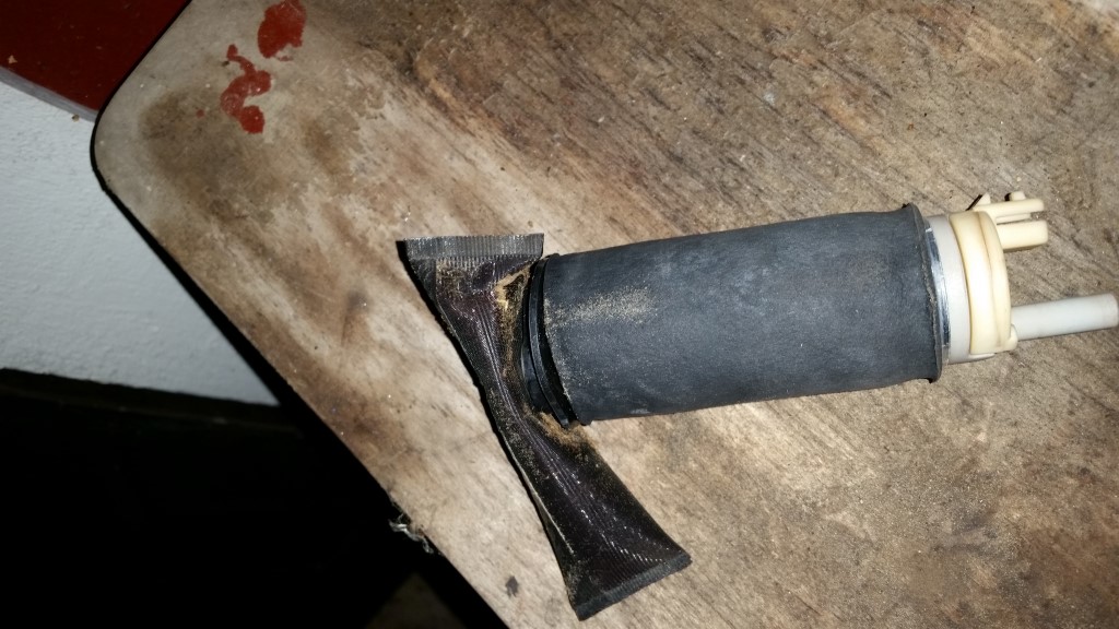

And here is a closer picture of the fuel strainer..
.jpg)
Its not clean, but can this really be the problem ??
