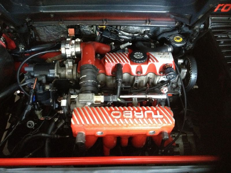

And an updated engine shot. Notice the air filter is no longer by the battery.

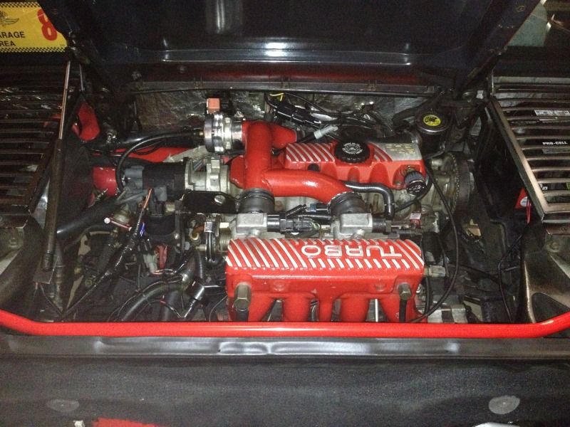

Suddenly I have a 3000 rpm idle. The idle valve broke itself trying to adjust the idle down. Turns out the second throttle body is hanging open. The coupler between the two throttles is coming apart. I've had enough of this dual throttle setup. Ordered an intake manifold gasket and I'm going to install the stock intake manifold I have. I'm going to modify a Fiero throttle to work, it's a lot bigger than the factory sunbird throttle. Who knows, maybe ill have better performance with only one throttle how the engine was designed.

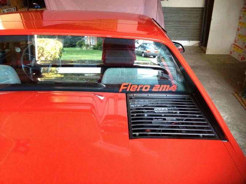

Thanks but I already purchased one. Hopefully I'll get my intake manifold gasket this week so I can get the stock stuff swapped back on. Got my decal today and installed it.

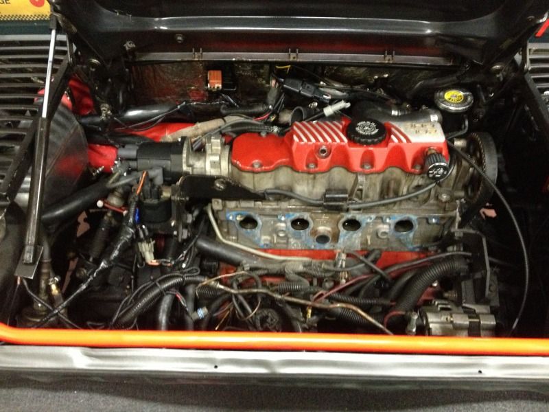

Swapped over the intake today. Changed the turbo oil return so its not running uphill and got the engine idling at 900-1000 rpm. Oh, and changed the oil. It almost feels a little faster with the single throttle.
