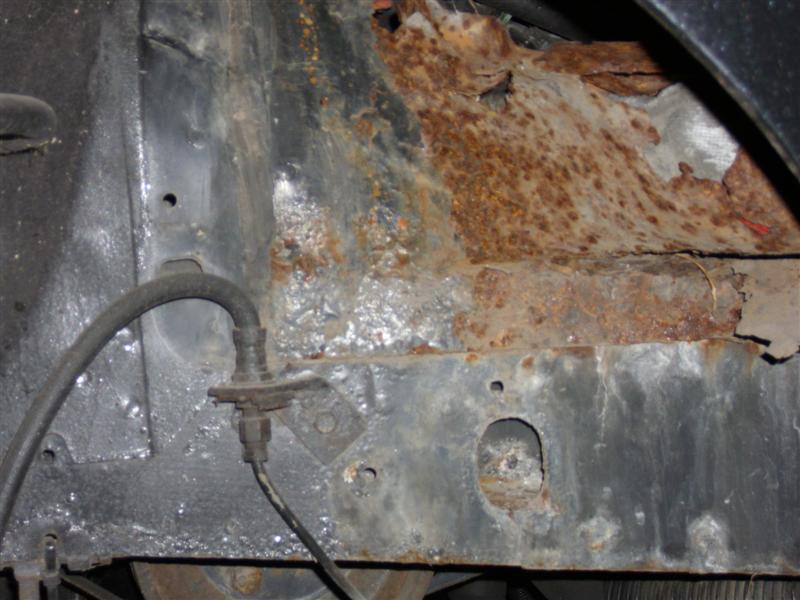

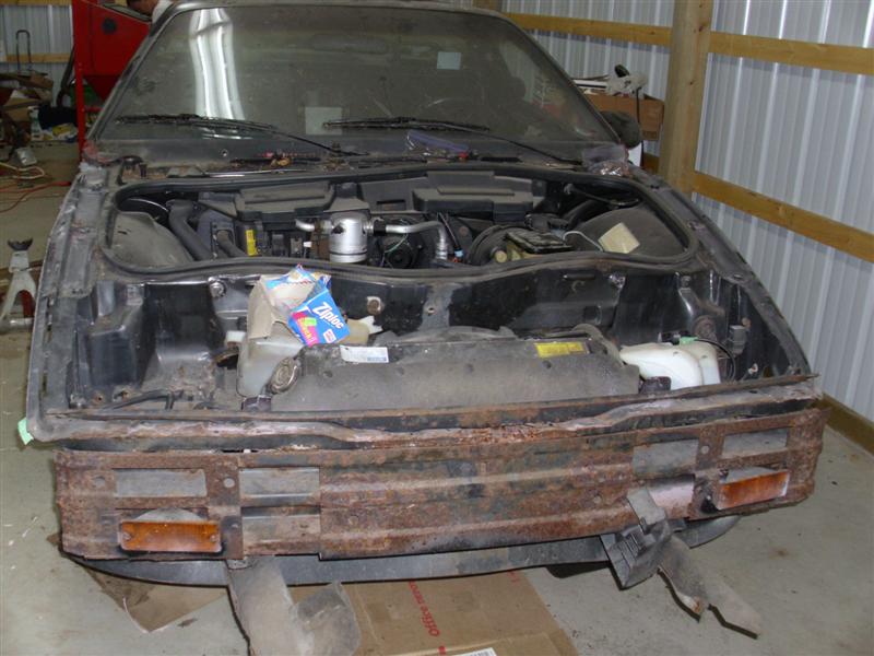

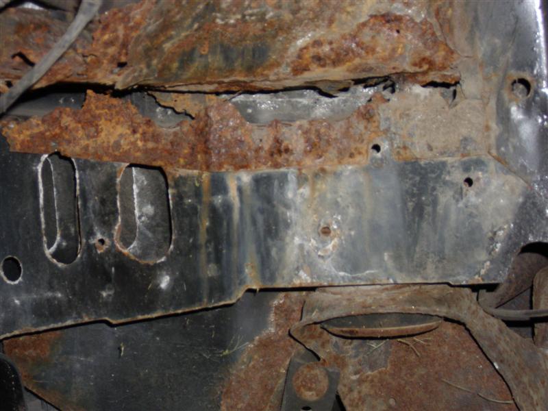

We managed to get most of the front panels of the car at our last trip to Uncle Bob's. Most of the stuff under the front panels looked pretty good, thankfully, because what was under the rear wheel wells didn't look good at all. Here is the photos from under the back quarter panels.
.JPG)
.JPG)

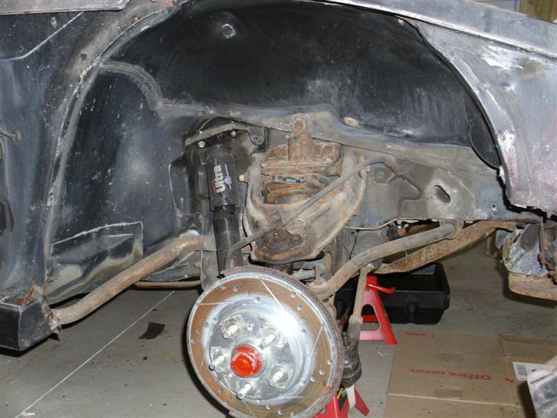

Luckily the front looked much better.
.JPG)
.JPG)
Clearly there is some wire wheeling that needs done and some painting, but it is livable.

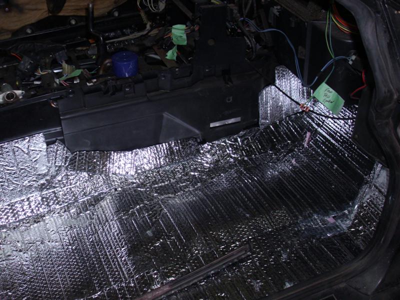

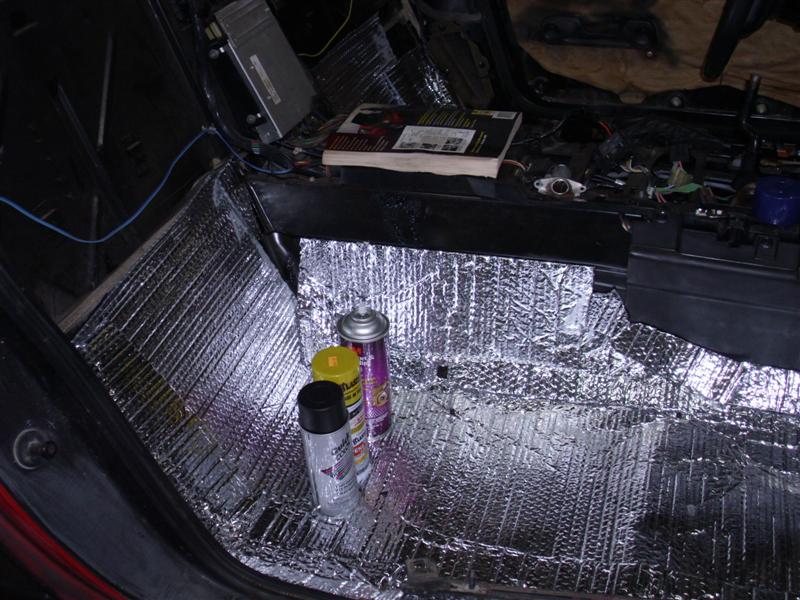

And the inside underlayment for the carpet is down.
.JPG)
.JPG)

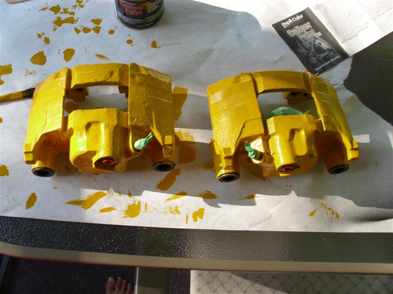

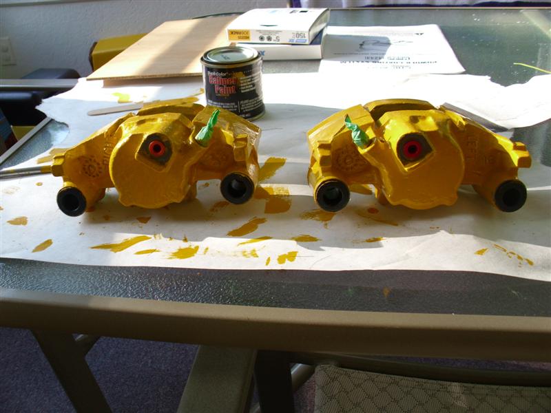

here are the last of the photos so I can update now! dad said how i painted the calipers so here they are i've only done 3 coats so far and will probably have to continue but they're close!
.JPG)
.JPG)

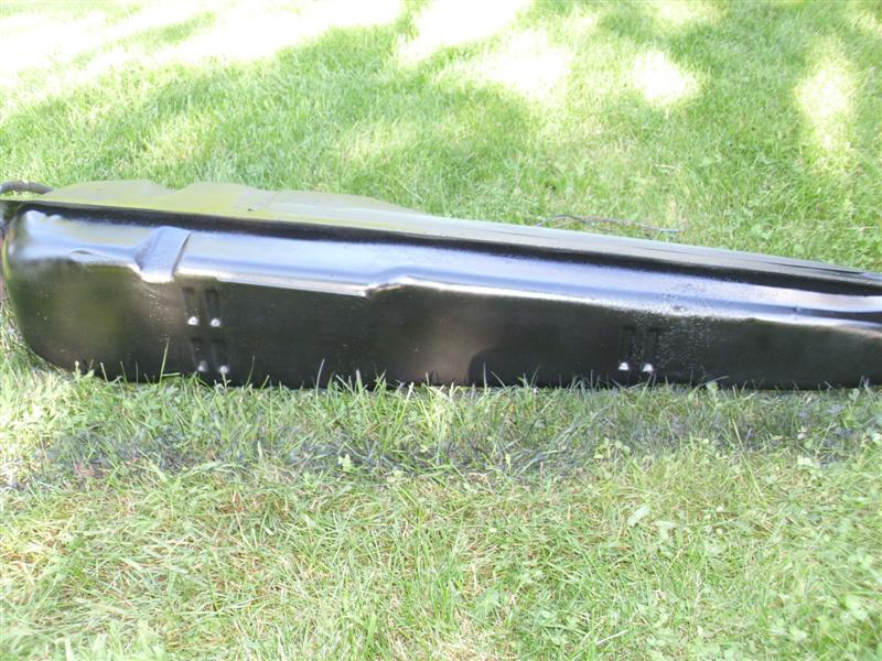

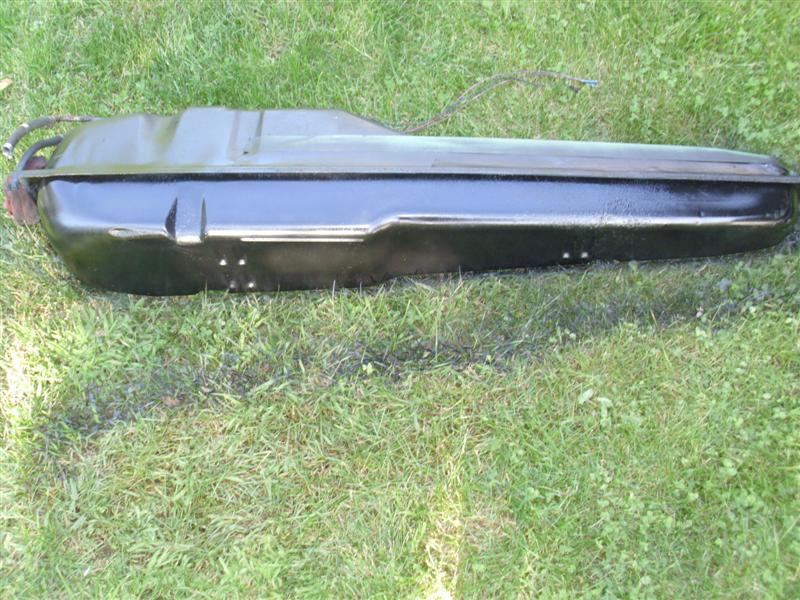

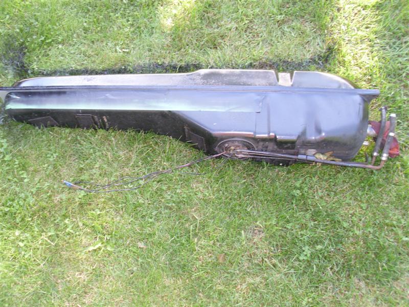

Dad and i have been working on my fuel tank he already posted the pics of how it looked before with all the rust... so what I did was wire wheeled the bottom edge and sides, taped off the non-rusted top, primed it and then put on the last, black coat of paint.
.JPG)
.JPG)
.JPG)

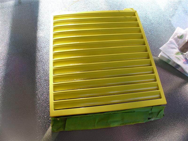

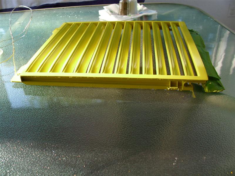

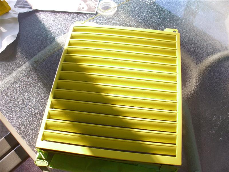

last i have been working on the back vents; first to try and get the paint off of them i tried.... first paint stripping them but the paint obviously refused to come unstuck second i tried sanding by hand yet of course i could get all the way down between the slats so that was a fail third i simply sand blasted them much much easier i tell you if anyone gives you the choice take the blaster! after blasting them i just scrubbed away all the sand, dust, and other stuff that was left behind then dad and i powder coated it yellow. here's the pics
.JPG)
.JPG)
.JPG)
-kathryn

Good choice for the carpet underlayment. The Reflectix material is also a good choice on the engine compartment front firewall.
