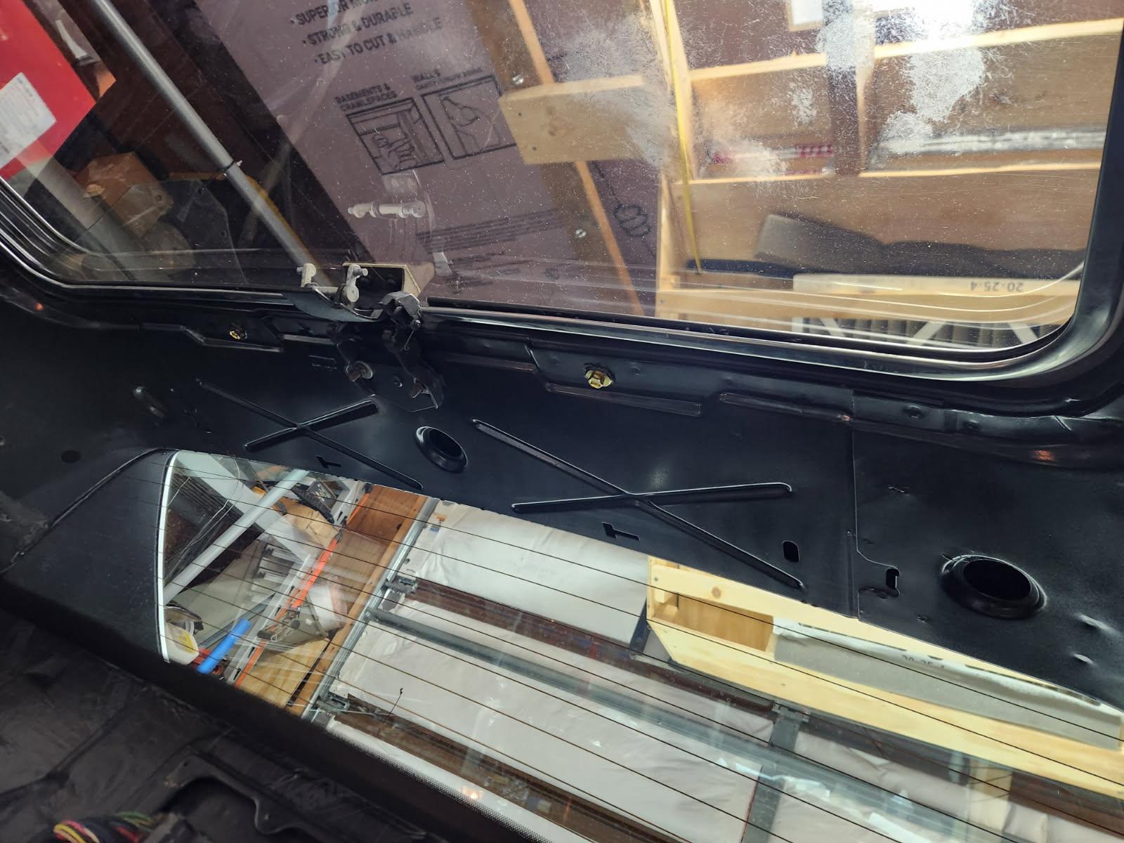

Thanks everyone. so it looks like the headliner has to come out if I remove the rear clip on my 88 GT?
Stingray92
DEC 19, 06:36 PM
On my 84 there are 3 studs that come through the roof, there recessed.
cam-a-lot
DEC 20, 06:27 AM
Can someone please confirm? If I remove the rear clip on my 88 GT, the headliner has to come out? Yes or no? I am trying to understand why it would need to come out since it is entirely inside the car and the rear clip is outside the car. Is this necessary so that I can reach the fasteners holding down the rear clip?

Did you watch the video I linked?
The link shows a notchback, but it is very similar for a fastback.
So YES, to remove the rear clip / panel on a '88 GT, the headliner has to come out.
{Edit} When I replaced my '88 GT headliner, I removed: *Seats {to get more workspace} *B-Pillars {buy 2 new ‘carrot’ type push fasteners} *A-Pillars {buy 4 new clips} *Headliner[This message has been edited by Vintage-Nut (edited 12-20-2025).]
