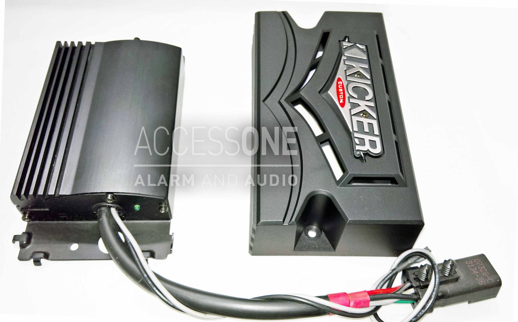

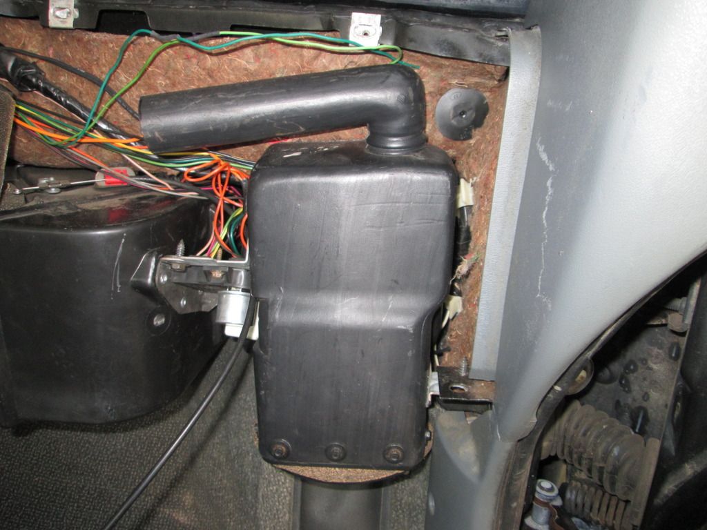

When I added the factory subwoofer housing with the Rodney's upgraded subwoofer, I picked up a Kicker 100w mono amp with a build in low pass filter. It was small enough to mount under the dash in front of the driver side speaker.
| quote | Originally posted by fieroguru: I also ordered a "dealer option" kicker 100W amplifier that drives the subwoofer in the Jeep SRT8. It is a small amp with a built in low pass filter I will use it to drive the Tang Band sub.
I wired up the amp for the sub and mounted it up under the DS front speaker:
Inputs: RED wire: +12V ignition switched with 15 amp fuse Black wire: ground GREY wire: right rear + speaker wire GRY/BK wire: right rear - speaker wire GREEN wire: left rear + speaker wire GRN/BK wire: left rear - speaker wire
Outputs: GREY wire: + sub wire BLACK wire: - sub wire
Tang Band sub:
They are still available on ebay: https://www.ebay.com/itm/26...90403043%26pmt%3D0%2 6noa%3D1%26pg%3D4481478%26algv%3DDefaultOrganicWebWithV11WebTrimmedV3VisualRankerWithKnnV3AndUltBRecall%26brand%3DKICKER&_trksid=p4481478.c101506.m1851
