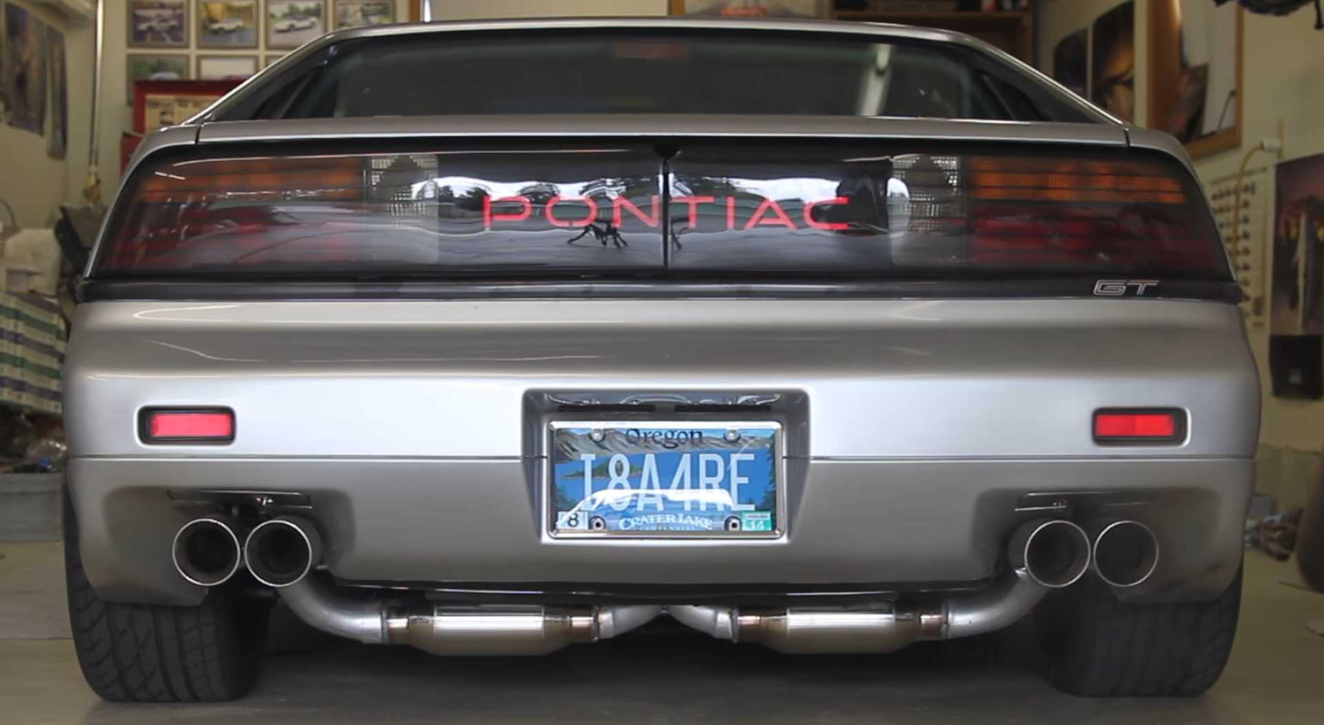

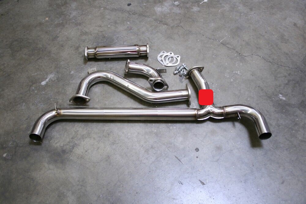

Thanks Formula! I found a video with a Fiero that has a VERY cool looking exhaust, and it may be what I end up deciding to do. The only thing is, I have to temper myself because I don't want to do too much and disrupt the originality of the car. I want it to look stock, just perform much better than when originally stock. Either way, what I'll probably do initially is just continue to use the existing Ocelot exhaust system I have... but use it only at the "last mile" part. So looking at the image above of the exhaust system, I'll simply cut the pipe on my Ocelot system and weld in a fitting that will allow me to bolt it up to the fancy exhaust:
I wouldn't cut the pipe that I just ordered... but I'd cut the pipe on my Ocelot system to install a flange so that it could replicate this "section" of the exhaust system. (if that makes sense).
Anyway, this is what I happened to see on YouTube. It's actually pretty nice...

1985 Fiero GT FEB 25, 04:52 PM
Looks good, but I would imagine having those pipes stuck down like that would negatively effect aerodynamics (already not great on the fastback), and potentially hit things, which wouldn't be good.
fliphone FEB 25, 05:31 PM
My exhaust has pretty similar if not more "out there" routing. Because you're so close to the rear wheels, it's actually not too bad when it comes to ground clearance. I think my cars are about 2" lower(?) and I'm yet to smack anything. And while I probably do get some negative aero effects, I'm yet to really notice anything at any speed I've managed to hit to date.
I'm not sure if this is where you got that picture from, but there's actually a video of that grey car starting with a 3.4DOHC

I got it in the mail today, and it's actually really, really nice... like, super high-quality all around. I'm assuming he has a few...

And the way it's designed, I can buy an aftermarket catalytic converter that's 2.5"s and build an intermediary pipe that I can simply bolt in to replace this cherry-bomb thing that's currently in there... without having to cut it.
