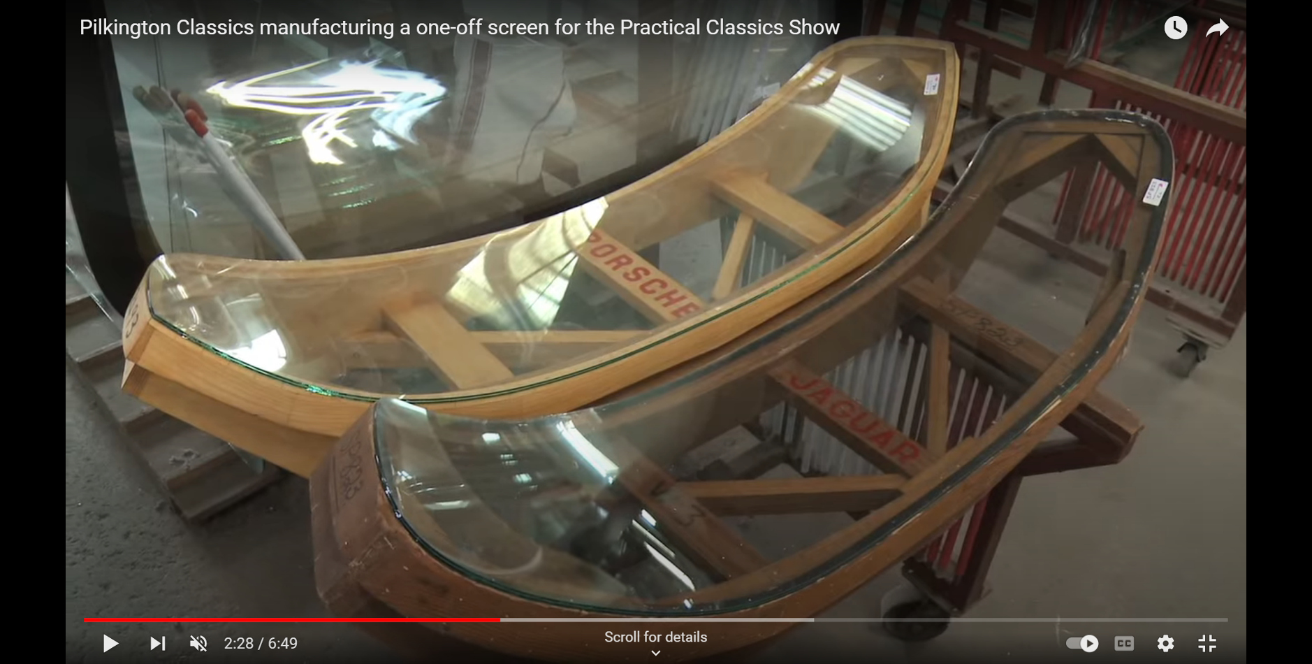

 Skilled labor workers making automotive safety glass, at Pilkington, UK. Sure, making the mold is the portion that a home builder could accomplish, to some standard of accuracy. Shipping it to the factory for inspection and approval, then, firing up the tin pot to float the molten glass. Pretty sure that some, a few engineers, have considered alternative methods, to duplicate the resulting product. Hard to do that for less than the asking price, the demand setting a profit margin. Consider using production windshields in modified form, waterjet cutting larger pieces to fit your supercar design. A compromise to economy.
