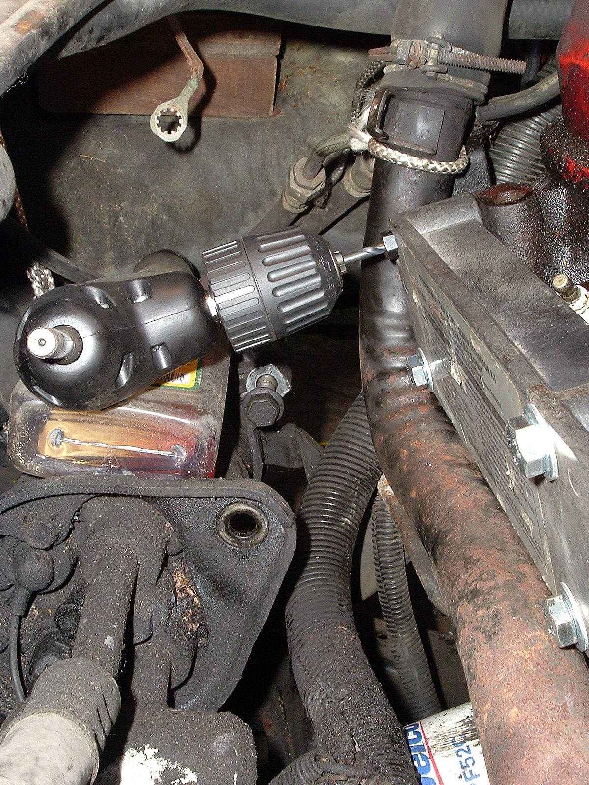

Originally posted by RWDPLZ:
The fact Kent Moore made a specialty tool just for that job back in the day just screams 'if it aint broke don't fix it'
Might as well see a shot of that device being used. This was a bunch of years ago with my '86 GT. Of course, it had to be the front bank where the two broken exhaust manifold bolts were located... which meant the cradle needed to be tipped down so I'd have some clearance to work. And yes, this is also the one Fiero of mine which has A/C, which meant the compressor was in the way. This photo also shows a right-angle drill attachment which was absolutely required. Horrible awful job.
