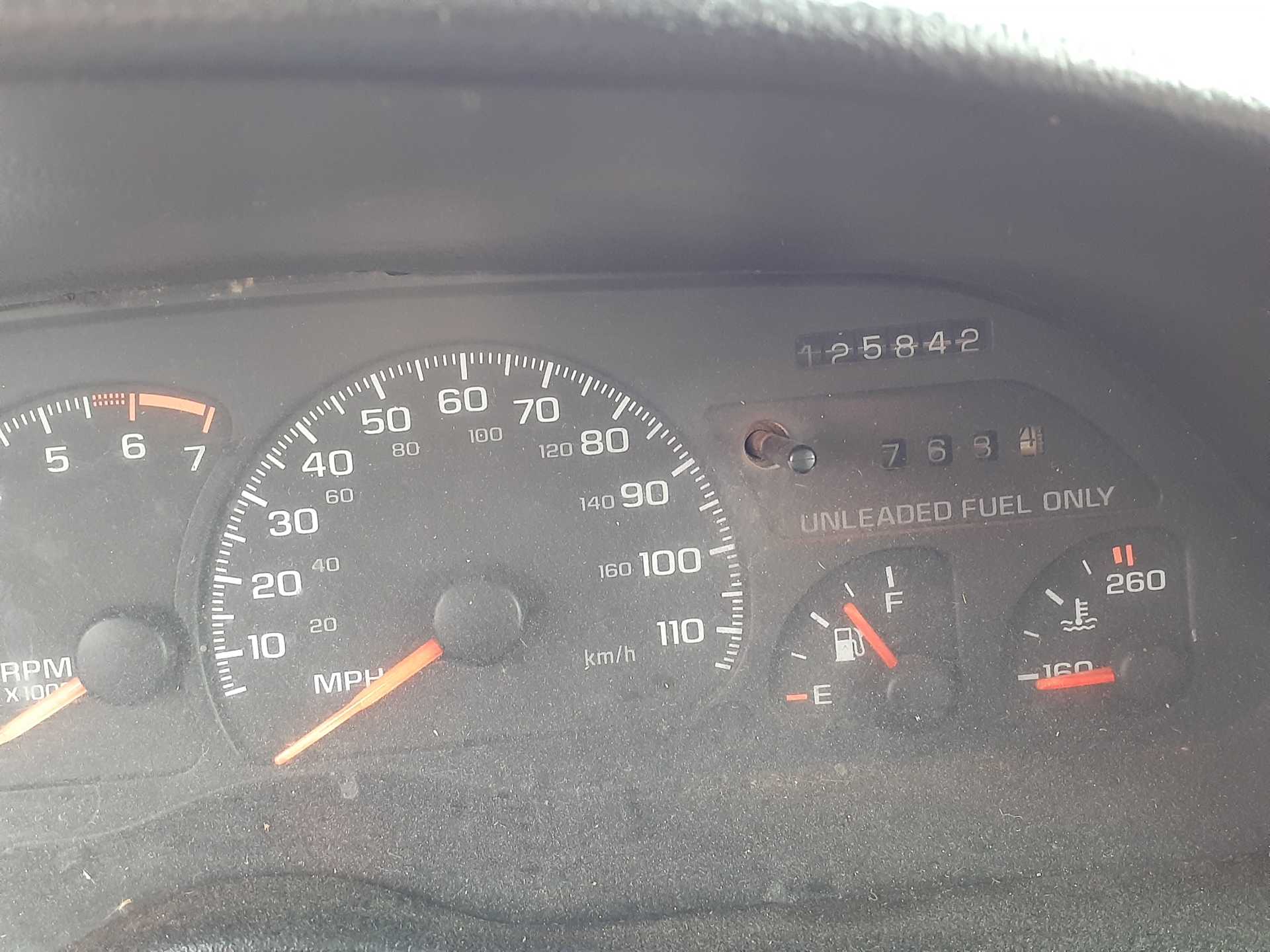

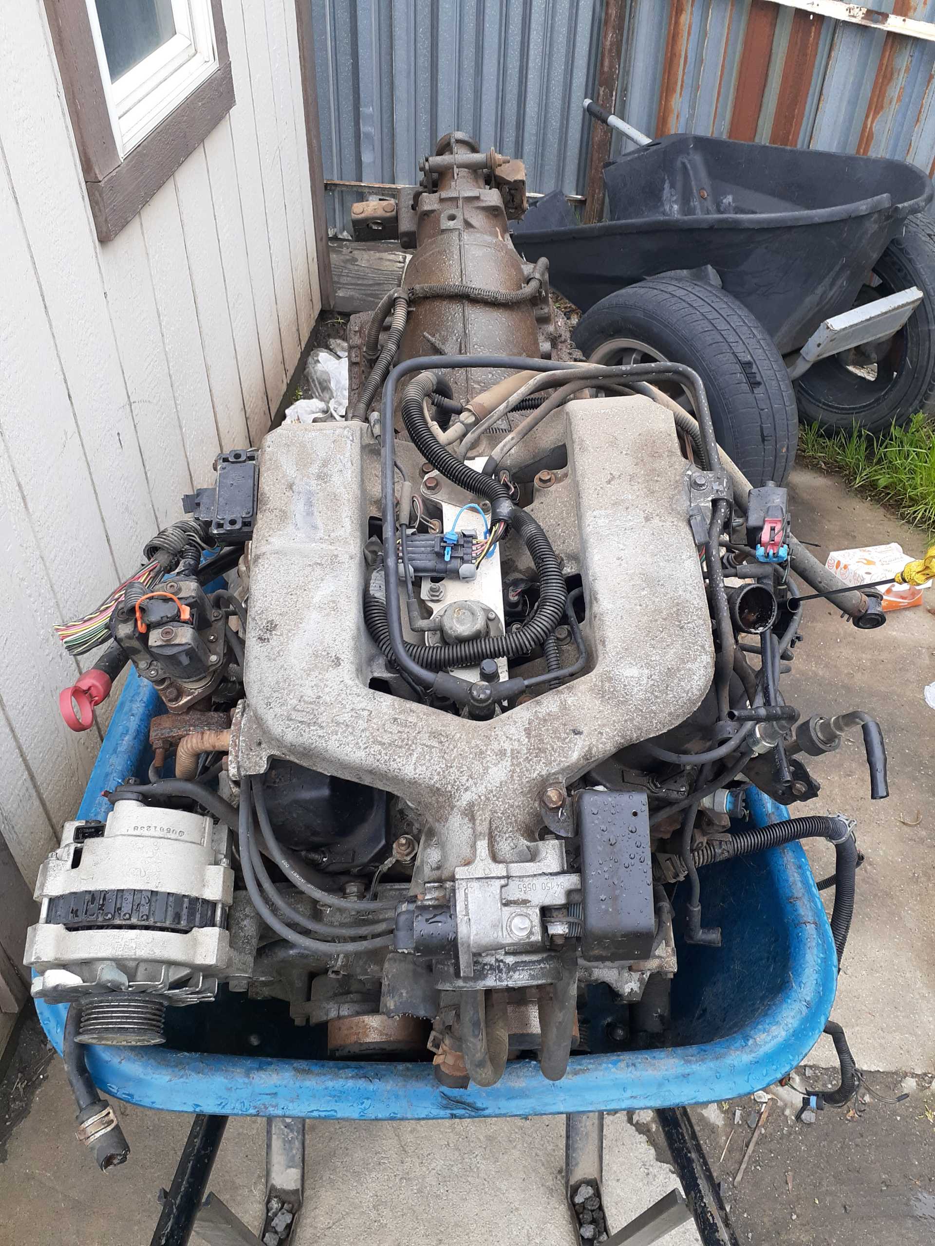

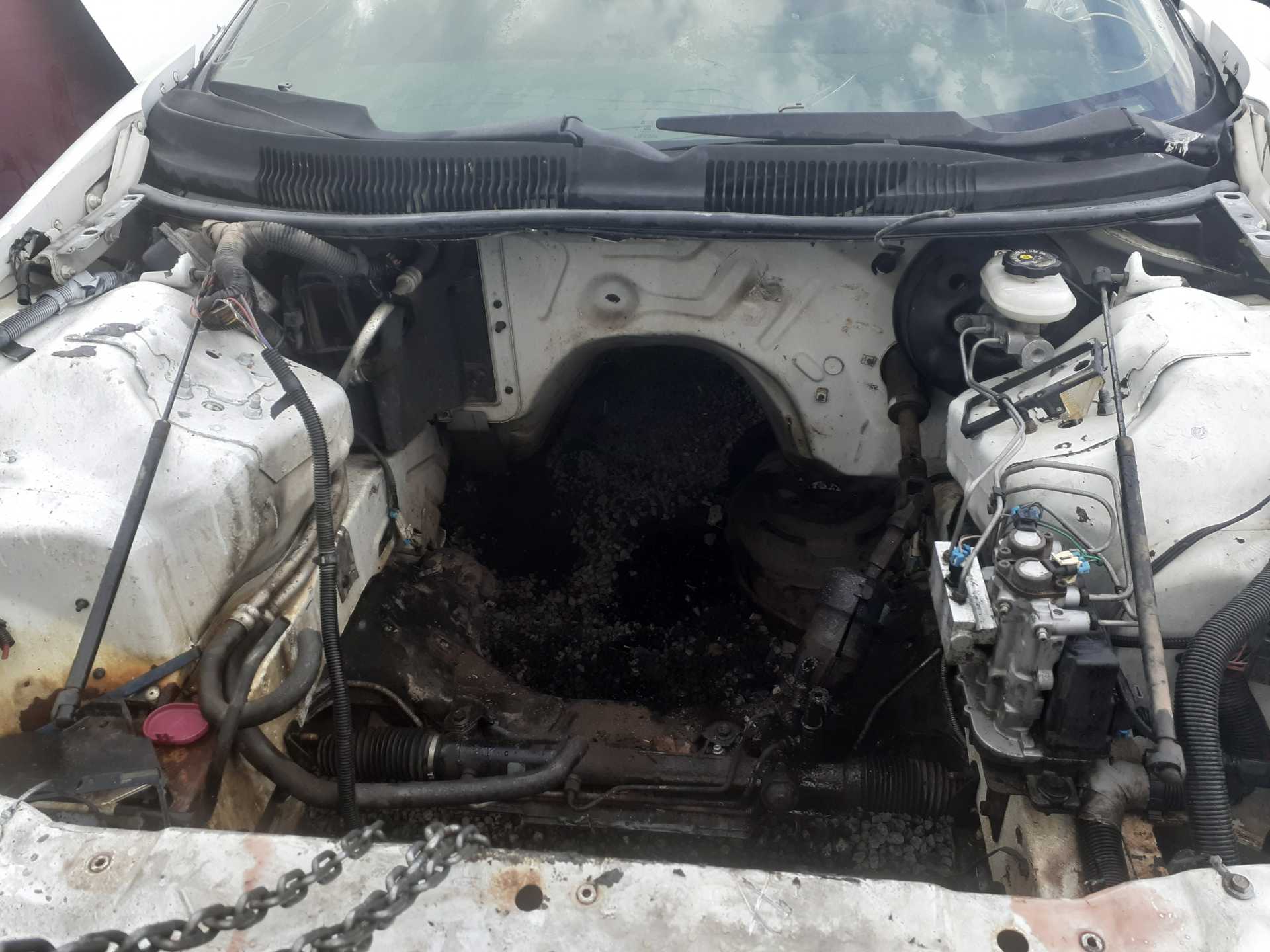

Well, here are some clues from today's 5 hour shift (and 2.5 hours of driving) at the junk yard.
I was prepared for a much higher mileage motor so depending on how things look on the inside I may not have to do a full rebuild. The donor car was otherwise in excellent shape with a well cared for interior, clean oil, etc.

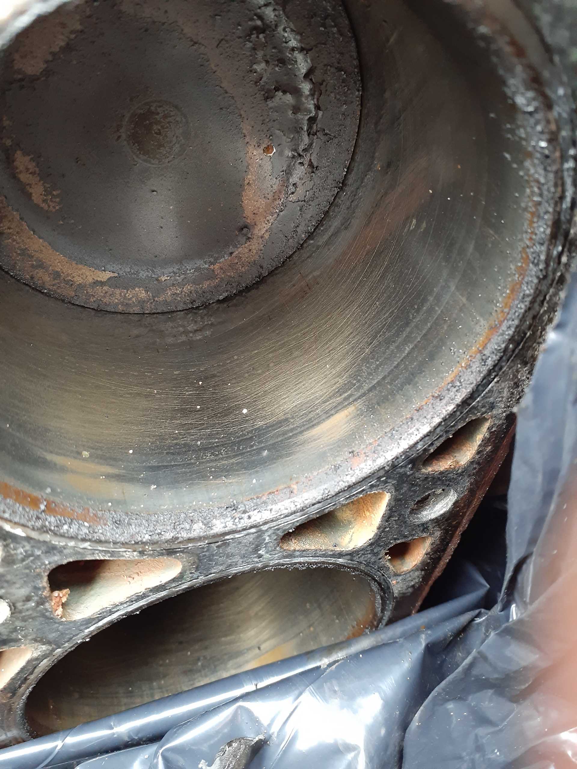

Well I went back today and broke it down to the short block, then dropped it off at the machine shop for cleaning and inspection.
