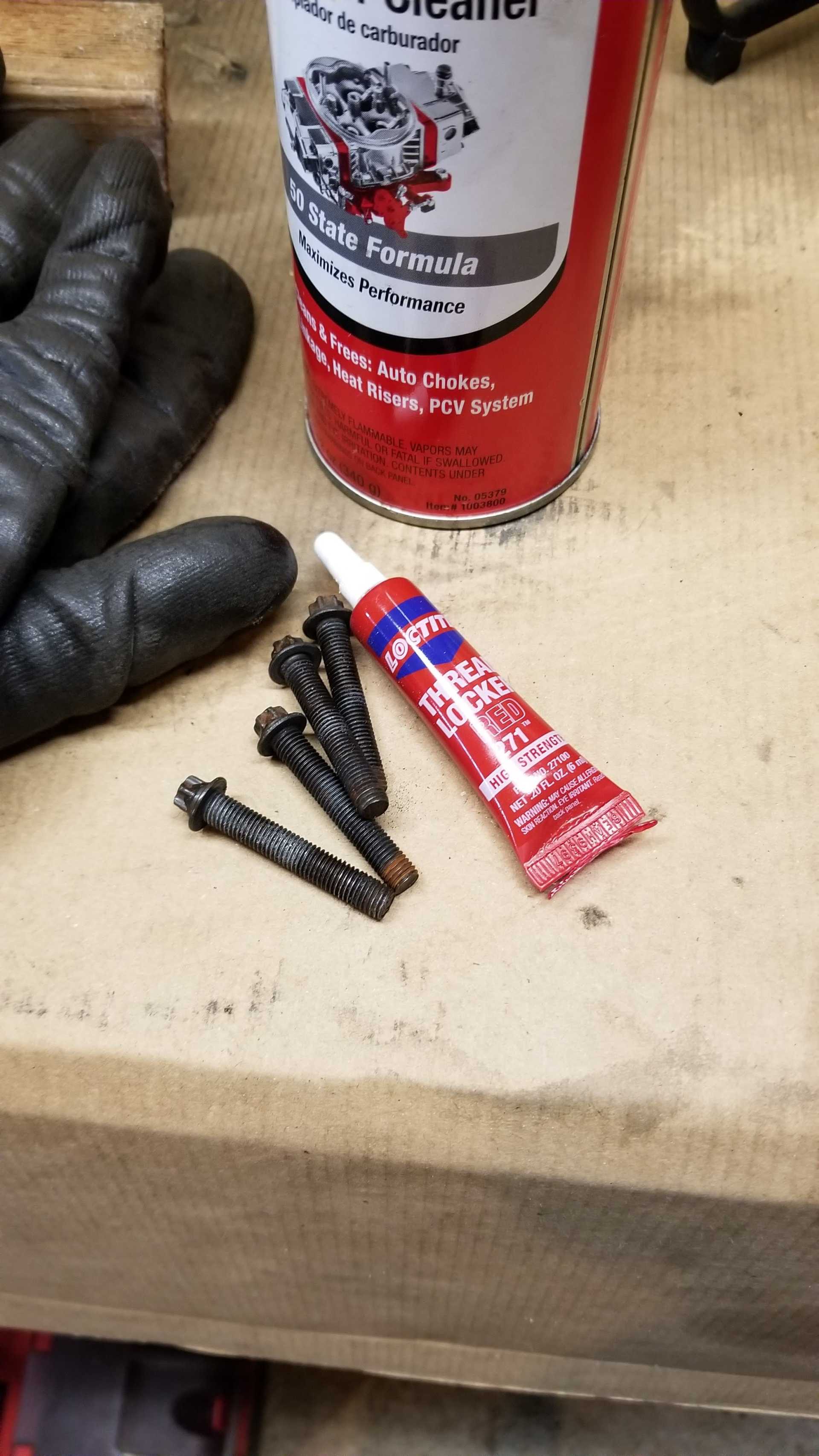

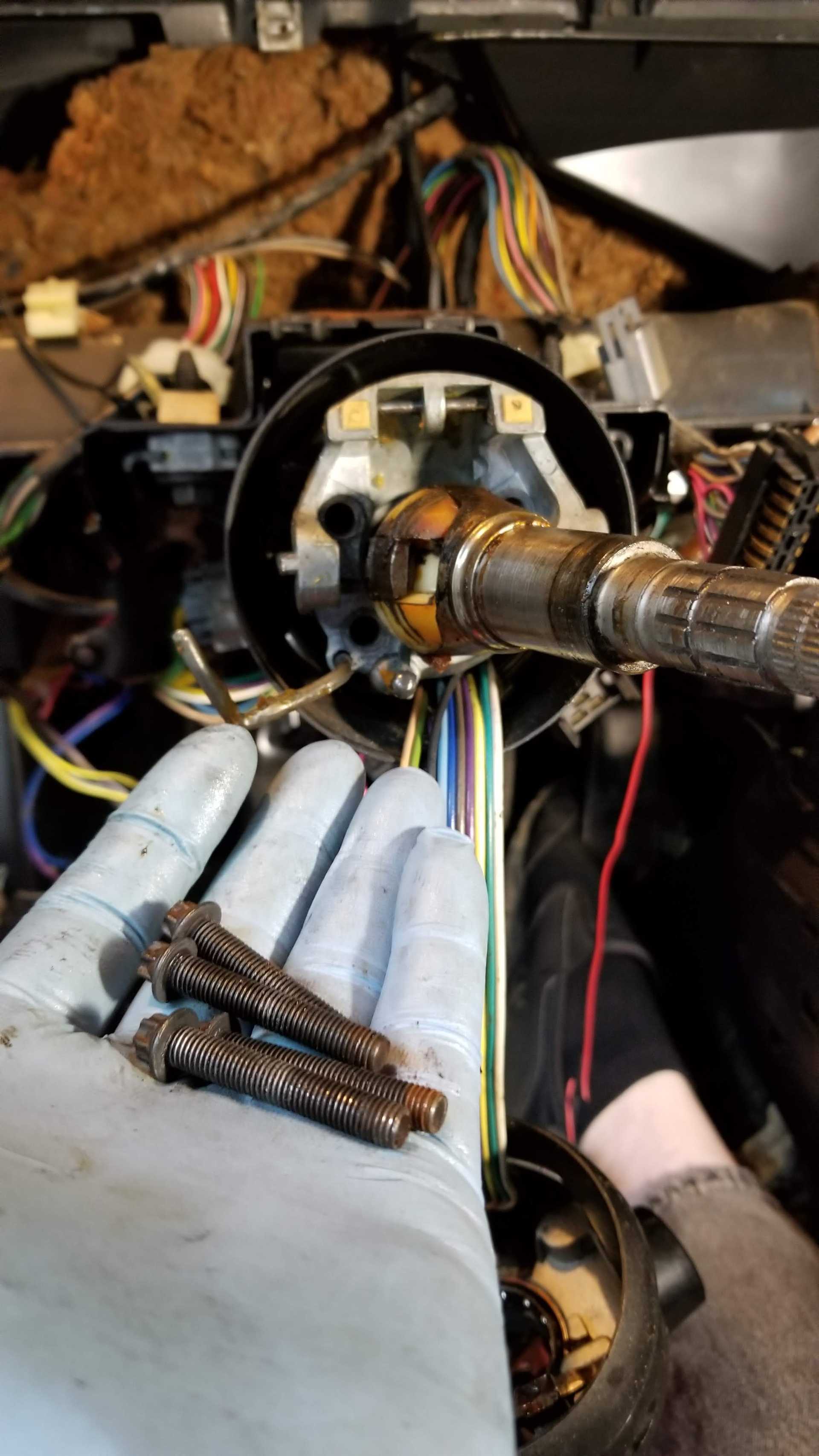

So today I've got a couple little things, the steering was "fun" lol.
Here is that before and after.
These little bastards, at least they were in good shape an I had threadlock.

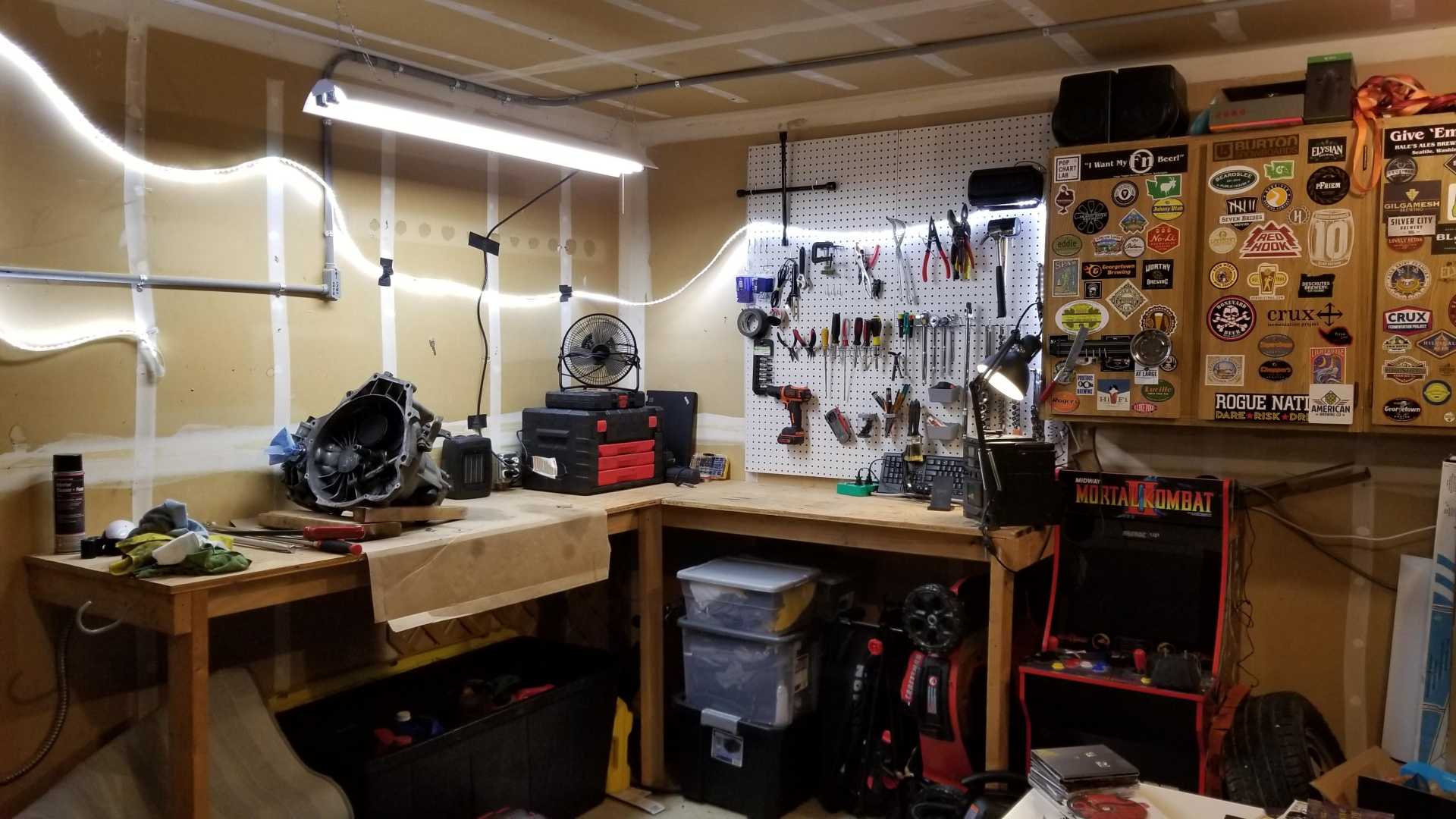

I cleaned up the garage, put up a peg board, installed new lights, and got a place to store some of this stuff which feels nice.

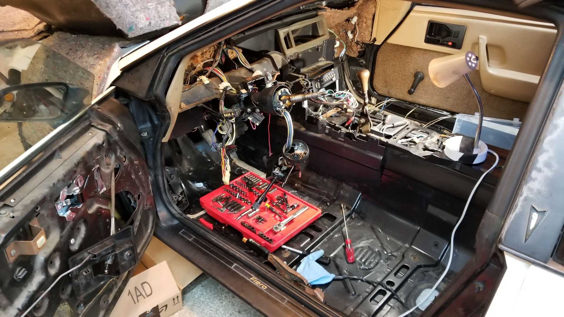

Cleaned up the wiring for the radio, removed all the wirenut connections, soldered the seat speaker connections back in, all clean and happy.
Also found this aftermarket remote locking and security system? The car is all manual locks, windows, etc so it's kinda an odd find but wasn't too bad to rip out.
I also was doing some repairs to stuff like this plastic structure for the arm rest and console, doesn't need to be pretty just less fragile lol. Tried using cheap zip ties for clamps, because I don't have clamps, and that worked out alright.
