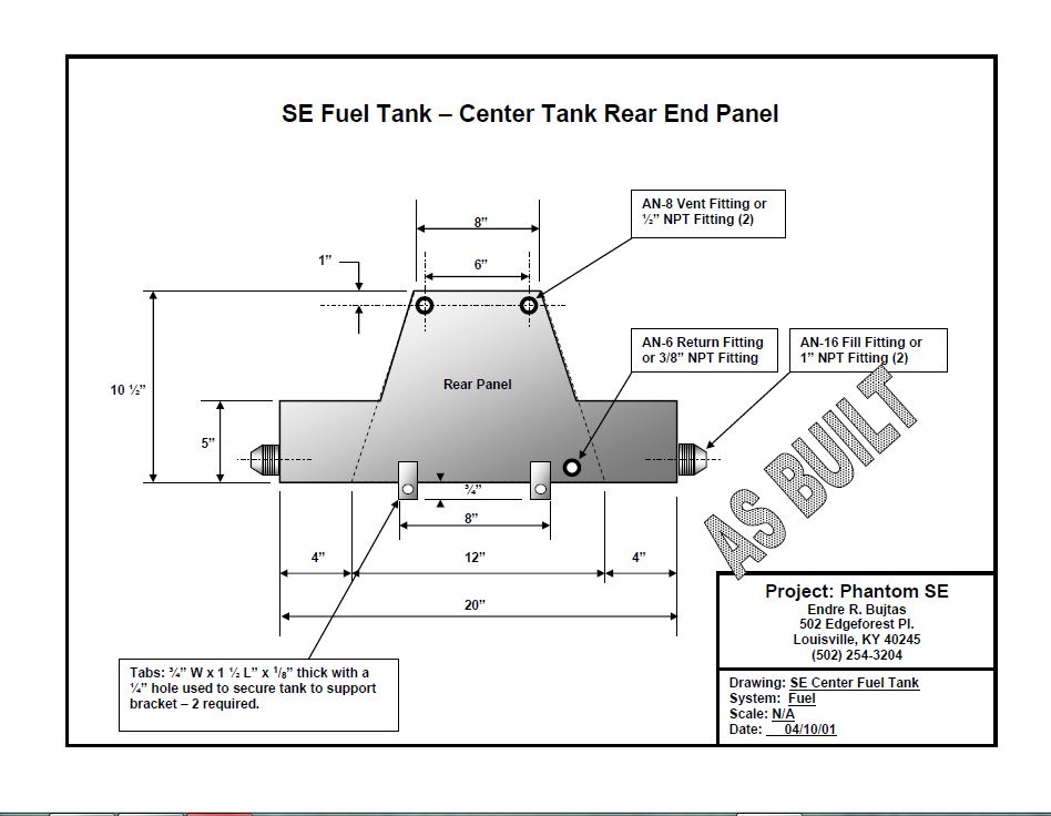

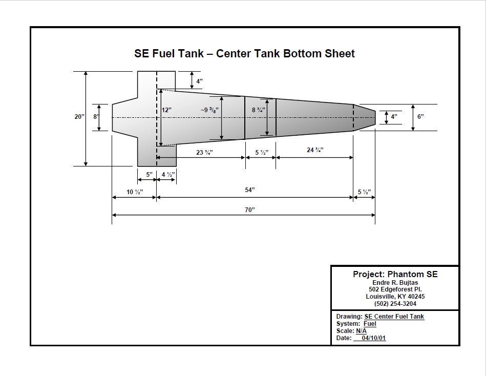

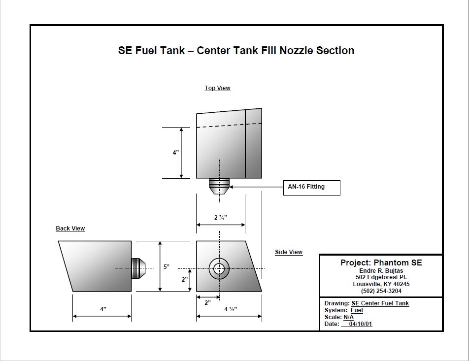

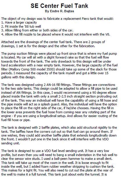

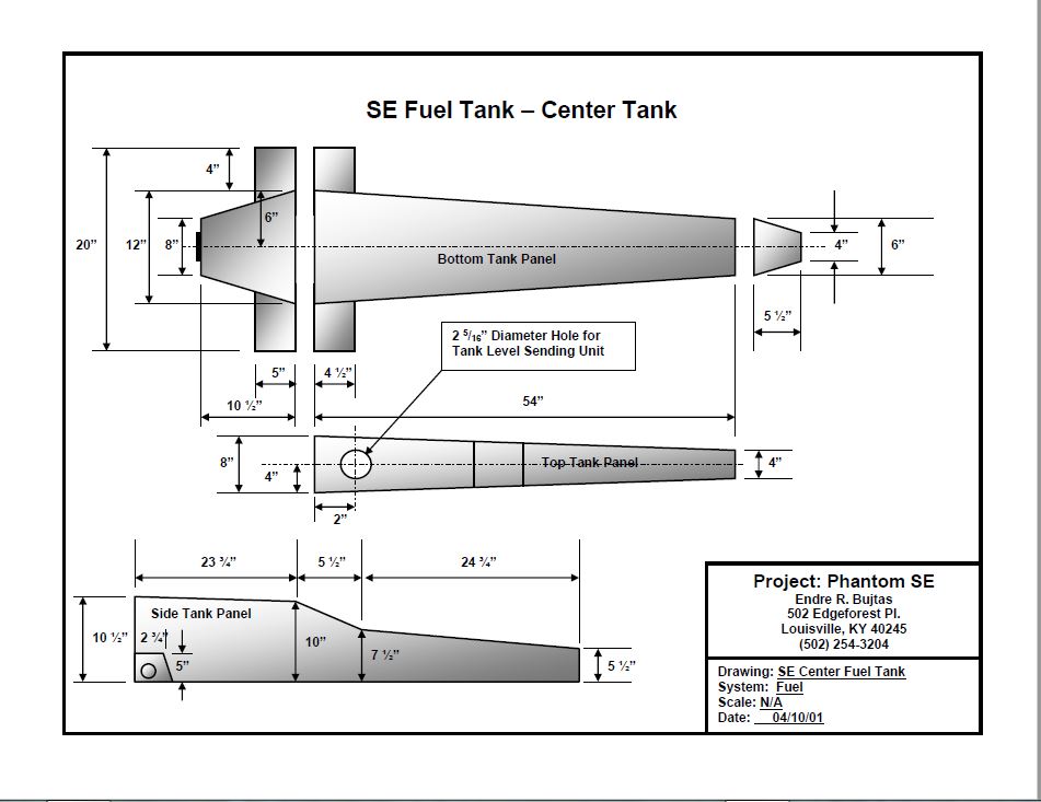

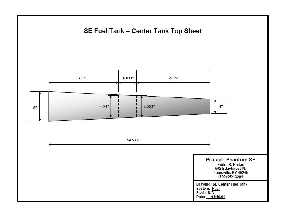

hercimer01
AUG 13, 12:07 AM
I saved these before the website went down. These have been converted to JPEG. I have them as Word doc and PDF also.
CJB118
AUG 13, 12:17 AM
That's a good starting point, it will be included with the early info dump. Some features will be nerfed to make a universal fit, all years and models, etc., but the dimensional drawings will covey the complexity of the needed shape.
