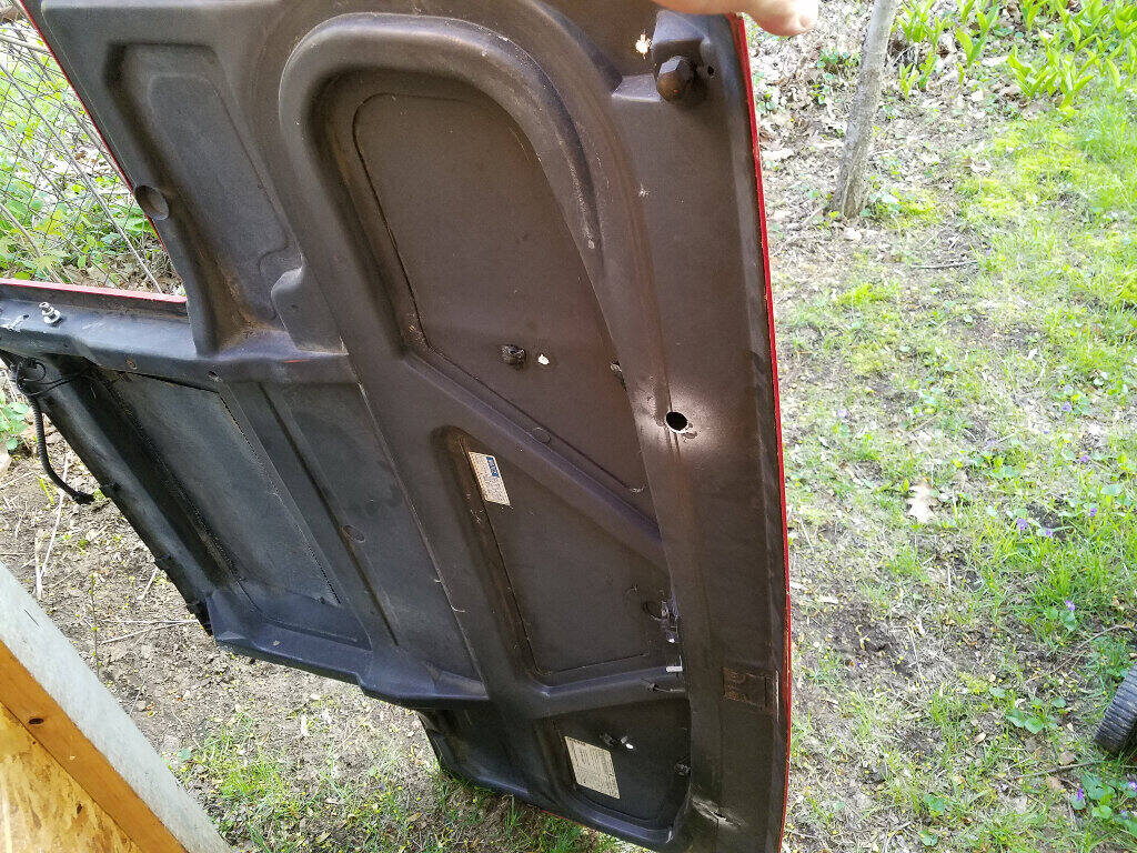

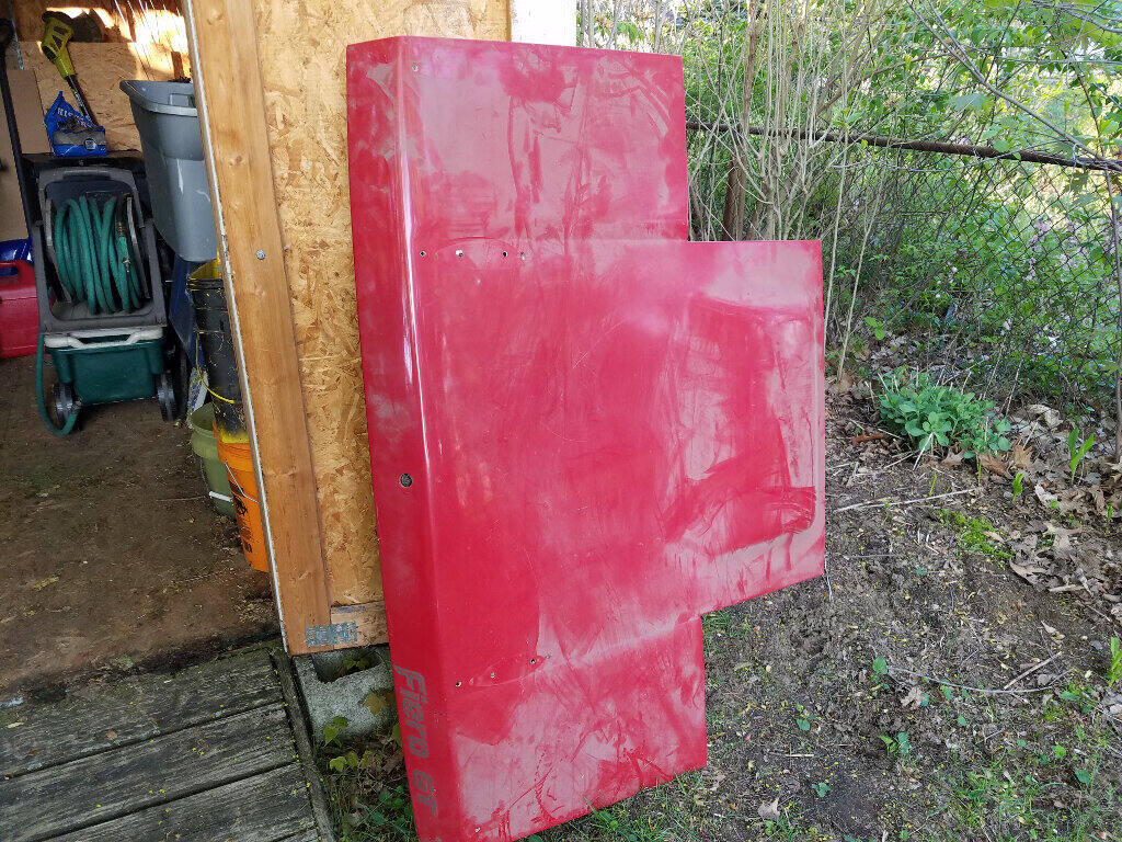

Well, there are two layers of lid with a gap farther back, but that's not to say one couldn't drill thru both and maybe have a spacer if needed to firm it up. Is the objective just the change in look? |
I was wanting to mount the spoiler I got on a wing delete decklid and I figured if it could be moved back a bit I could drill the holes wherever but I think I`m going to mould a scoop on to a decklid anyway so I will probably keep the wing delete decklid intact and get another.

TXGOOD, I think there were two different spoiler stands. One had the studs at the extreme ends and one had the rear stud mounted slightly forward. If so, that would give you a little more rearward position. There's plenty of room for positioning of the forward stud, as you can see.

| quote | Originally posted by fierofool:
I looked at my decklid and it looks like the rear bolt goes right through that little button like your picture. If I decide to use my decklid it shoud be fairly easy to tell where to drill the holes.
fierofool
MAY 16, 10:12 AM
I suspected that a non-spoiler lid would have a button like the other two and that would be a good locator. Something I do when a spoiler is removed and replaced is to use a small bit of windshield setting tape, flattened to make something like a washer to go around the hole on top of the decklid between the lid and gasket. It makes a good water seal. Then once the studs are passed through the decklid, a small amount of anti-seize on the stud to prevent the nut from rusting to the stud, in the event any water does leak through.
