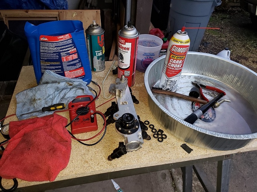

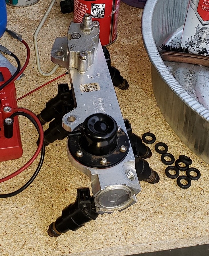

Well I got the original fuel and injectors cleaned up tonight. 4 out of 6 were clogged solid.

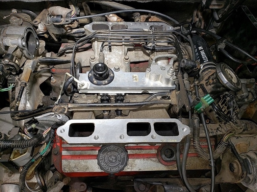

I put the fuel rail back in. It holds good pressure. Got it to start up tonight for a couple seconds. Should be good now I hope.

Just a little update.It did run very well until the fuel pressure regulator went out. I have been reworking the injectors and am waiting for a pressure regulator. I got the brakes done and am working on the interior. The rear bumper just needs final assembly. I plan on having it the Dells Run for sale if anyone is interested. [This message has been edited by hercimer01 (edited 05-17-2019).]

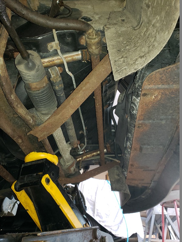

The car has very little surface rust.
