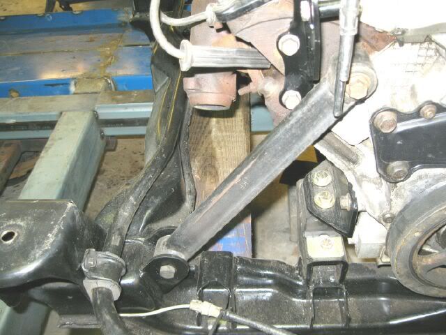

Raydar, as far as your passenger side axle movement, under extreme compression it can almost touch the passenger frame rail... depending on elevation of your engine, the balancer bolt is normally 1 to 2 inches below the frame rail, so if you can accommodate the axle moving upwards about 2" above the balancer bolt, then you should be OK.
If you need to rework that mount, you could always just install and 88 lateral link like this:
APR 12, 09:52 PM
Thanks everyone for the comments and info!
Paul, I'll have to check the axle tomorrow. (Went out to eat tonight.) I was looking at the relationship between the tranny, the tripot, the axle and the bracket. I'm thinking that the bracket is near enough to the tripot that a 4 inch deflection at the wheel will produce much less than 2 inches of deflection in the area of the bracket. Probably a huge non-issue.
