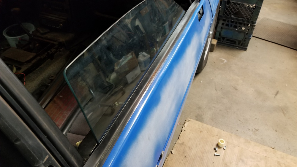

I still have to transfer the felt inserts over to the Firebird wipe and adjust the screw holes, but I'm very happy with the results.
I think this design is so much better than the Fieros. Because the lip is so big the mounting holes don't have to be precise.
Of course, there's still a chance I'll discover a problem when I put the window back in the door, but so far so good.

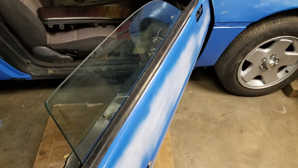

I had to adjust the screw holes several times, but finally got the F/C wipe installed in the door. The long felt strip makes it a very tight fit to get the window back in the door. The strip actually caught the bottom of the window a couple of times but by using a screw driver I guided into place. I ran out of time to get the window bolted in and to check the lowering and raising operation, but so far so good:
Quad Raider DEC 03, 10:15 PM
I put the door back together and it works. I'll post photos tomorrow.

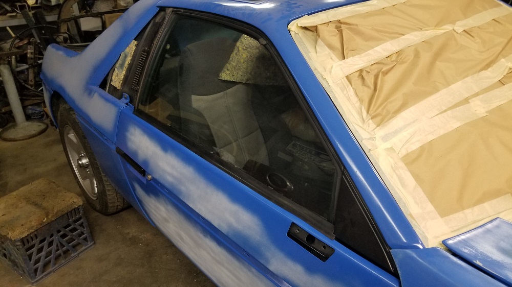

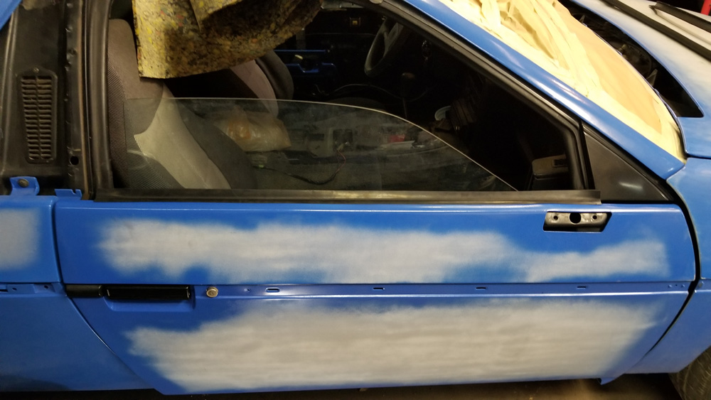

I installed the dew wipes on both doors and they work and look great.

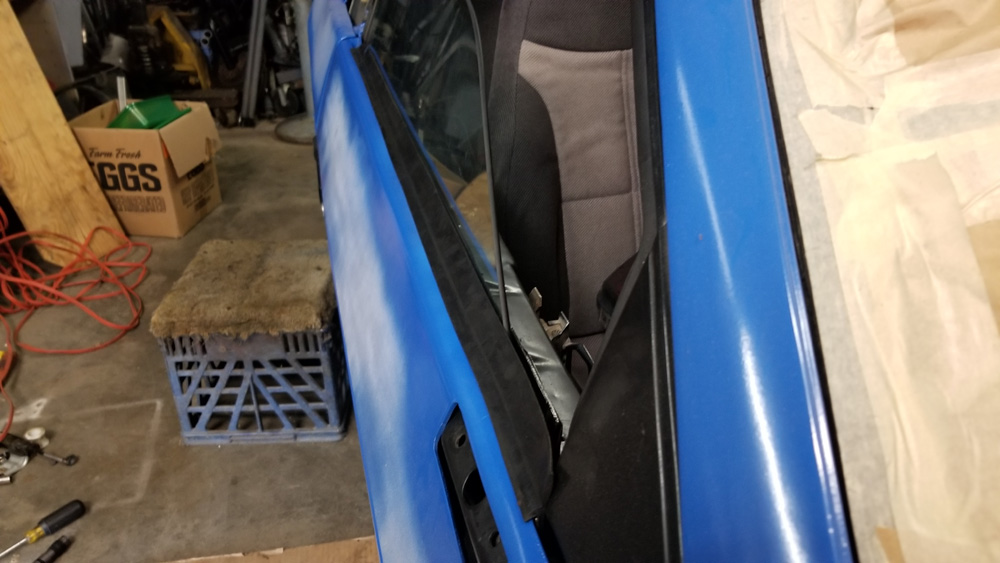

After I took this photo I trimmed the front of the wipe so it would fit around plastic triangle. I'm very happy with the results. I've now moved on to painting the car.

Yes, the Firebird wipes are long enough to stretch the whole length of the Fiero door. They’re about a foot longer than the Fiero wipes. Once I got mine installed I thought about redoing them and making them the length of the door, but the plastic triangle fits too closely on my driver’s side door.
I ditched the square felts and the felt inserts. I’m not an expert, but I don’t think they’re needed with the Firebird wipes that have the felt strip. The Firebird wipes don’t have them and the Firebird window is bigger than the Fiero window.
The windows install the same way they did with the Fiero wipes, but you have to be careful not to catch the felt strip with the glass as you’re sliding it into the door. I ended up drilling the mounting holes on the wipes about a quarter-inch lower on the wipe than on the Fiero ones, because the lip holds the wipe higher on the door.
