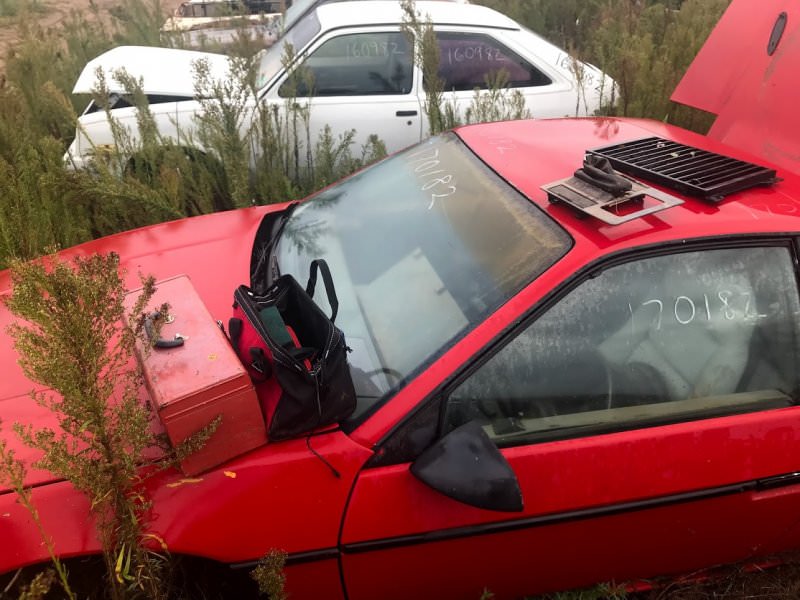

Drove 45 miles out into the boonies to the junkyard on Saturday where I was given carte blanche to loot what I could find. Of course both Fieros were on opposite ends of the lot about a half mile from each other. I took my dog with me and he absolutely loved peeing and pooping all over while I wandered around lost and confused in the MASSIVE junkyard.
After walking around in circles for an hour trying to find the cars, gawking at the random cool cars I kept seeing, "LOOK AT DAT SWEET 70 FIAT 124 SPORT SPIDER!" "HAWT DAMMM, DATS a 53 BUICK!", getting rained on, and accidentally mistaking a gen 1 Toyota MR2 as a Fiero from behind the weeds, I finally found them:
  • This 85 Iron Duke that's the same color as my car... how convenient.
  • And this 86 V6 that looks like it was repainted for Dale Earnhardt.
R.I.P. Let it be known they have served the greater good.
After 3 hours of fun, I made like a bandit with this box of goodies for a grand total of $55.
There's still some stuff left to loot on the cars, but at least next time I'll have an idea where to find them at.

Your picture reminded me of my pet peeve with every junkyard I've ever been in: people who pile heavy junk onto the seats!
