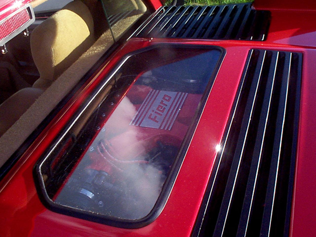

The glass is cut to be about 1/2" larger than the opening. It sets onto the painted surface with windshield adhesive. So flush is not possible with that glass. I am sure Robert would if re-applied the glass the way I had it but might not of done as clean of job I had it.
You might of seen a picture with lexan or plexiglass which I did try flush. Problem with that was heat would warp the lexan out of the adhesive.
Here is an early picture with a rubber gasket. I did not like the bulky look.
Here is an early picture with plexiglass flush mounted with silicone.
Coolant was just green Prestone if I remember correctly.

SkiTime, what kind of vent is that on the rear deck lid? I ended up going to some car shows towards the end of the season when very hot outside and wouldn't mind a little more engine ventilation. That looks tastefully done like it's supposed to be there. Or if anyone has anything that looks just as good, please share. Thanks

Dave doesn't post here very often as he is out of the Fiero hobby. He certainly is a master craftsman .Last I spoke with him at Carlisle he told me those custom vents were made from piecing together parts from the Fiero side vents. Since they might contain magnesium, they can't be welded but Dave said that he used JB weld to hold them together. I found this hard to believe but that's what he told me. If the side vents are aluminum then I can see sections being braze welded or aluminum soldered together. Dave was a shop teacher at a local school and probably had lots of resources available to do custom work.

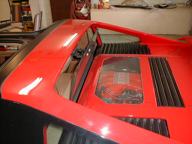

You could also do this engine under glass conversion.
And this is what the underside of the hatch looks like.
