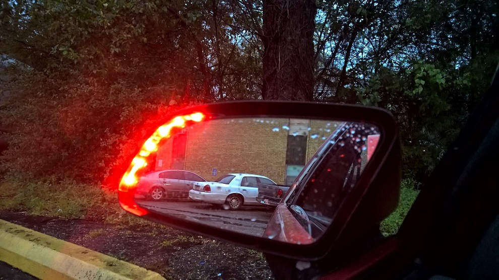

I put lights in my stock mirror that flash with the turn indicator.
You can see it in action in this video:
[This message has been edited by liv4God (edited 12-02-2017).]

liv4god,
very cleaver and ingenious. thanks for sharing.
