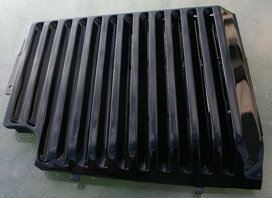

I did this with a quart of black lacquer Rustoleum Gloss Black paint from the Home Depot. I mixed a tiny bit of lacquer thinner into it so it would spray easier through my paint gun. I laid it on pretty heavy. I did not use a top coat of clear. This is the way it dried. I was quite happy with just how glossy it is!
