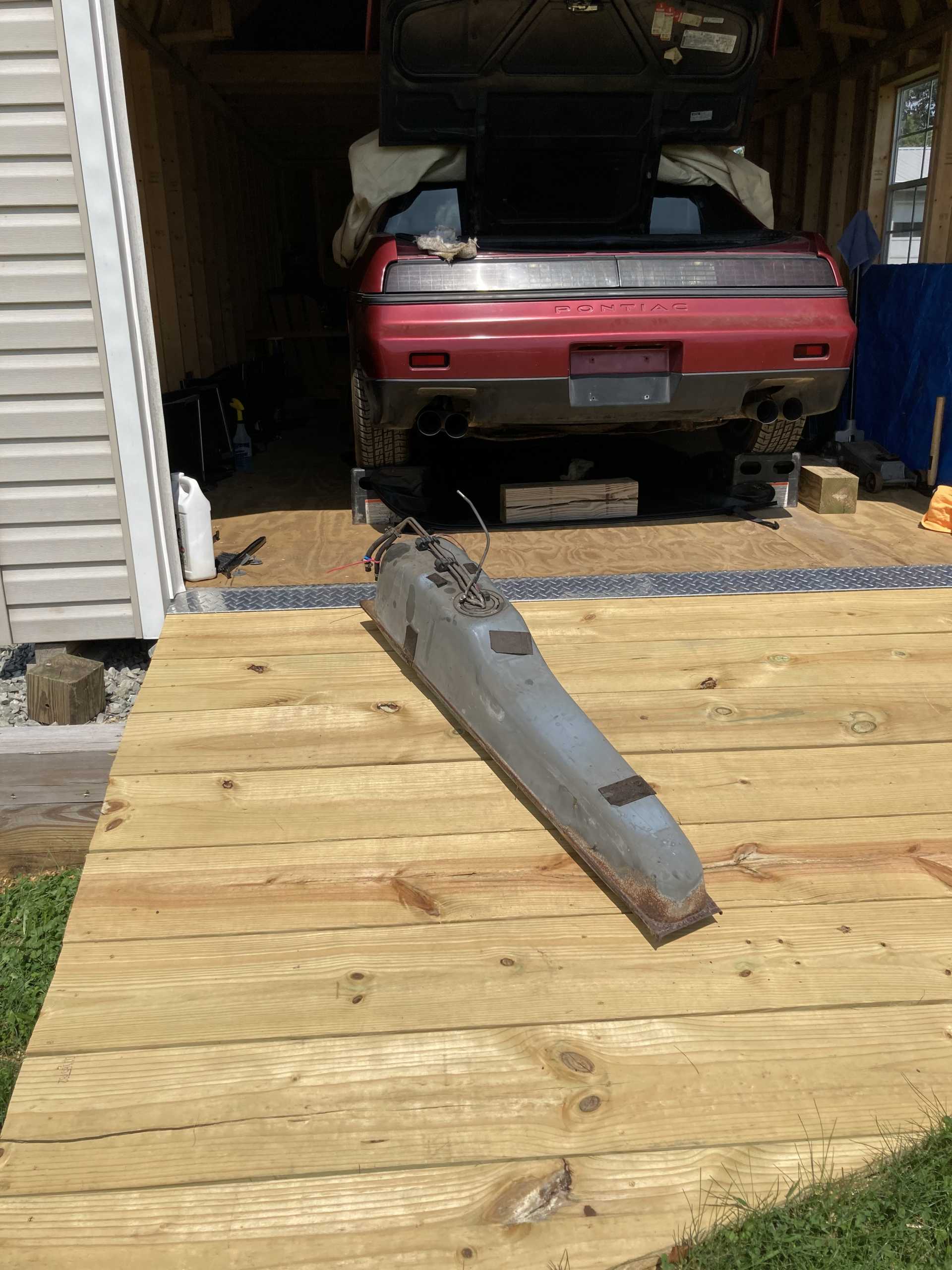

Definitely a difficult job. Best advice I can give is be patient and wear gloves. Mechanic’s gloves, not the sterile nitrile gloves. A lot of sharp edges and not a lot of room to maneuver. Right now I’m deciding if I want to have the tank professionally restored/coated or do a diy kit like the POR15.

I got the gas tank back. Had it media blasted and sealed.
