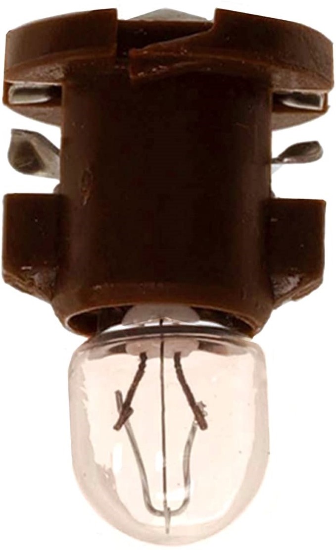

Several bulbs are same format. 74 is rated at 500 Hrs Life. 73 is dimmer but gets 15000 Hrs 37 is middle... a bit brighter then 73 and 1500 Hrs.
I would try 73 or 37, not 74 because of Hrs life.

I have yet to see it demonstrated that an LED can be used to replace this particular bulb which illuminates the LCD display. Is it possible, and if not... why not?

Buy the bulbs here RockAuto ACDELCO Part # 16208443 ....... $5.01

| quote | Originally posted by Patrick: One question I do have though... I have seen tutorials online which show the small bulbs which illuminate the controls being replaced with LEDs. I have yet to see it demonstrated that an LED can be used to replace this particular bulb which illuminates the LCD display. Is it possible, and if not... why not? |
I have to see how works inside to uniform light display. many ways to have back lighting for LCD. Three main issues I think are: 1. Normal bulbs are dimmed more easily. LED in Radio that need normal light bulb would have same problems for LED in dash... Most won't like or hate GM and others dimmer circuit.
2. Normal bulb lights all ways w/o added diffuser. LED as back light w/o diffuser can make one section of LCD bright and other areas dim to dark. (LED Back lights for phones TV etc uses diffusers and/or "light pipes.") Find right LED that light same could be hard.
3. Color Match... Same problem in LED poisoning. Say use white LED... White LED depends how their made. In General, White LED are not same spectrograph as normal bulbs and can have drop outs and still looks white to your eye. As back light, white light can be very bright but is weak at LCD filter color then little to nothing will show thru the LCD. (Quick example... youtube, Some reviews of Cree etc 120vac units have spectrograph as part of video.)[This message has been edited by theogre (edited 11-04-2014).]

It appears that the subminiature bulb used for the ash trays and the auto shifter indicator would work fine if you just carefully straightened the leads. You can probably buy those bulbs for a buck. ------------------ " THE BLACK PARALYZER" -87GT 3800SC Series III engine, custom ZZP /Frozen Boost Intercooler setup, 3.4" Pulley, Powerlog manifold, Northstar TB, LS1 MAF, 3" Flotech Afterburner Exhaust, Autolite 104's, MSD wires, Custom CAI, 4T65eHD w. custom axles, HP Tuners VCM Suite. "THE COLUSSUS" 87GT - ALL OUT 3.4L Turbocharged engine, Garrett Hybrid Turbo, MSD ign., modified TH125H " ON THE LOOSE WITHOUT THE JUICE "
