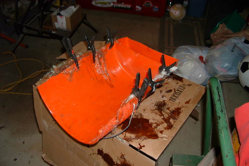

To make the flat pieces, I was going to sandwich the fiberglass between two sheets of glass. To make the curved pieces, I sandwiched the FG between two 5 gallon bucket halves.
Then made the basic shape out of cardboard and matched it to the blank from the mold, traced it out and cut with a Dremel tool.
The hardest part was matching the curvature for the two sides.
The louvres are glued in using the SMC panel adhesive, then blended in with short hair plastic filler.
