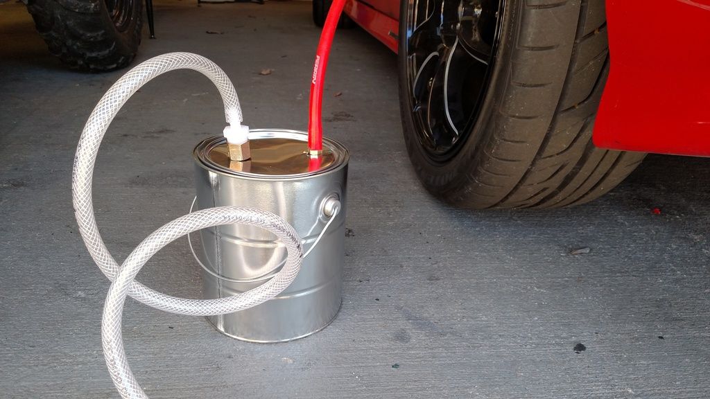

I have been chasing down vac leaks. So I made my own smoke machine. Its really simple and works fantastic!

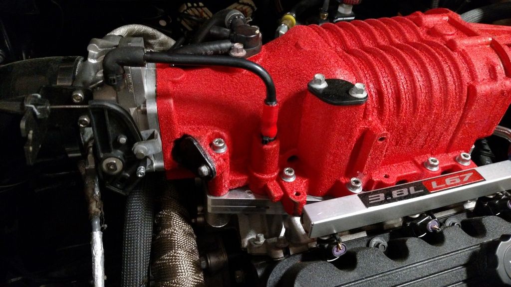

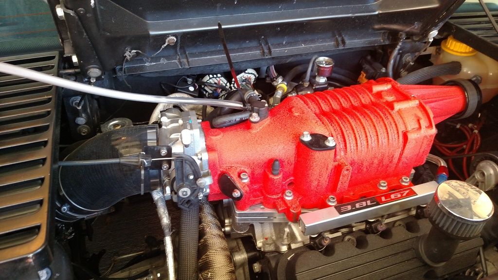

Now I am having a problem with the PCV system. I had to remove the breather filter since it adversely effected the idle. Now I need to add a fresh air side to the pcv system but then I connect it (below) it idles @ 1500 and sounds like a jet through the air filter. Yet this is the correct method for a genV sc w/ N* TB, no?
****Fixed*** the gasket between the SS, SC, and LIM was all wrong. I trimmed it to "port match" the opening for the SS. It didnt like it. LOL Replaced the gaskets with OEM GM 2007 metal gaskets and all is well.

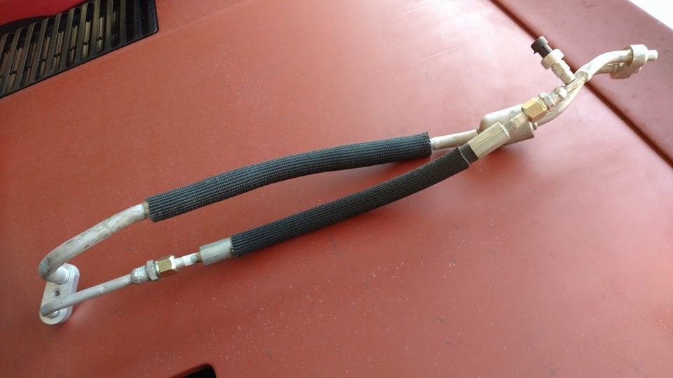

Getting warmer here in Fl. I decided to overhaul the A/C system since its been open to atmosphere for 3 years. I also had new lines made. Trust me, go with 2002z28convert's lines. They are cheaper and a much better design than your local shop will probably make.
