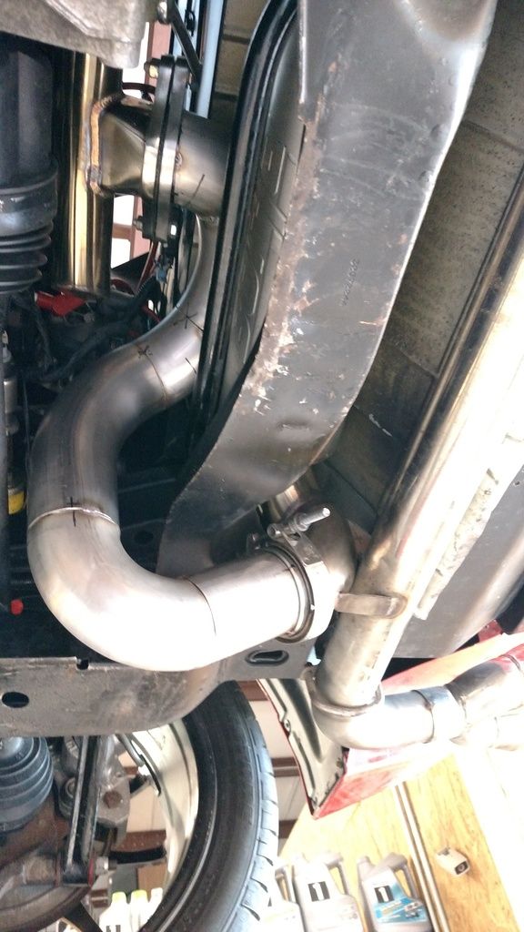

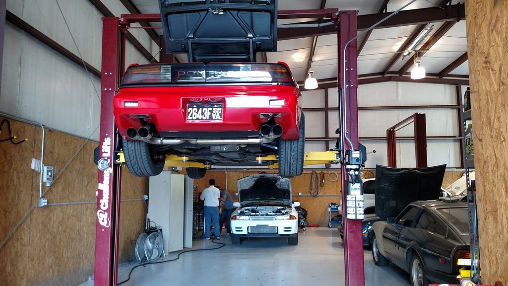

Car goes to the exhaust shop to get the manifolds tied into the 3" borla exhaust as well as a 4" intake (aluminum) and a few other little bits. Be driving in a few days!

Man it's been awhile since I posted in this thread. Sad to hear you are moving on but I understand you do what makes you happy. What diameter is that tube and do you have any pics of the exhaust manifolds? I have been doing a lot of Fabrication and Tig welding work on stainless and aluminum here lately and I enjoy seeing others manifolds. Car is looking good man. Good luck with it.

The manifolds are ZZP units. Other than that, the "downpipe" is 3" mandrel bent stainless.
Car is done, just gott dropped off at my house. I just have to hook up the WBO2 and start datalogging the tune.
