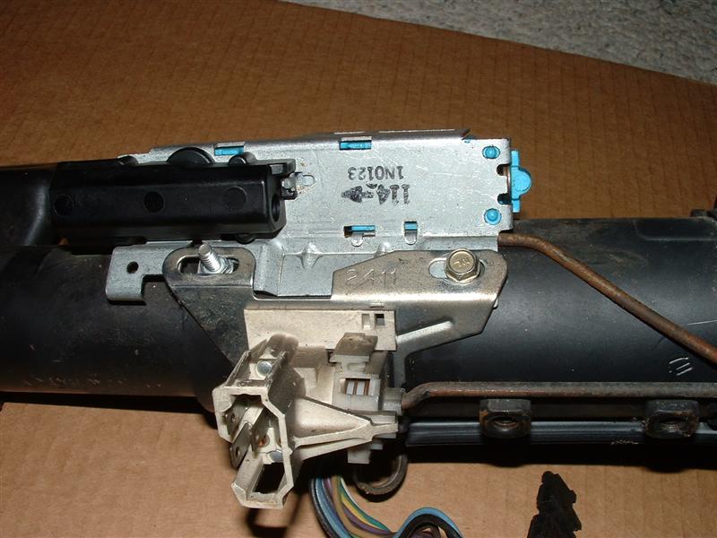

Your starting problem may be in the ignition switch. It is adjustable and if it has moved out of proper position, the 'start' contacts might not always be making contact in an older switch. Or, on manual transmission cars, there is a switch on the clutch pedal that is also part of the start circuit. Finally, there is a linkage in tilt steering columns that can bend.
Rexgirl
JUL 27, 04:28 PM
The ignition switch is mounted on the steering column near your left knee. Here is a pic (thanks Jetman, I think?) of the blue ignition switch with the headlight dimmer below it:
Most likely, it will need to be moved toward the steering wheel
