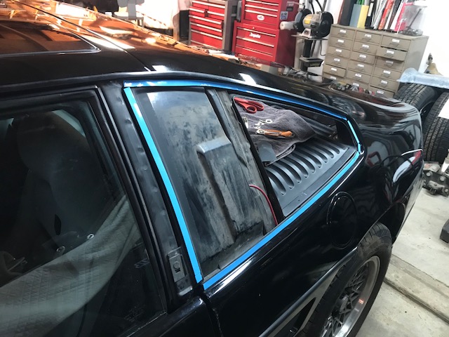

I bought TFS premium quarter windows for it... I'm not 100% impressed. Time will tell. I don't have a picture of the new sails for some reason. They are on but keep unsticking from the tape.

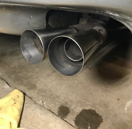

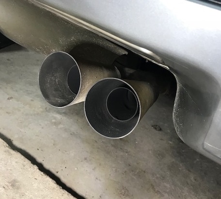

I also cleaned 30 years of crap off the exhaust tips. Here is a before and after(well, left side right side comparison because I forgot a before picture haha). I just got some actual alumnium polish and will work on shining these up more, as well as making the inside pretty too.
You might want to have a look at This thread.
I stuck new sail panels on my '86 GT using the correct double-sided tape and black silicone similar to the method described below. However, I used the black silicone around the entire perimeter of the sail panels (in addition to the tape). The most important area to carefully seal up is the leading edge. You don't the wind catching and lifting the front of the sail panels while you're zipping along on the freeway. Mine are never coming off.
What a lot of people do is just depend on the double sided tape. On any window install, I would recommend the tape plus black silicone. Here is an example. The factory panels have the leading edge directly behind the driver/passenger glass siliconed to keep air from getting under the panels at highway speed. The red lines in my picture is the tape and the blue lines is the black silicone. Note the factory remnants of silicone just behind my drivers side window:
Yikes, thanks for the info! I'll definitely have to look k to securing them better. I would not be happy if I lost one. [QUOTE]Originally posted by IMSA GT:
