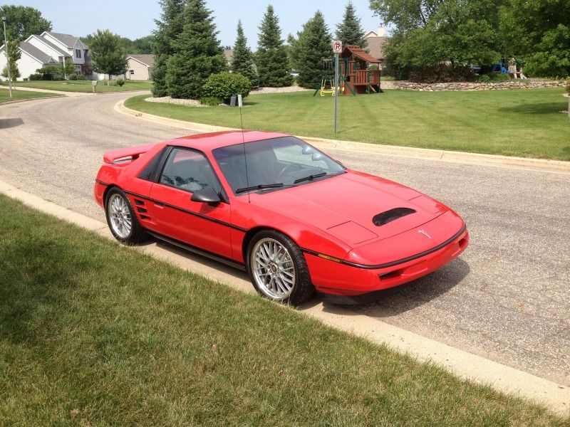

Yeah you will be ok with stock brakes. The ride with them wasn't bad the problem was it was too low with them and lowering springs. My tires rubbed like crazy after the springs settled. That won't be a problem for you since you have front coil overs.
Now that the tail light panel has been on the car a while it has evened out. The curve is better and I was able to adjust the gap more even side to side. I've gotten a few comments on them when I've been driving around. Apparently it makes the car look like something other than a Fiero.[This message has been edited by FieroMaster88 (edited 05-16-2013).]

You have two very nice cars. I'd love to get my hands on either, but mostly the 88.

Damn it looks good! Now you got me thinking I should of went with your style side scoops!
