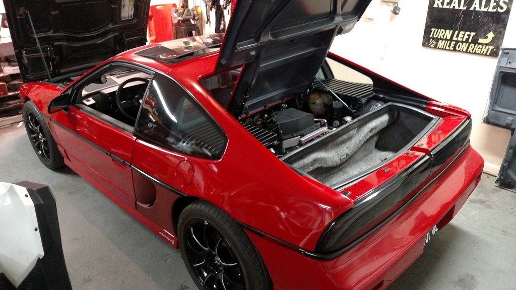

Just tinkering a bit here and there. I am trying to figure out why whe is leaning out up top. I pulled the vac line off the RRFPR and set it to 50psi with the engine running. Once the vac line is back on, its got about 44psi. Now I need to see if I get 65psi at WOT (1# per 1psi of boost). Other than that, dyno tuning is not that much farther out.
BV MotorSports
JUN 02, 12:59 AM

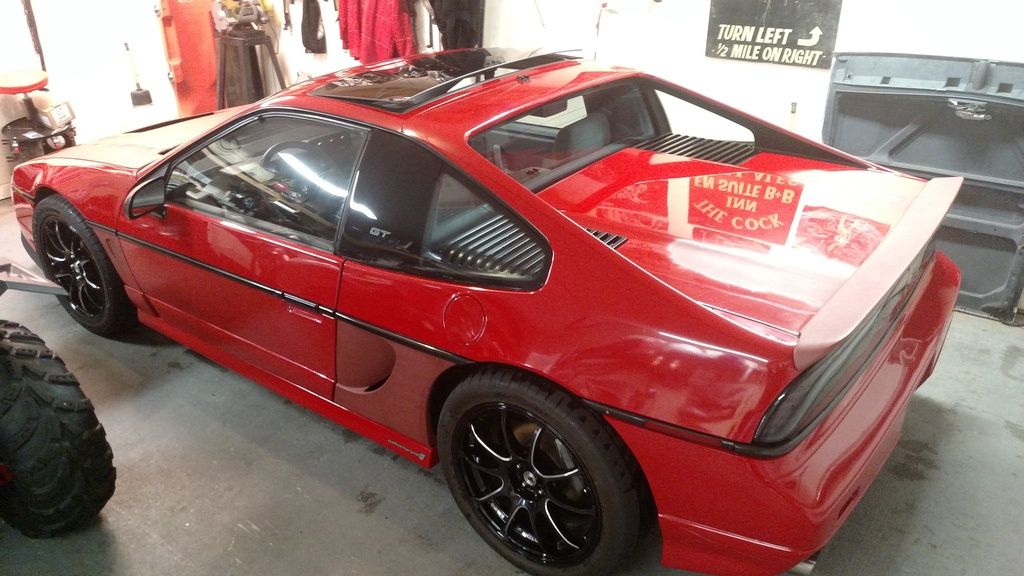

I just picked up an original '82 Mustang hood scoop for the decklid. Hopefully that can help cool off the engine bay a bit. I am waiting on MASE to get back to me when he has an appt available to tune the car. Getting close now!

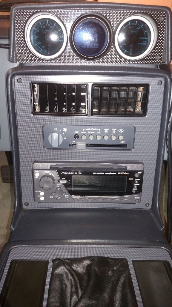

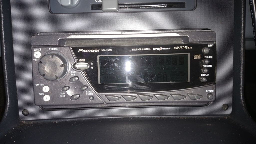

I slowly tinkering on bits here and there. I have and appt with Mase on the 14th to geet thee car tuned. Mase blocked out the entire day for the Fiero. He is keen to get his hands on it! I am working on the AC lines. Its just way too hot not to have working AC here in Florida. I found a guy that likes a challenge and wants to do the lines. RESULT! I love ppl that like a good challenge. Square peg in a round hole are my kind of ppl. My old boss Gary (of Garys Customs) is going to respray the modded panels in stock red. Once thats all done, all it really needs is a new headliner. I picked upa nice 1.5 din aftermarket HU and got that installed during the week. Still sounds like crap but it works.

Added a new headunit!
