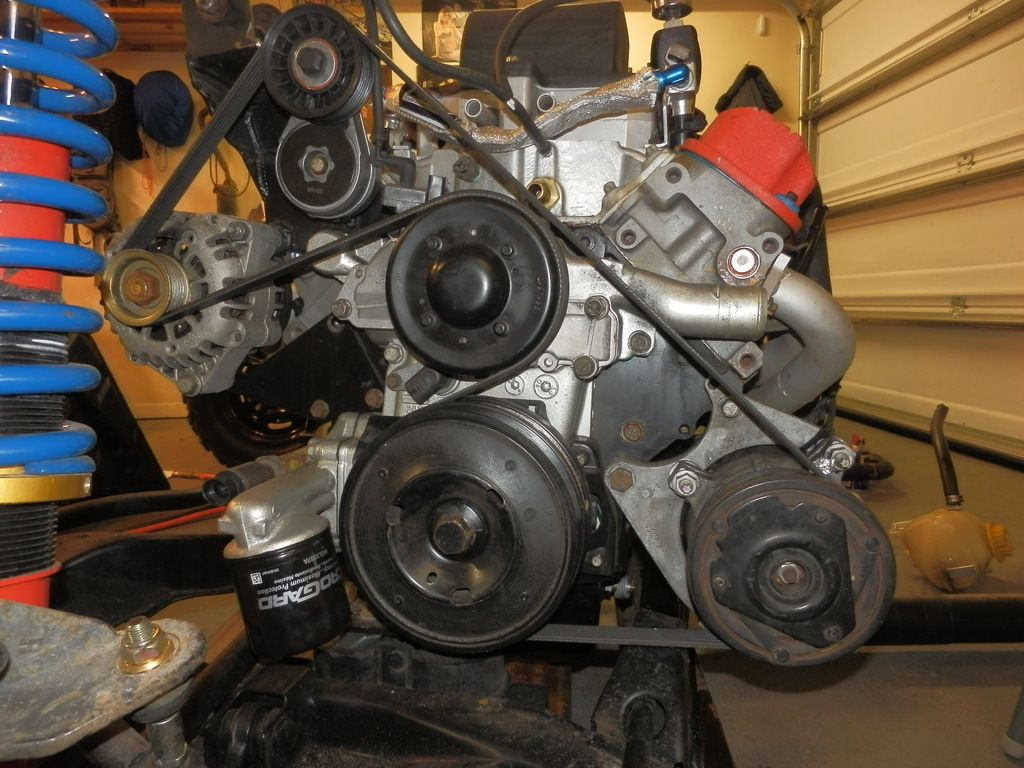

Leaking front motor mount replaced and it was a bit of a pig to do. I found my oil filter housing is leaking a bit. I snugged the bolts up, lets hope that has it. I also had to trim off one of the "ears" on the bottom front of the F23 as it was bumping the cradle under load. I also think my serp belt is making contact with itself on the run from the AC comp to the tensioner pulley. I think it is making contact on that run where its REALLY close to the water pump pulley. I may add a simple idler (non-adjustible) to space it out a bit. And the minor tweaks continue.
Pic of how close the belt is:

| quote | Originally posted by BV MotorSports: ... Pic of how close the belt is:
Too bad you can't rotate the entire tensioner about 45 degrees toward the firewall side of the engine. It would shorten up that hugely long span of belt, and also force it away from the WP pulley. It would also buy you some more room between the pulley and the decklid, if that's an issue. (Don't know that it is.) It would also allow more wrap on the alternator pulley. The negative is that there would be a few degrees less wrap on the A/C compressor. Not that either would be an issue. Just a thought.[This message has been edited by Raydar (edited 05-13-2015).]
Pic of how close the belt is...
This is probably a really dumb question (I don't know that style engine at all, and I don't want to review 47 pages in this thread for a possible answer ), but with that belt wrap... won't the water pump end up being rotated backwards?
