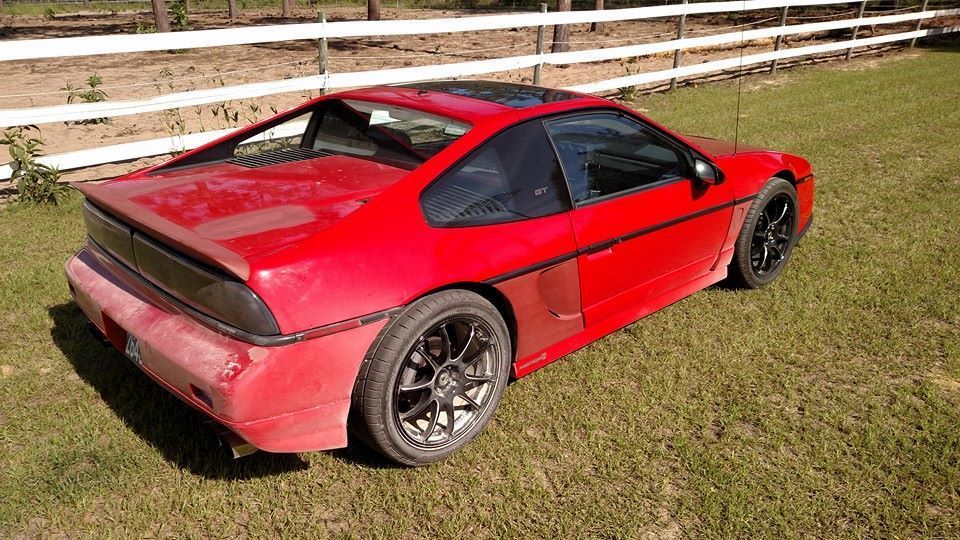

Car is doing great. Though I did find a few issues:

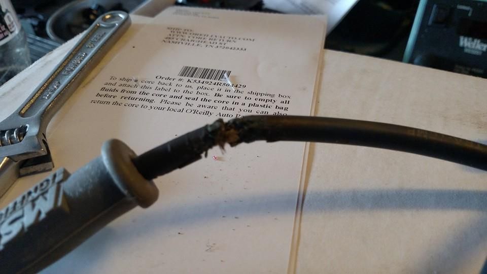

RR caliper is leaking- ordered a new one. Random missfire(s) my MSD wires are junk. Looking for new wires online right now. Battery is dead. Just picked up a new one Alignment is off. She is nervous in the bends Right channel of the stock radio is dead I wired the gauges wrong. They are way too dim during the day. They also stay on if I turn the lights on then off. They wont shut off unless I turn the ign off.
I drove the car about 45min away to the farm. She is DIRTY!!!!!

Formula
MAY 05, 03:08 PM
| quote | Originally posted by BV MotorSports:
AC Delco
BV MotorSports
MAY 08, 02:05 AM
Might be why I was getting missfires!
FieroMaster88
MAY 08, 07:30 PM
Naaah, that looks ok.  [This message has been edited by FieroMaster88 (edited 05-08-2015).]
eph_kay
MAY 09, 10:44 PM
I have heat cracked many sets of wires on a 3800sc swap I had with some headers, and i didn't even drive the car that hard.
I swapped over to taylor monster 10.8mm wires I think, they were build your own style and worked great, they might have been 12mm if that is even offered I went with the biggest I could get to help insulate from the heat, and then used the fiberglass heat shields on any place that got really close to the headers. They were weird equal length headers that weren't built with a simple plug wire route in mind.
Good luck on fixing that it shouldn't be too bad, 3800s run a lot better without heat cracked wires

BV MotorSports
MAY 10, 01:25 AM
I got a set of Taylor Spiro-Pros. They seem to be working pretty well. I took the car to its first meet tonight. Everyone loved it. What a GREAT night. Man this has been a long time coming. The car is running AWESOME!!!!
