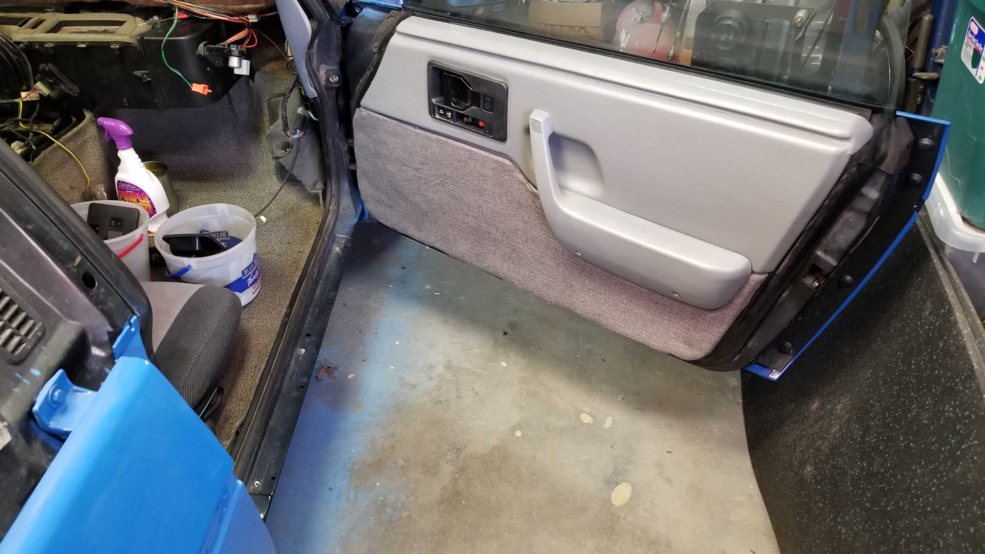

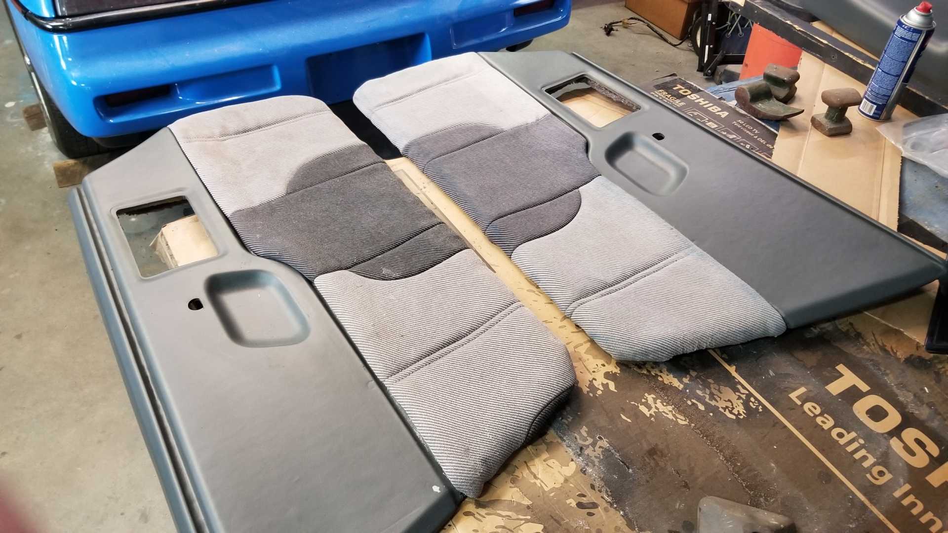

Finished using the Camaro seat material for the door panels, put the panels in the car and decided I didn’t like them, so off they came.
As I’ve mentioned before, one of the seat covers was badly faded and you can see that in the photo. The material is difficult to work with, since it’s three or four layers, including fabric and padding. The seams also make it tough to handle. It was difficult to get it cut to the right shape and to get it to wrap around the panel. I ended up with some differences between the two panels.
On the plus side, I like the texture of the fabric and the thickness it adds to the panels.

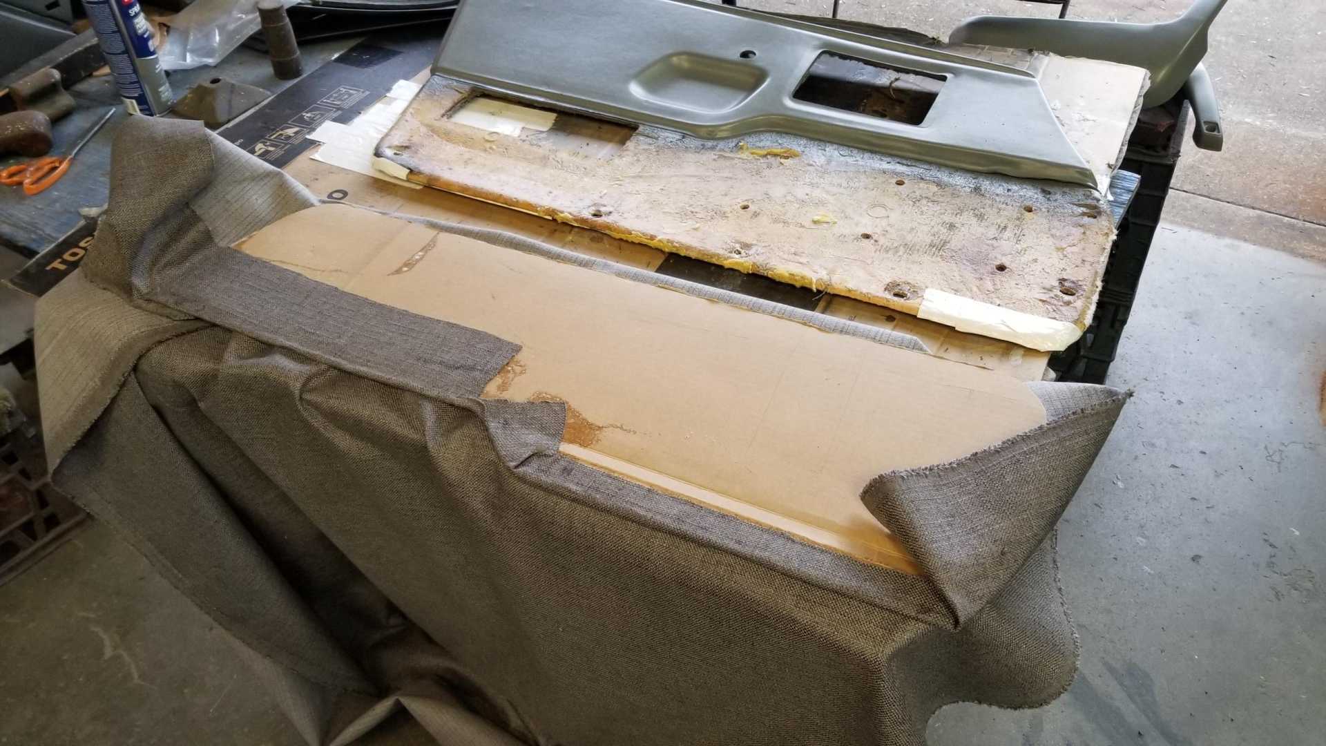

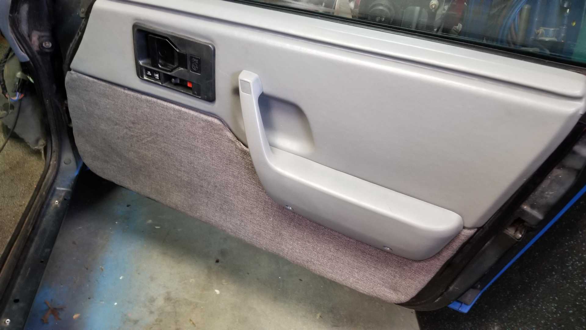

My wife and I were out shopping a couple weekends ago and made a stop at Hobby Lobby, so I looked through the fabric department for something to use. I found some grey fabric that I like a lot. It’s very rough, almost like burlap, and it was cheap. I got two yards for about $16.
The stuff is easy to work with and since I didn’t have to worry about seams or any designs, cutting it was a breeze.
I wrapped the top edge around a piece of cardboard, glued the cardboard to the panel, then glued the fabric to the back of the panel. Doing it that way caused the fabric to be loose on the front side.
My plan is to pull this off, then glue the fabric to a piece of carpet padding, then glue the padding to the panel. Might get to it today.

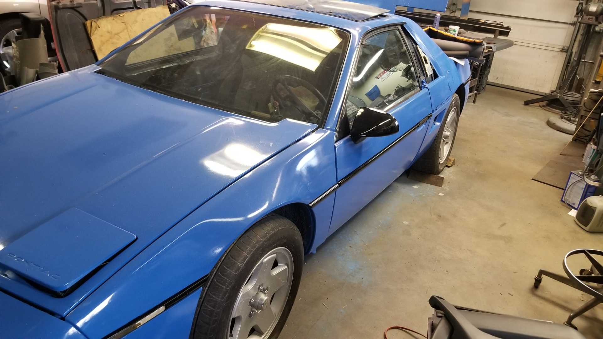

For months I’ve been set on wet sanding the car one more time, then carefully washing it, then installing all the trim. That changed when I got fed up with the lack of workspace. So now I’m installing everything I can and organizing the spares so I can get them out of the way.
As a result, the car looks like a car now. I’ve installed most of the molding as well as the mirrors. I also installed the deck lid lock so for the first time in years I can actually close it.

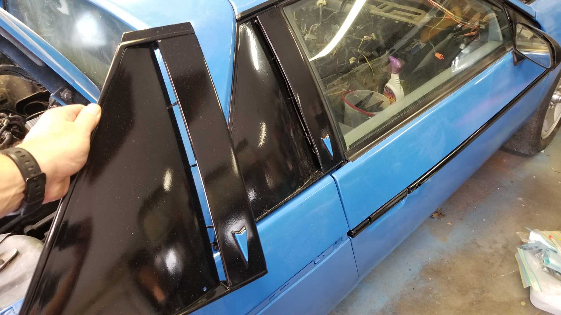

I sanded and painted one of my sets of sail panels, but the left one had some kind of contamination on it and the paint kept bubbling up. I finally gave up on it and grabbed one of my other spares (I have four sets). I then spent several days sanding and painting it, and then installed my other homemade blue Pontiac logo, only to realize I’d grabbed a right hand one instead of a left hand one.
I know I’ll be able to laugh about this at some point, but the timing was pretty bad. I have so many spare parts, nuts and bolts scattered all around the shop, it’s been very frustrating to complete simple tasks.

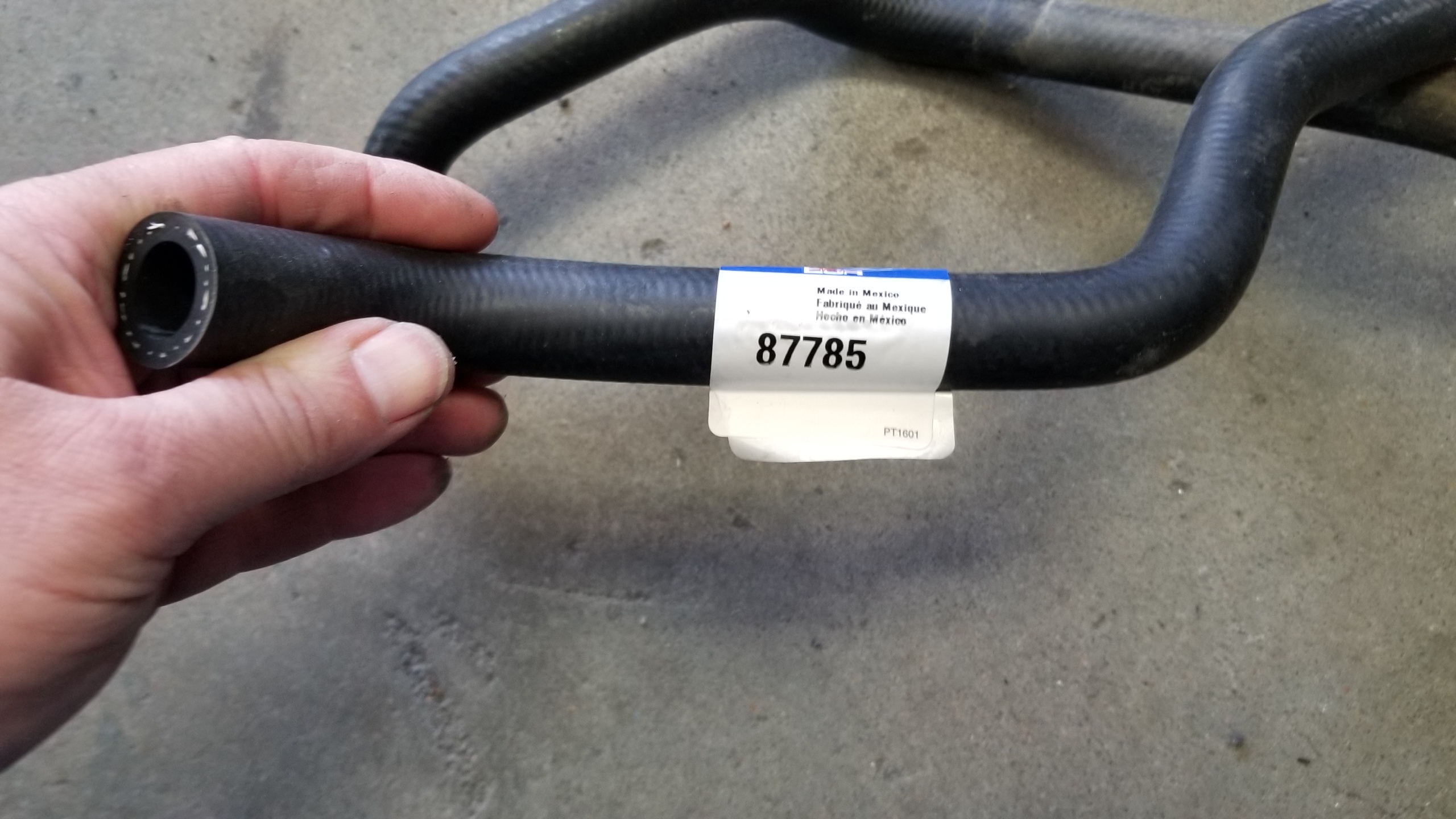

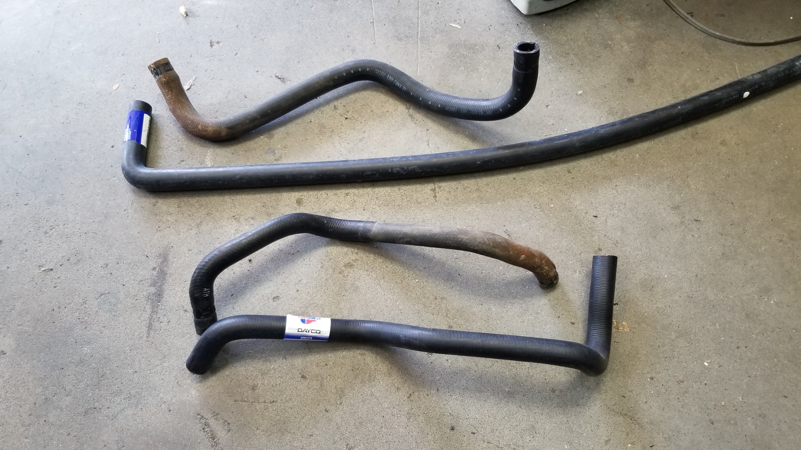

I had to cut my heater hoses to remove them so I could change the heater core. Turns out heater hoses for 1987 4-cylinder AC-equipped Fieros are hard to find. Rodney Dickman says his ‘88 hoses will work, but I wanted to see if I could find another option. I went to Advance Auto Parts then to NAPA and asked the guys if I could look at their stock and find hoses that were close enough to work.
NAPA had a whole ROOM full of heater hoses, but the closest one I could find to the larger hose was one with just a single 90-degree bend. It won’t work, because the turn to the tube under the car is just too sharp.
At Advance, I found a hose that was pretty close to the smaller Fiero hose. All it needed was about four inches cut off one end. This is the part number.
I ordered the larger one from Rodney Dickman today.

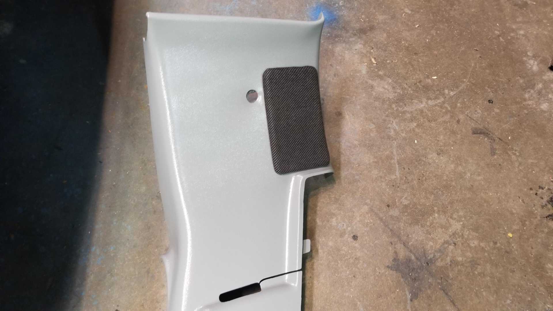

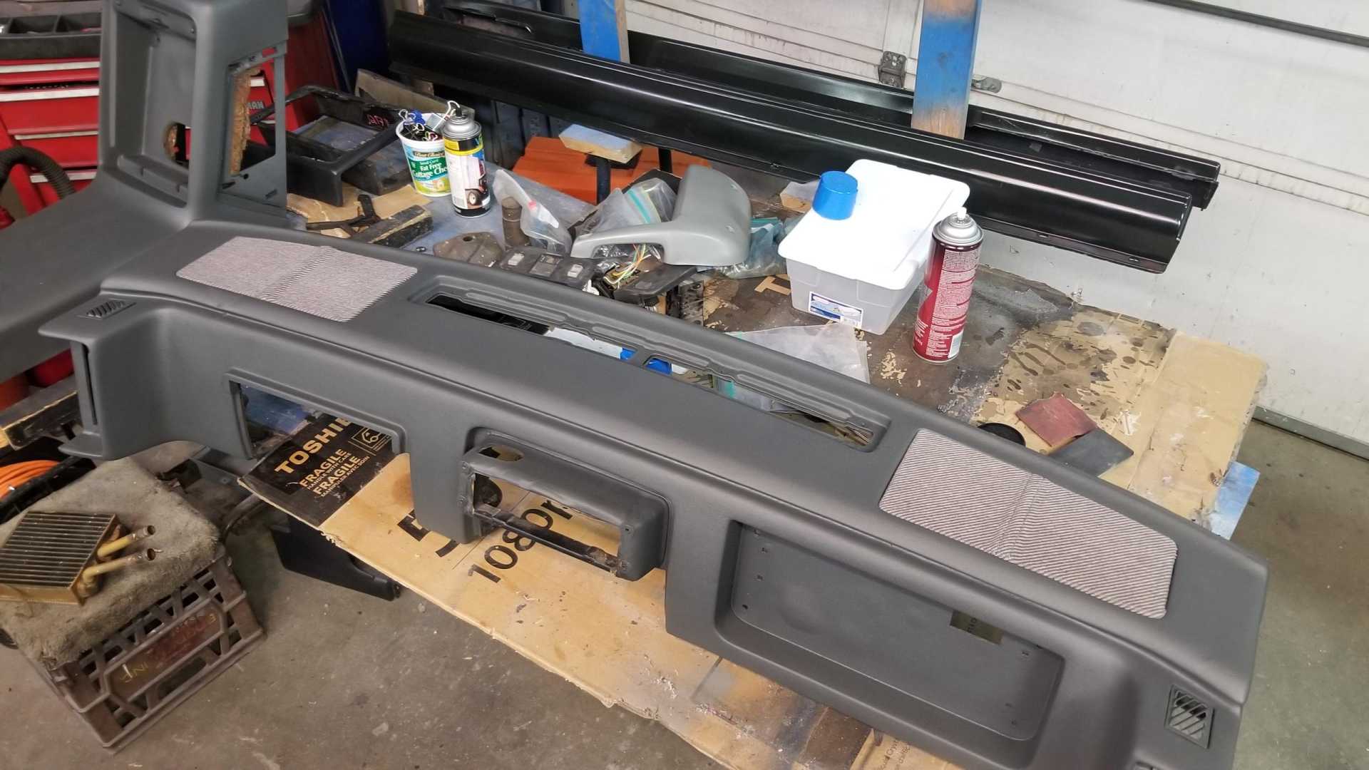

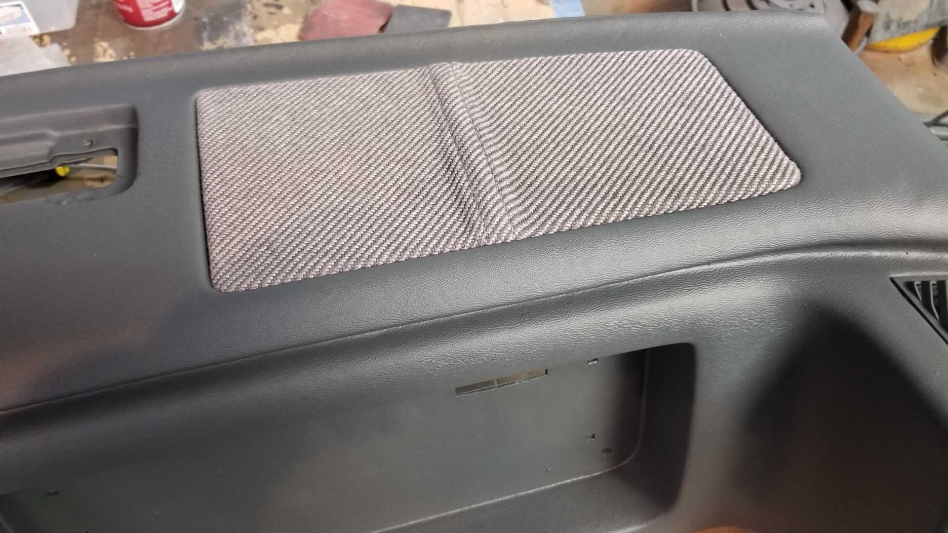

This week I tried a little experiment with the leftover Camaro upholstery. I used some of the light-gray material to re-cover the front speaker grilles, and the darker gray for the rear grilles.
I didn’t have pieces of the light gray big enough without a seam, so I just made sure the seam was the same on both front grilles.
[This message has been edited by Quadfather (edited 03-01-2020).]
