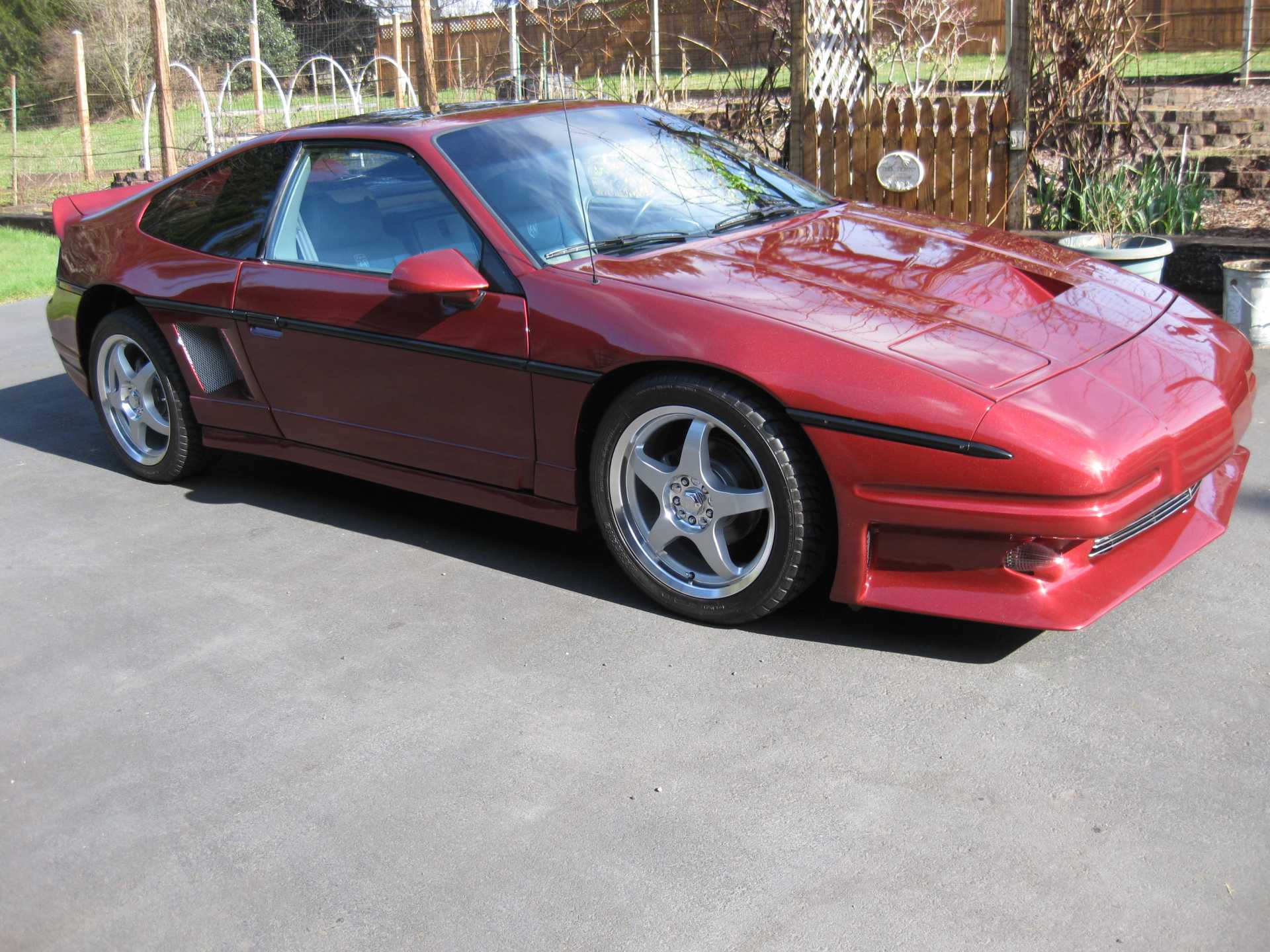

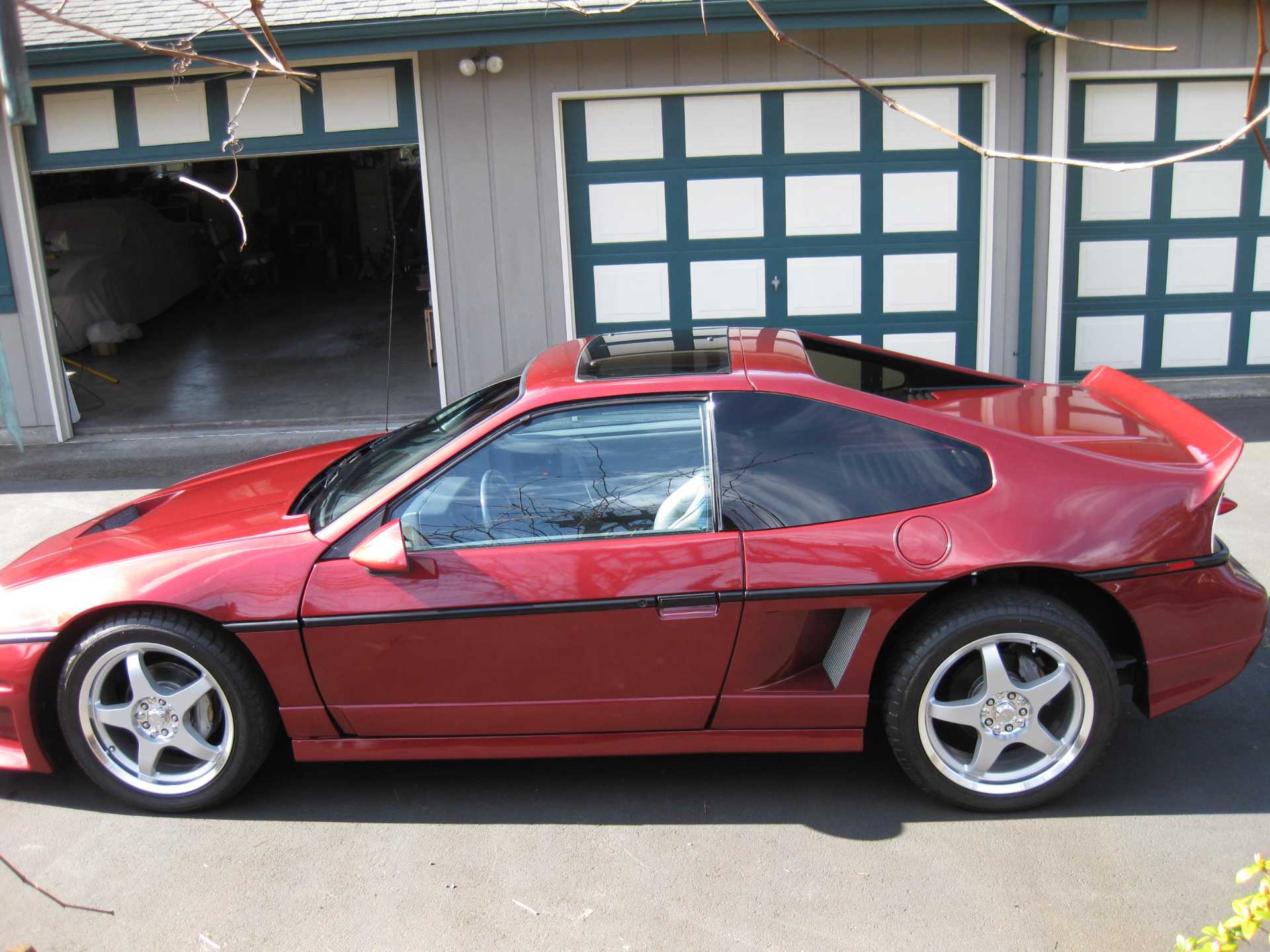

We just returned from a warm weather vacation, trying to break up our wet and gray Northwest 6 month winter rain fest. Before heading on vacation we attended our local school fundraiser and I won a silent auction for an all wheel alignment. Only problem is the shop is about 45 miles away and will probably drive it there. Not a good start for new tires. Anyway, we returned to sunshine(for one day) so I just had to pull the wide body out for a couple more photos. But, while out in the direct sun for only the third time since paint, it developed a small blister , you guessed it, right on the front facia where we had a problem on the first color coat and had to do a repair. Man, this car has been frustrating at times. After the rant, I will bore you with a few more pics.
Sorry for the last year grape vines getting into this shot.

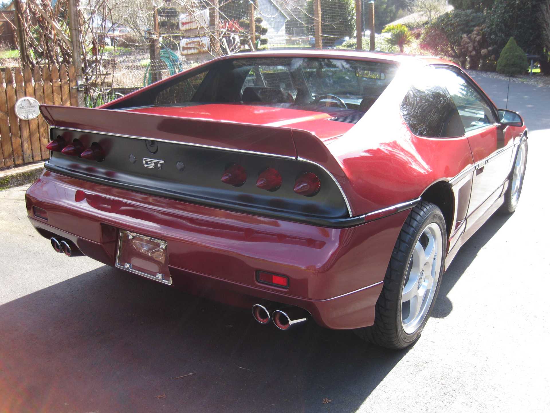

The finished rear shot, first time taken outside.
In this picture, when I zoom in, I can see the developed blister on the facia about 8 inches left of center in the vertical nose area. Less than ten minutes outside, not a good sign. At this point it was only about 3/8" diameter, but it assuredly will grow with time.

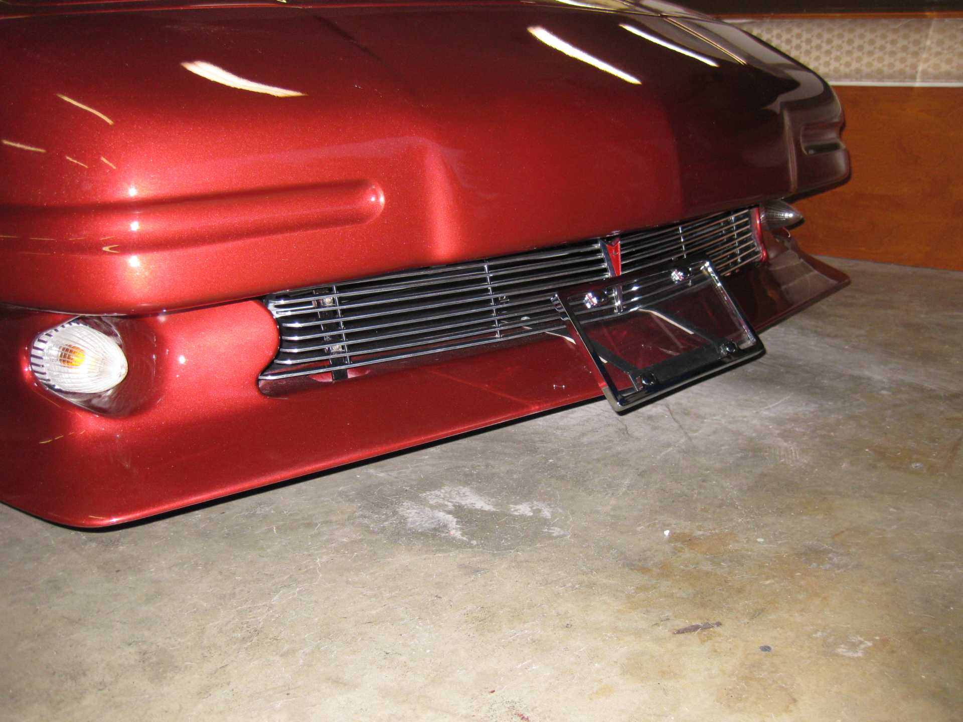

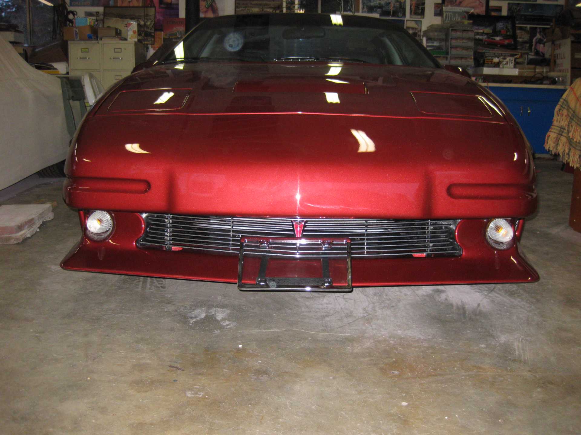

Thanks again for the positive comments, Rick. I finally got the front license bracket made up. Still looks like a mini snow plow, but Oregon requires a front plate. Researched retractable plates, but would not fit into the opening for the grill/intake area. So if I put it under the facia, I would lose over an inch of ground clearance which is only about 5 1/4" at best. Waiting for the weather to break so I can drive it to licensing and alignment. On another note, we got home from a vacation a few weeks ago, and two of my friends arranged for me to be "given" a 2004 Chrysler Crossfire because they could never get it to run. Pretty sure I need another project!?? They had owned since 04 and it hasn't run since 13. Can't believe someone wants to give another person a car. They figured I was the only guy in the car club that would mess with an orphan car made in Germany.

Man, that front tag IS gonna suck, totally disrupt your front end design. Just a FYI: maybe Sema/san(sema action network) is working in your state to change some of those dumb laws, perhaps your club is involved? Only we can protect our hobby/car collections/projects/parts cars. Your build is fantastic. The Crossfire(Mercedes) were neat rides, not many left around either. Could make a good beater. Best of luck.

Looking good sir! check out the sto n show removeable license plate bracket. My buddys machine shop makes em for a retired air force guy who started the company. Sorry to hear about the bubble in the paint, hope its small
