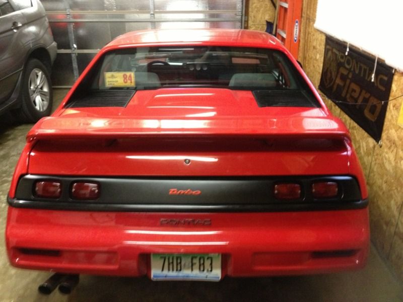

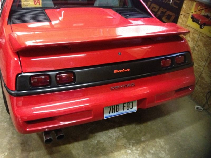

Installed:
Not 100% happy with the fit. I have to get some different bolts and try to tweak it a little. It's not very contoured to the car. I need to figure out a way to get a little more of a bend to it. Opinions?[This message has been edited by FieroMaster88 (edited 04-12-2013).]
BV MotorSports
APR 13, 07:56 PM
Those look AWESOME!!!!!!!!!!!
We used to do a little trick when I worked for Gary's Customs back in the day. If we needed to tweak a panel like yours, we would put it on a table. Prop up both ends and put a weight in the middle (to apply pressure) and then turn the heat up and let it bake in the booth. You'd be surprised how much you can adjust this way.[This message has been edited by BV MotorSports (edited 04-13-2013).]

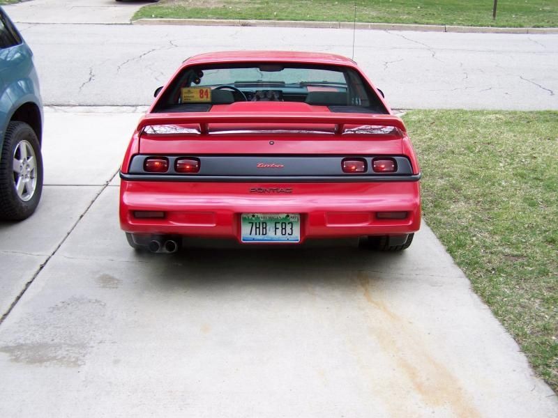

It looks better today. Looks like its gotten some curve back to it. Ill adjust it a bit after its been on there a few weeks. A picture with a real camera from today:
