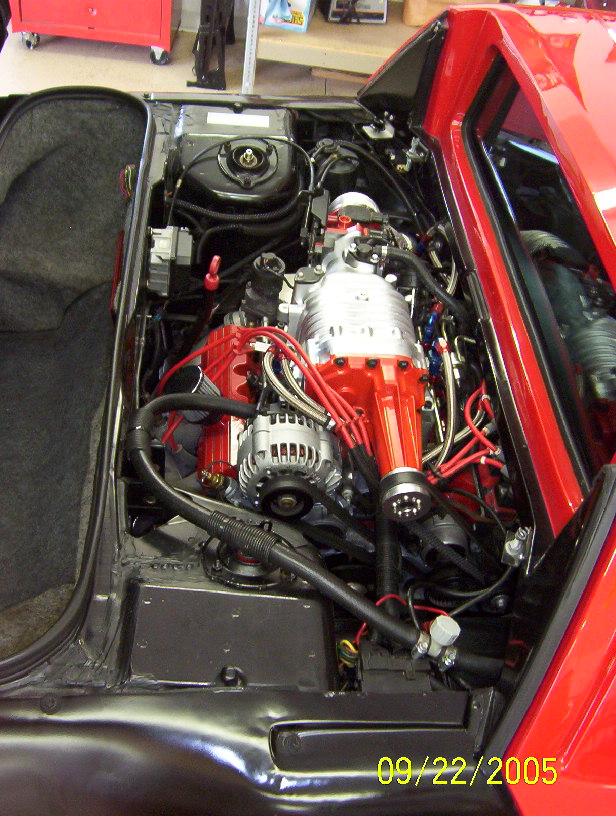

Don Kraus MAY 06, 11:14 AM
It's been 15 years since I completed it and 16 years from when I started it,so my memory isn't real clear.But I know I removed the coil bracket that had the idler on it and made a bracket to hold the coils and that was bolted to the exhaust manifold bolts.Then I used the bolt hole from the bracket in the front of the head or another empty bolthole in the head, and bolted the idler to it that I took off the coil bracket.You may have to shim it to get it aligned and you will need a different length belt.The belt will end up being close to where it comes around the spring loaded adjuster pulley.You may need to get a different diameter pulley,I just don't remember,sorry.You will want to mount the coils somewhere other than the back of the motor,it will make life easier.They can go anywhere.
Here's a picture of it,you may see enough to help.It's the best I got.
Over the years I installed two 3800's and a 427 V8, all with the 4t65e auto transmisson.None of them required cutting the spaceframe or anyother part in the engine compartment.
Hope this helps,good luck with your project.
