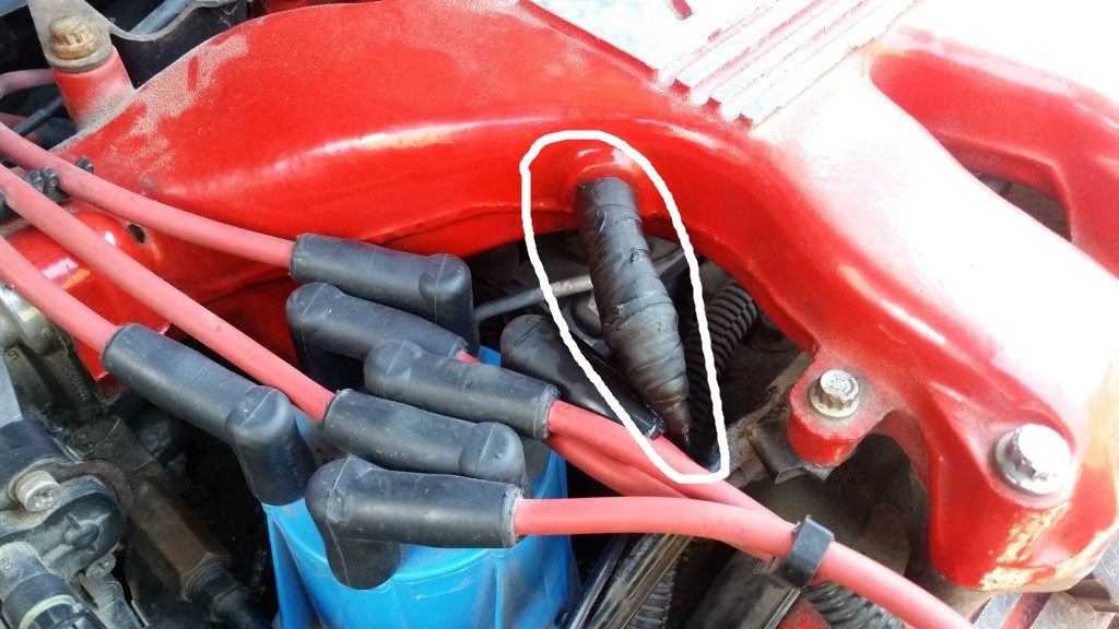

Here is the leaking part..
What is it called ? ..this one is obviously fixed with what we call "vulktape" in swedish..
And just to be clear on my cooling fan problem, it does not start when I start the AC either.

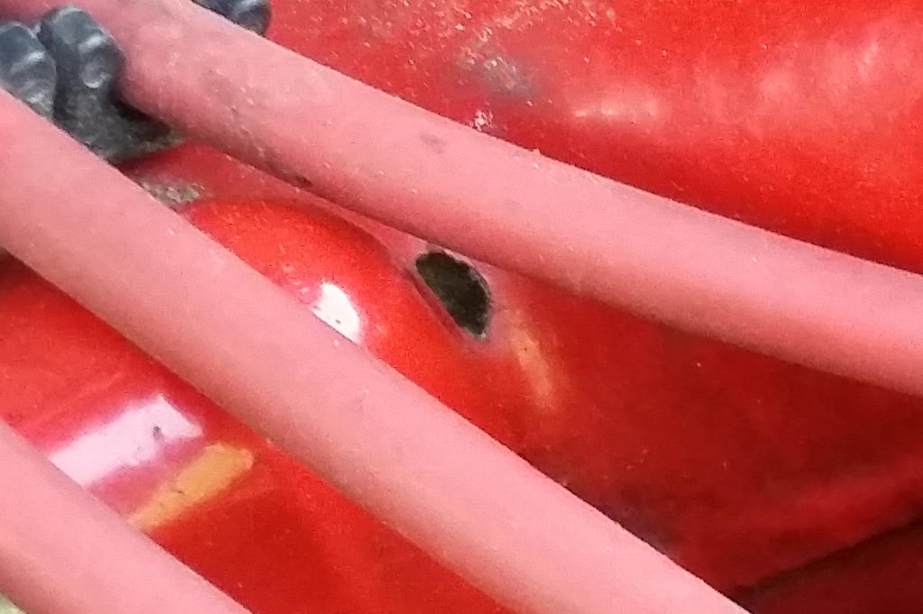

What is that thing that looks like a hole on the intake snorkle, by the spark plug wire?

tshark: You mean this one ?
I have NO idea, it sure look like a hole ? but might be dirt or soemthing ? ..I better go and look tomorrow, I sure didnt see anything when I was there..

| quote | Originally posted by tshark:
Is there a 2.8 upper intake manifold that doesn't have that?
Every couple of months, somebody asks about it here. It has something to do with one of the holes used for the TB mounting bolts. What you see there does not go through into the intake manifold.[This message has been edited by Patrick (edited 07-09-2018).]

Correct, I checked it this morning and it is a pit, not a hole, must be from the casting.
Funny I didn't notice it before, anyway its not a problem

Wow...so many questions. Okay first, if your radiator fan does not come on even with the dashboard AC selector turned on, then your fan motor or the wiring to it has probably failed. Next, your idle RPM's are very close to typical, and I wonder if your tach is reading completely accurately. Mine reads an unwavering 1050 at idle and I seem to have no vacuum leaks (famous last words..). The new Cardone replacement distributors: The members here have reported they sometimes come with little to no electronic heat transfer grease/paste under their ignition module and consequently those ICM's do not always last for long . You can add more grease of course, but it's said that removing the ignition module will void the warranty (not a problem if you don't wish a replacement). Others here talked of the pick-up coil wires having polarity, so I just passed that on..sorry if that isn't true. If you wish, you can temporarily run a hose from your vulktaped manifold tap directly to your black plastic vapor (EVAC) recovery tank (between the driver's side strut mount and air filter). It's the smallest tube. Also, if you are spraying for leaks, there are four nylon vacuum tubes that are a bit hidden. Two are directly under the throttle body and one is behind them at the back (the cold start injector air line), and one near the EGR tube's plenum connection.
