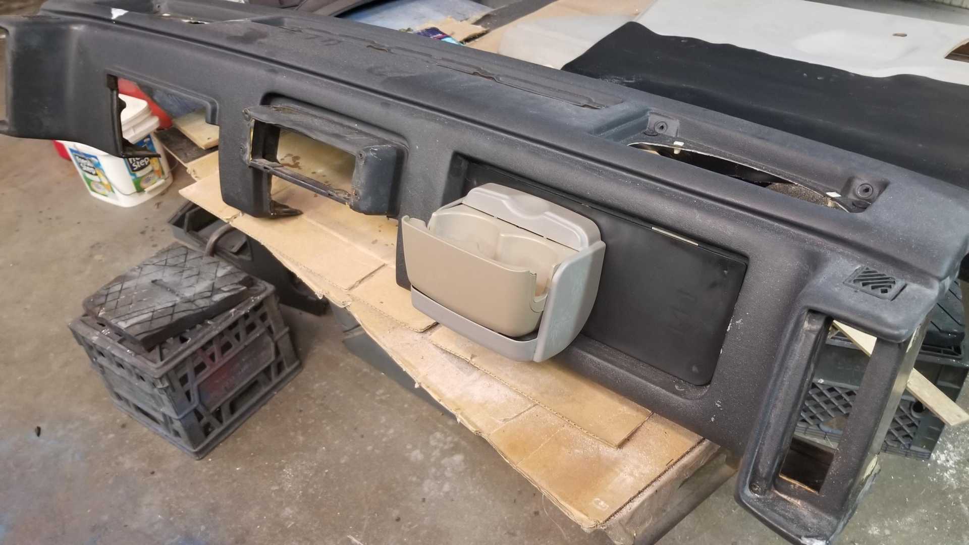

The project was delayed because I had to replace a window regulator on my wife’s Grand Prix. I’ve been trying to come up with a good idea for drink holders for the dash, and yesterday while driving to the salvage yard I had an epiphany. I realized the drink holders from a 2002 LeSabre would be perfect. I know this because my daily driver is a 2002 LeSabre I inherited from my mom.

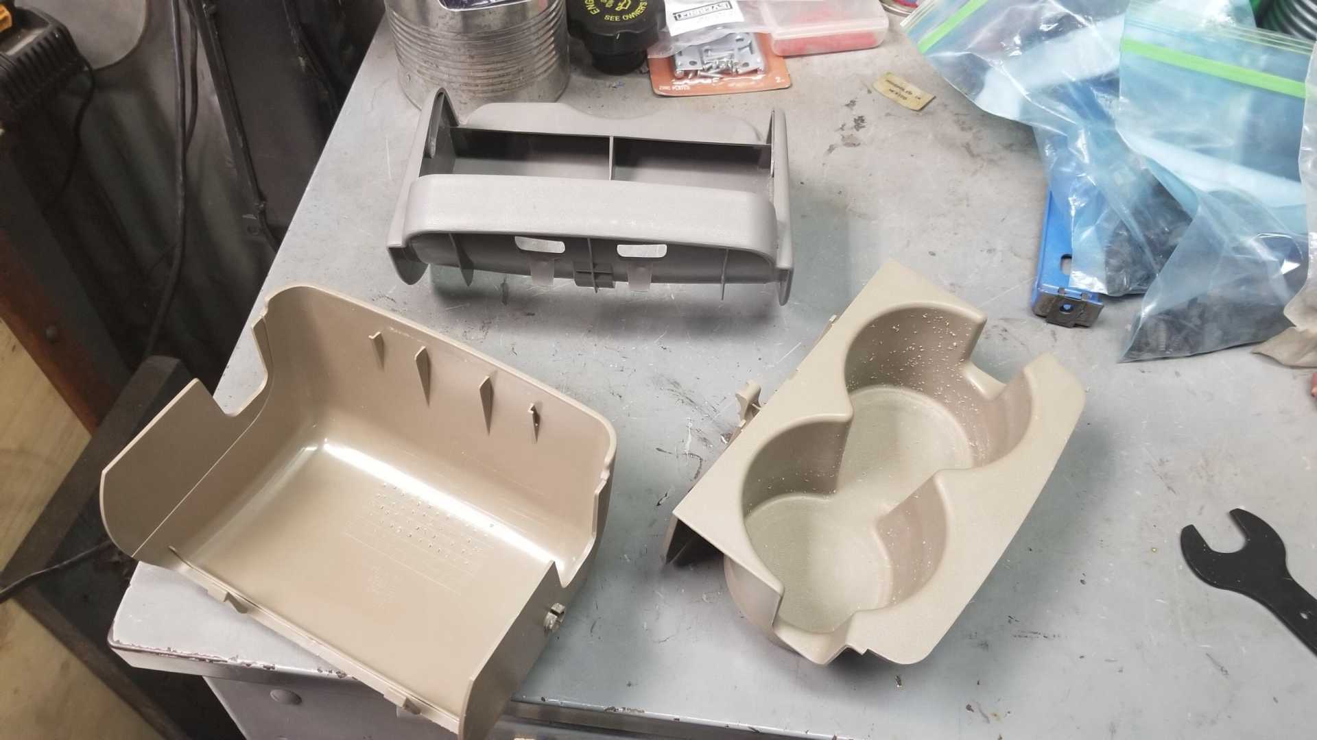

The LeSabre drink holder is attached to the front of the fold-down armrest. Once I got to the salvage I checked it out and saw that it pops right off and has a flat surface on the back which would make it easy to attach to the Fiero dash where that bizarre pocket thing is. My car had the even stranger half pocket, which was ripped and ugly.
Another plus for this drink holder is that it disassembles, making a change of color easy to apply. I bought the best parts from two different salvage yard cars, which explains the different colors in these photos, for a whopping $8.
This afternoon I played around with some two-sided tape to see where I should install it on the dash.
I like the way it looks. I’m thinking I’ll cut a piece of plywood to fit in the recess of the dash, then fiberglass it and sand it smooth, then attach the drink holder with two small bolts. I plan to paint the dash and drink holder Rust-Oleum smoke gray.

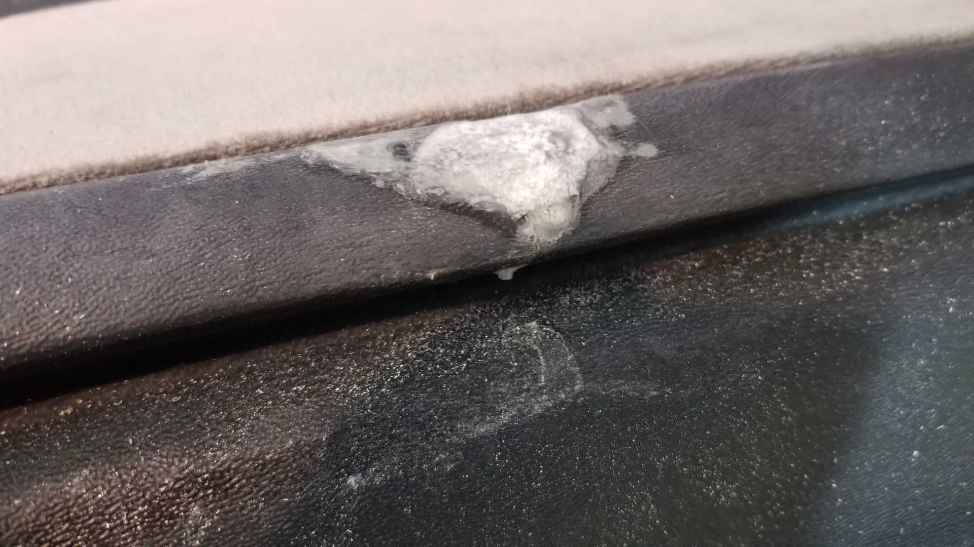

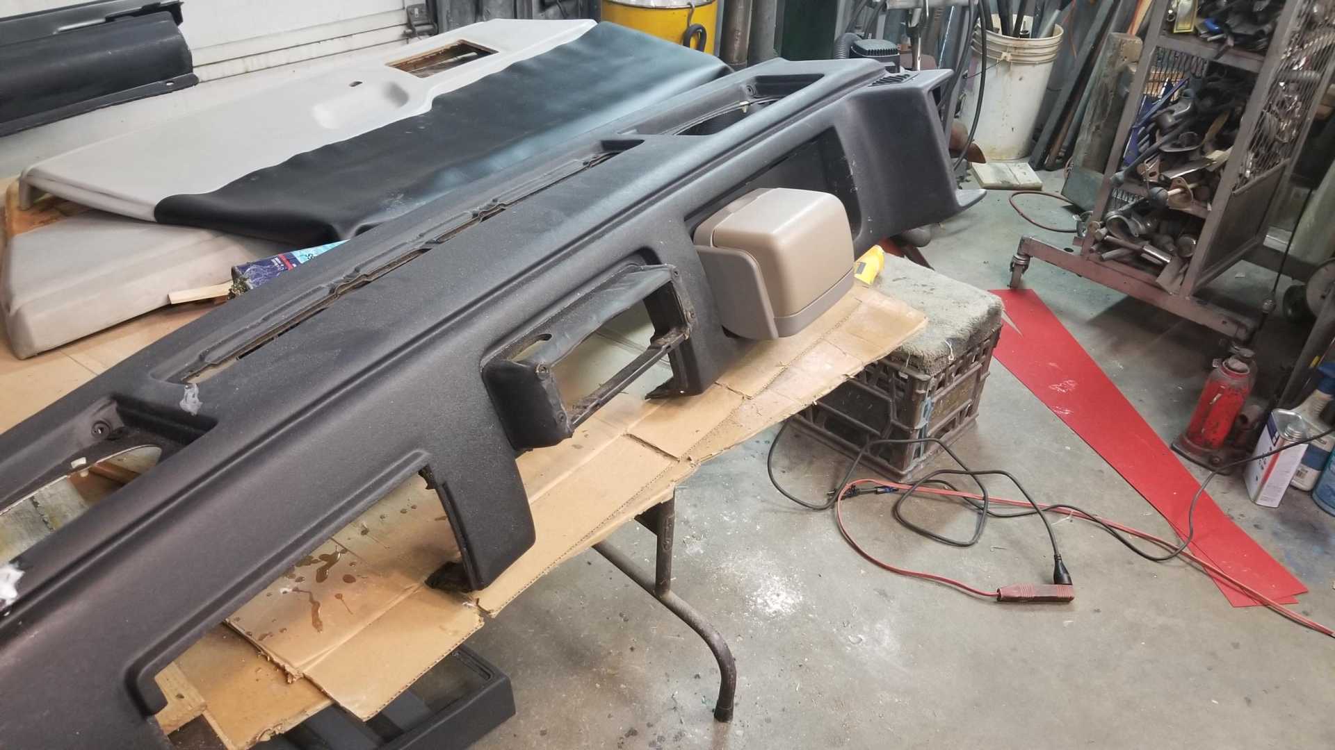

Five years ago, before discovering the compatibility of 4th gen Camaro seats, I was planning to reupholster my factory seats, so I bought a bunch of fabric. Today it was too cold to open the shop doors, so that meant no spray painting, so I tried using some of that fabric to reupholster the speaker covers. The fabric is velour so it’s probably not the best choice, but the process turned out to be so simple I can find some better fabric and do it again.
That white blob on the dash is a repair I’m working on. I must have dropped something on the dash while I was working on the door panels, because there was a golf ball-size impact point there. Hobby Lobby sells vinyl in a tube, but the cracks are so bad I’m having to layer the stuff on. It appears to be working, but still needs a few more coats.

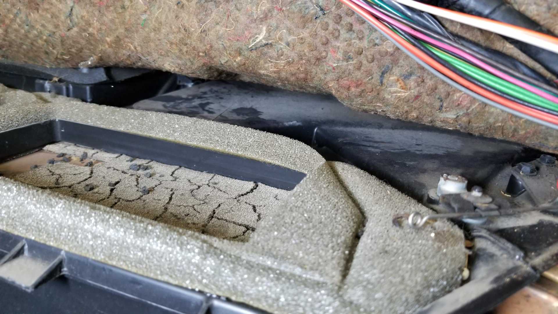

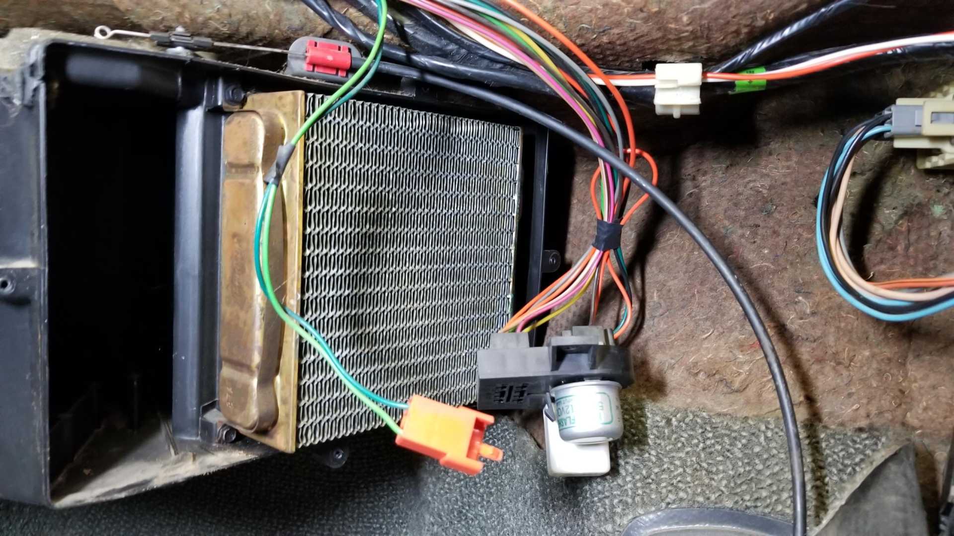

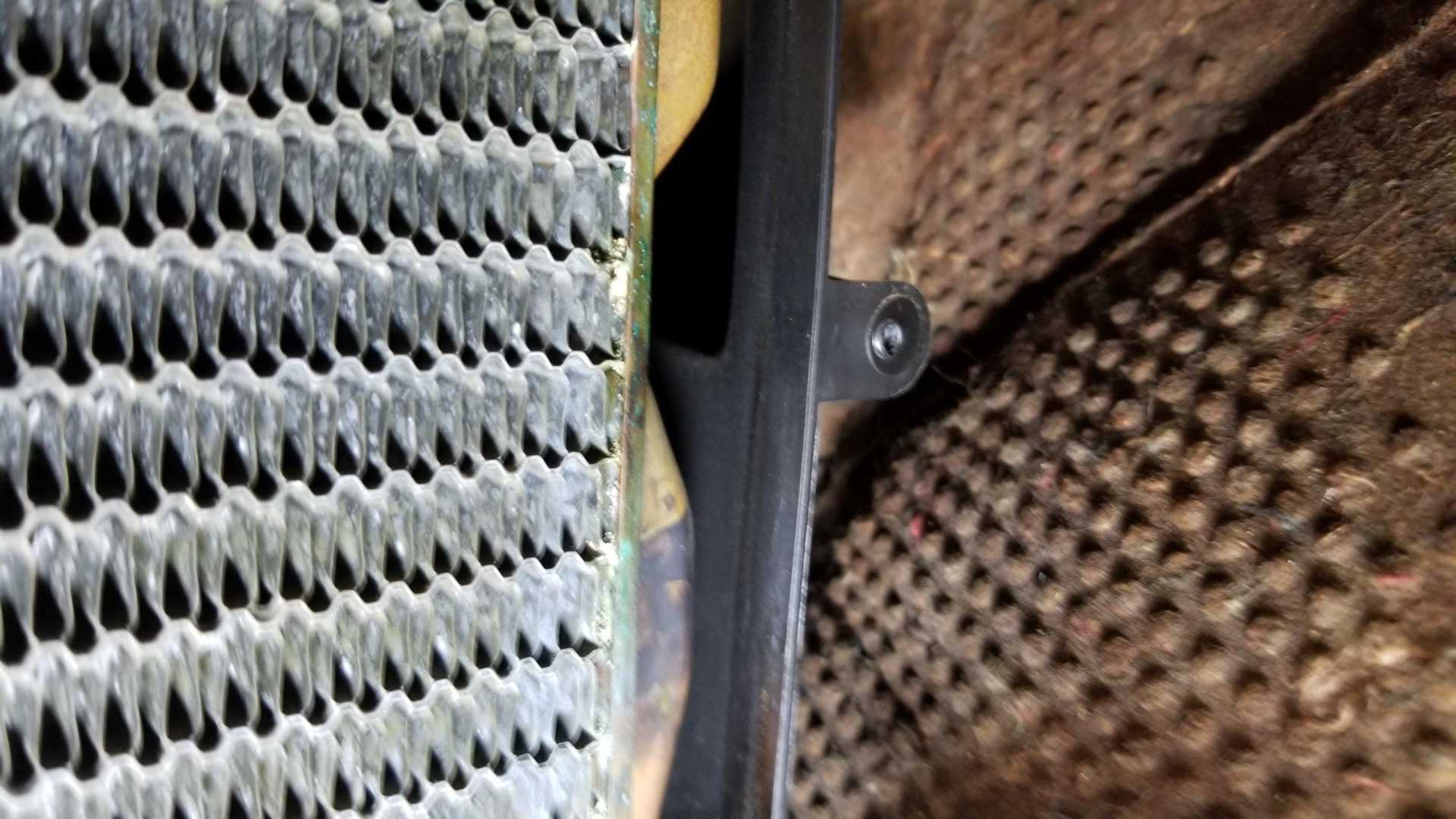

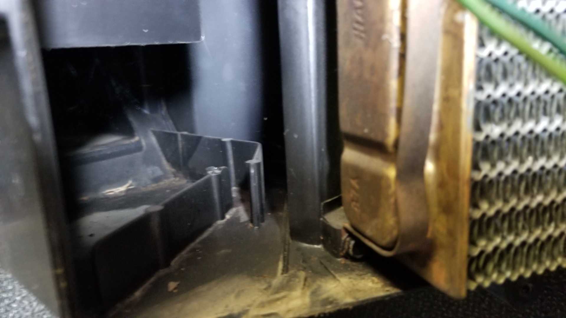

For weeks I’d been planning to take the access panel off and check the heater core for leaks, but today someone posted on the Fiero Facebook group about how easy it is to change, so I took the cue and checked. Has to be one of the easiest heater cores to access.
At first glance I thought mine was good, but then noticed evidence of small leaks.
The rest of the ducting looks good, just a little dusty.

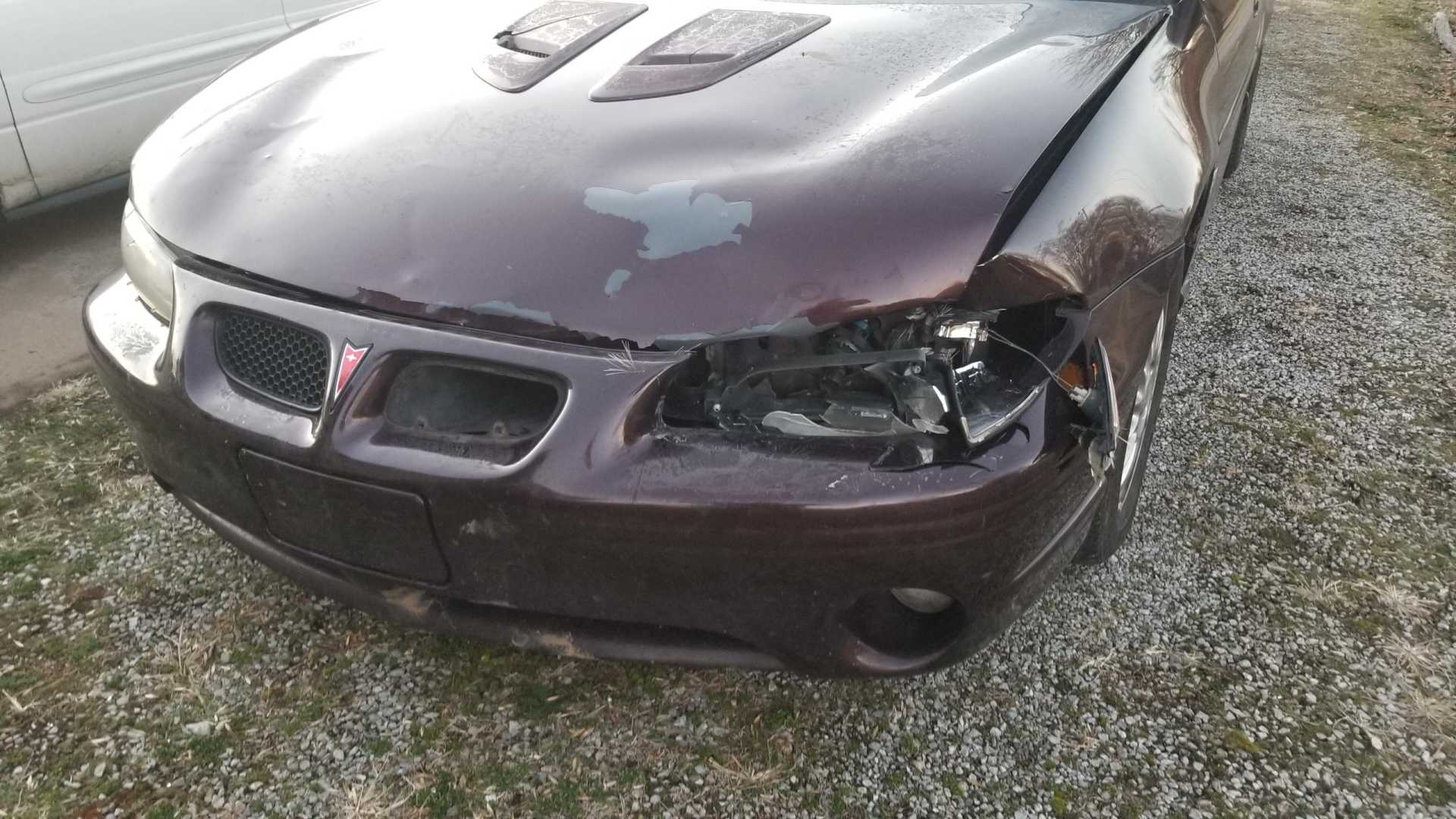

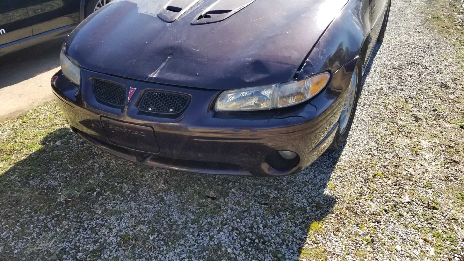

Thursday night my son hit a deer while driving the car. This is the third time deer have hit the car. I knew from my visit to the salvage earlier in the week there’s another 40th anniversary Grand Prix in the lot, so my son and I went and got the hood and the other parts we needed.
The replacement hood is banged up but still much better than the deer-damaged one.
This car has 225,000 miles on it and the body is just not worth saving, but we need it to be driveable for another six months or so. At that point I will remove the engine, trans, computer and harness for eventual use in another Fiero.

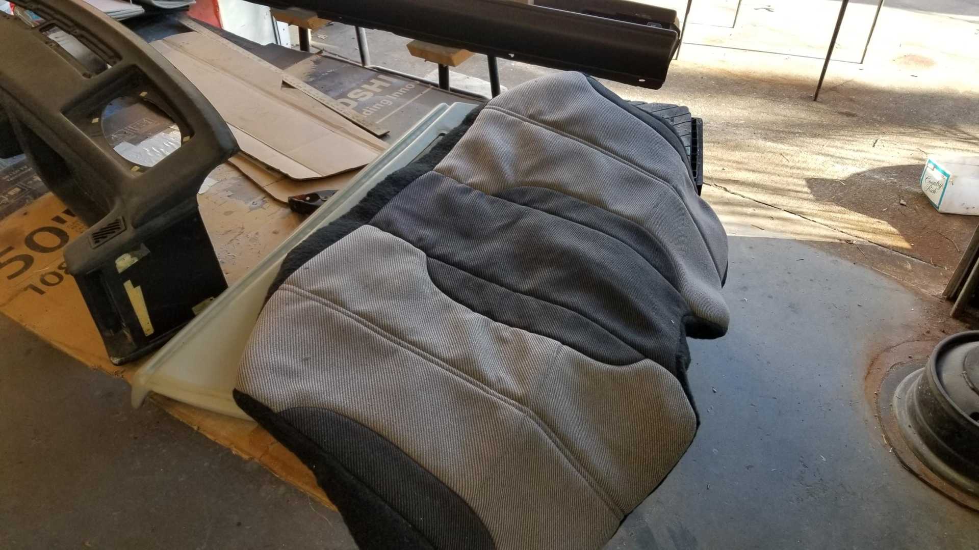

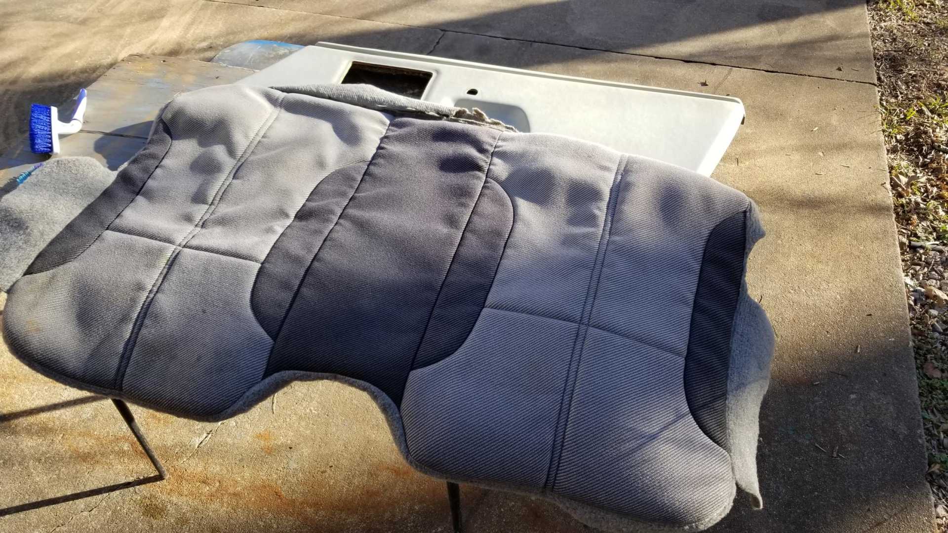

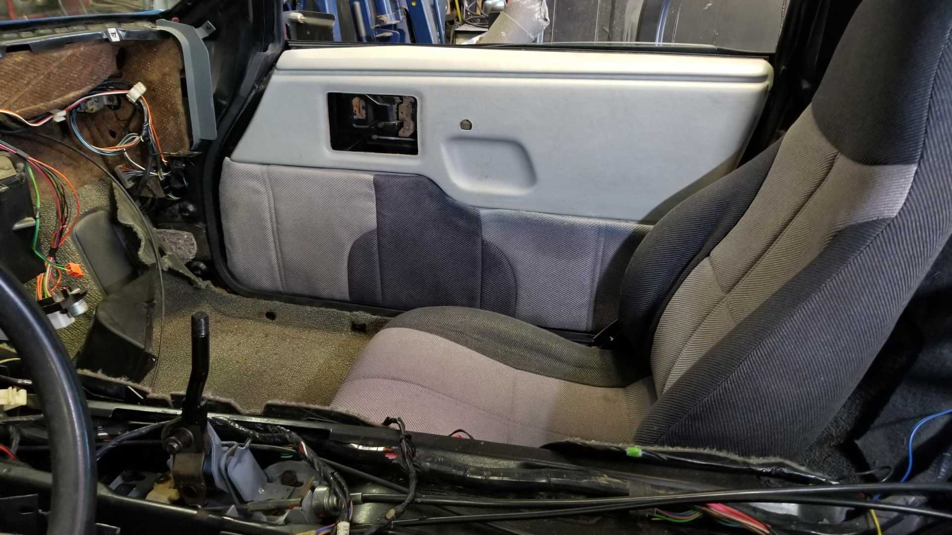

While at the salvage we also bought two rear seat covers from the 4th gen Camaros for a whopping $9.
One cover was in great shape, the other one not so much. It was faded and the carpet-like fabric that covers the back of the rear seat just crumbled. You might be able to tell that it was a bit faded, too.
I used the faded one for my first try, which was on the passenger door panel. I’ll keep looking for more 4th gen Camaros in the salvage with this kind of upholstery and grab another back seat cover, then re-do this door.
I like the look. I ran out of time in the shop, so I’ll try to do the other side this week. I’ll also try to take photos of the cutting and upholstery process. I think I’ll paint the vinyl parts of the panels a darker gray to get them to match the fabric.

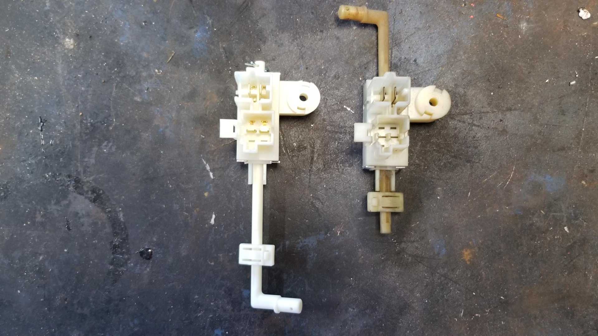

I did replace the clutch safety switch. Earlier in this thread I noted how the previous owner had put a jumper in the plug for the switch. The car has never run since I bought it, so I don’t know for sure but it’s a safe bet the switch was bad.
I figured replacing the switch while the dash was out would be much easier. A couple years ago I came across a thread on here that the Fiero switches aren’t available anymore so the poster used one from an ‘88 S10 Blazer.
http://www.fiero.nl/forum/Forum2/HTML/133653.html
I ordered the S10 switch from RockAuto and sure enough, the switches look almost identical.
The S10 switch has an extra pickup, but that doesn’t matter. The biggest difference is that the rods move in opposite directions. It’s simple to put the Fiero rod and adjustment clip into the S10 switch from the proper direction. I then mounted the switch and used the clip to adjust the travel while moving the pedal. Definitely easier to do while the dash is out of the car.
Note: the S10 adjustment clip will not work on the Fiero push rod. The teeth on the Fiero clip don’t fit the S10 rod, so just use both the Fiero rod and clip.
